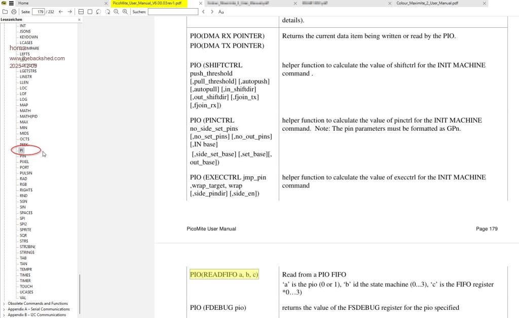

I have questions about the fifth option ‘completioninterrupt’
in the command: PIO dma tx
Could this be buggy? Because it disrupts the serial transmission when I want to use it. So the level then goes back to 0?
I actually wanted to know when the string had been sent so that I could send another one and not send the next one while the previous one was still being sent.
> option list
WebMite MMBasic RP2040 Edition V6.01.00RC21
OPTION SYSTEM SPI GP2,GP3,GP4
OPTION COLOURCODE ON
OPTION CPUSPEED (KHz) 200000
OPTION SDCARD GP5
AND
I can't get the command on page 200 of the manual to work. Where and when do I need to use this command?
This sub in parameter 4 is never called?
Similar for TX interrupt in which case MMBasic gets an interrupt when data is needed for the TX FIFO.

Posted: 11:19pm 08 Dec 2025
Apologies for the delay, but everyday life calls.
I found it, but I'm not sure if it's the latest manual.
Note: PI is faulty.
I'll test it.
Matthias
Posts: 3429
Posted: 11:26pm 08 Dec 2025
  Quote  Note: PI is faulty.
  Functions said  PI Returns the value of pi.
> ? PI
3.141592654
But PIO is simply missing from the index.
Edited 2025-12-09 09:31 by phil99
homa
Joined: 05/11/2021
Posts: 755
Posted: 08:39am 09 Dec 2025
I am familiar with PI; it was just to show that PIO is missing here.
