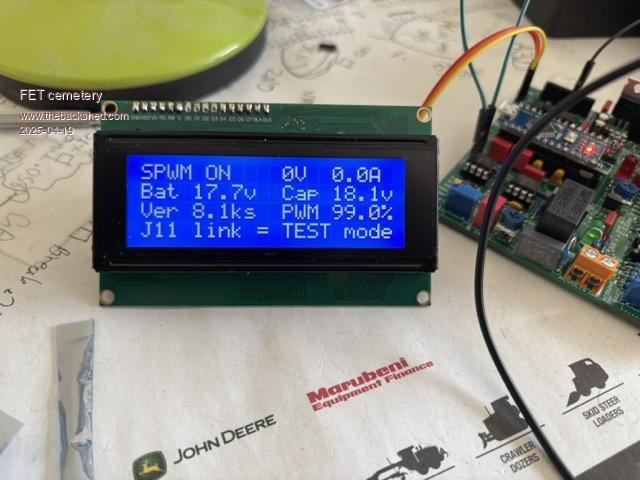

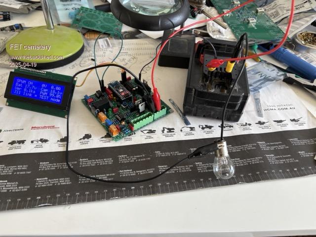

Posted: 04:11am 19 Apr 2025
I guess with a traction battery in "normal" use it's seeing all the ripple / noise from pwm motor drives etc but it's all in one direction, discharge. Then when it's charging it's all the other way with whatever ripple comes from the charger.
Off-grid doesn't have that clear distinction between charging and discharging.
Some progress, things are looking promising:
I have 2 boards completed to this stage and the power fet boards are well underway.

KeepIS
Joined: 13/10/2014
Posts: 2287
Posted: 06:02am 19 Apr 2025
The boards are really nice and usually work first go if you are not burning the candle at both ends when building them, which I have done on occasion. I've built a lot of early version boards as Wiseguy perfected his design and more features were added as the wish list grew with each revision, really nice layout now.
And they really look the part as well
FET cemetery
Joined: 17/04/2024
Posts: 77
Posted: 06:22am 19 Apr 2025
Agreed, this is probably the most complex electronic assembly I've done and it's gone together really well (I hope!).
The boards are really good for soldering even with my eyes, I just limit myself to a couple of hours a day.
A couple of things nearly caught me out:
Tantalum capacitors have a polarity, there's a little + sign that needs a magnifying glass to see and they're slightly asymmetrical.
I nearly mistook the K for the diode symbol with the zeners on the power board and they almost went in backwards.
Cross checking with the BOM and circuit diagram saved me in both cases but it was a near thing!
I also force myself to check device pinouts even where they're exactly what's specified.

KeepIS
Joined: 13/10/2014
Posts: 2287
Posted: 08:21am 19 Apr 2025
I do the same with every device, using a small auto detect device with colour LCD screen, shows pin out, device type and polarity, I also check every resistor and cap as my parts bins sometimes have things put back incorrectly, by me
I and a few others have had the same trouble with the zeners and mistaking the K on the PCB.
It's good to keep pointing this out as you have done, helps new builders to know what to look out for
