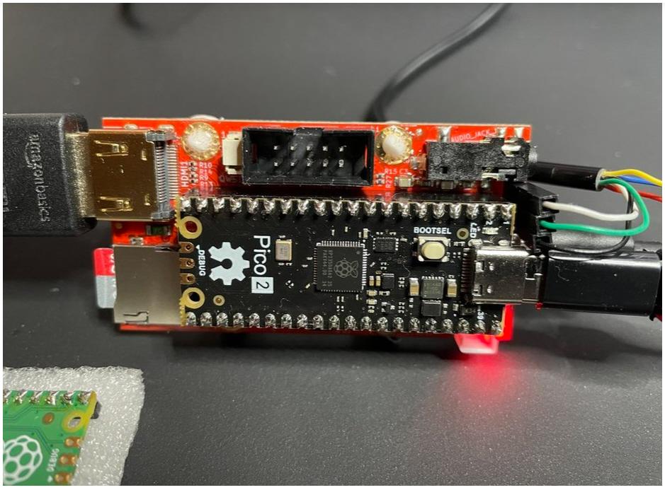

Yes stanleyella, it's the same board. The problem was that after flashing the PicoMiteHDMIUSB the serial signals on GP0,GP1 or GP8,GP9 were not set. This means that the only way to change this is to connect a USB keyboard to the Pico 2 and blindly type in the command OPTION RESET OLIMEXUSB (and not OPTION RESET OLIMEX) ;)
Thank you very much for your support

For Olimex module:
Load the PicoMiteHDMI MMBasic USB RP2350A Edition V6.00.02b11 firmware in the module. Place an external uart module on GP8=TX and GP9=RX. Note cross links connect RX->TX and TX->RX!
Then the firmware will prepare standard Option serial console COM2,GP8,GP9 and you can operate with an external uart. The other option settings are still wrong and if you want to go to an Olimex with SD and HDMI and AUDIO, then also to COM1:GP0,GP1 then you have to do OPTION RESET LIST with the uart to COM2:GP8,GP9.
> option reset list
HDMIUSB
OLIMEX USB
PICO COMPUTER
Now you do:
> option reset olimex usb (OLIMEX USB can be selected with the left mouse button and pasted from Tera Term)
Now serial console is COM1,GP0,GP1 with the pins from left to right (USB-power)(COM1:GND,RX=GP0,TX=GP1)(AUDIO plug) so order pins (COM2:TX=GP8,RX=GP9,GND) on the RP2350A print can be assembled with the same 3-pole plug only turn the plug a quarter turn for COM2-> COM1.
This is all quite complicated to go from COM2 -> COM1.
This is my experience. Or does anyone know an easy way or am I doing something wrong?
Greetings,
Jan

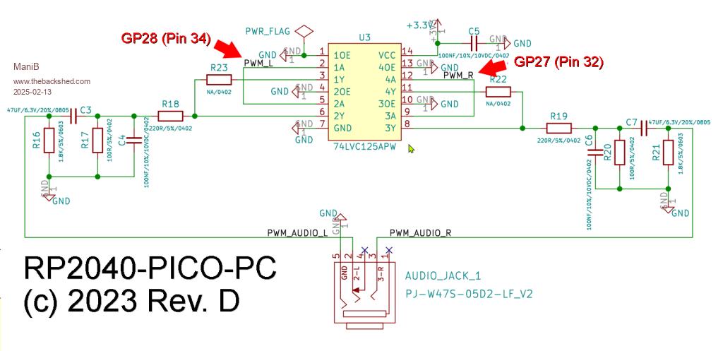

Note for audio to work properly you need to link GP28 to GP26. The pins they used for audio aren't on the same PWM slice.

  matherp said  Note for audio to work properly you need to link GP28 to GP26. The pins they used for audio aren't on the same PWM slice.
Hi matherp,
I checked the connections on my board with the Rev. D and couldn't find any interruptions in the connection of GP28 (PWM_L) and GP27 (PWM_R).
And GP26 (DVI_CEC) is connected to the HDMI1 connector.

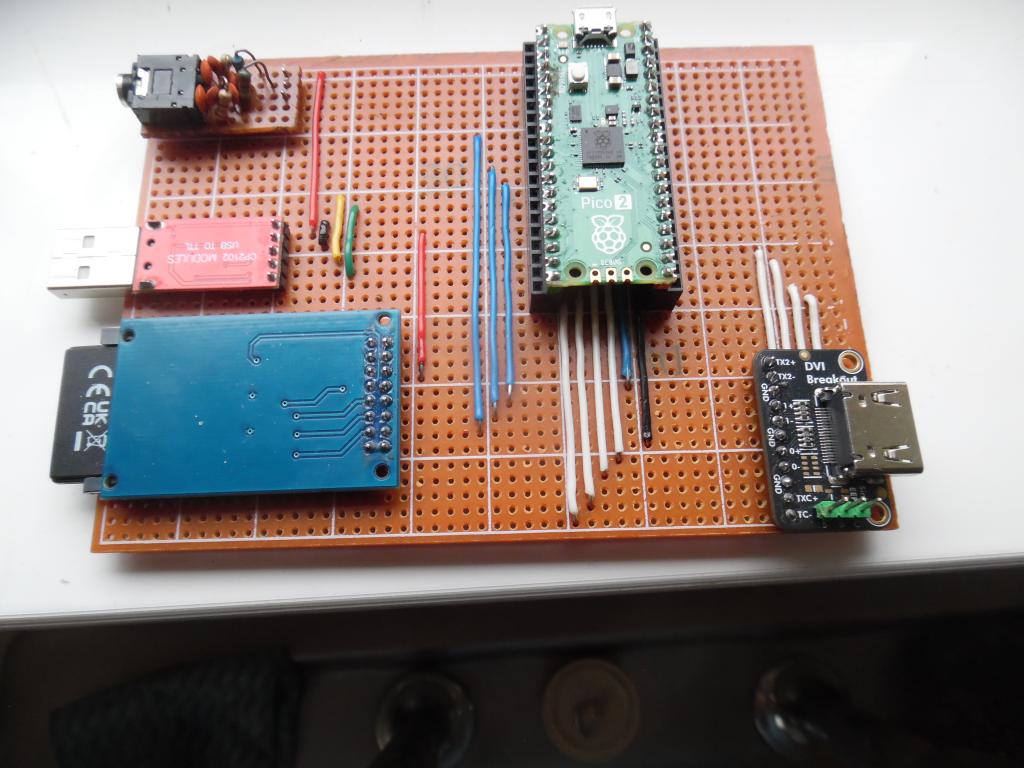

this is why I built a stripboard hdmi 2350 board.
Mick mentioned the audio first and link needed and adc not working same time.
pity, nice board otherwise.
the sound is sharp.. simple filter as shown in latest manual, simpler rc no inductor.
you got any ideas for the "sound prob" and using adc same time. I wanted to do real Lissajous from audio left/right to x/y display. oh well

@ ManiB
The audio problem is that the Olimex board is sending audio using GP27 and GP28. Goodness knows why! They are PWM5B and PWM6A. MMBasic needs both channels on the same PWM channel so the easiest fix is to simply link GP26 to GP28. GP26 is PWM5A so everything is happy, but you lose the use of GP28 and you can't use GP26 for anything else.
GP26 goes to CEC on the HDMI socket but that isn't supported by MMBasic so HDMI ignores it. It won't prevent the HDMI from working.

You have to disconnect GP26 from the HDMI connector. CEC will suffer when there is a PWM signal on it.
Posts: 9328
Posted: 10:35am 13 Feb 2025
It might if you are feeding a TV or video recorder that supports it. I don't think most computer monitors use it as it's only used for controlling multiple devices from one remote. It has nothing to do with the video data.

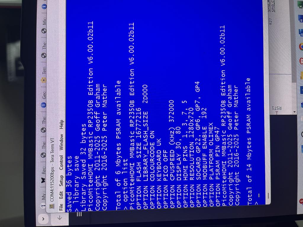

Posting on this thread as opposed to the ‘Beta’ one since I am currently using the OLIMEX RP-2040-Pico-PC carrier board (and a Pimoroni Plus 2 with b11 ; HDMI firmware).
The Plus 2 gives me a RP2350B so that I can test PS Ram stuff.
One observation - the number of ‘Mbytes PSRAM available’ varies between 6, 8 and 14 (with no changes being made; just re-booting). See photo below.
Is this as you’d expect?
FYI - I am trying to get a Pimoroni PGA breakout working so soldered up a USB to it and loaded HDMI b11. If resolution is 640 (and hence the default when firmware first loaded) then all seems ok (noting this is @ cpuspeed 315000).
However, changing to 1024 or 1280 causes very random behaviour -  sometimes resets things to default. Due to instability (and you ‘Eureka’ thread, I reverted to the Pimoroni Pico Plus 2 (as per the message above) and all seems stable.
HAVE YOU (or anyone out there) tried the Pimoroni PGA module with HDMI at the higher resolutions?

I agree. Where did I hear of this 2040 breakout board and bought one?
the sound filter is not nice to listen to but there is now a similar circuit in the manual.
I think it was Mick who explained first how carp it was.
Both you and Mick make boards that work proper so source one from you a better option than 3rd party vendors that don't support mmbasic.
I don't like waving a soldering iron round but built this "hacked" strip board that works. lots of people want a convenient ready made board, some use bread board.
You've said strip board has capacitance problems but I've not noticed any.
sourcing the inductors for the sound filter, no prob but have to unless use simpler circuit in new manual.
I hope more people use mmbasic but getting started needs hardware wiring.

  Quote  One observation - the number of ‘Mbytes PSRAM available’ varies between 6, 8 and 14 (with no changes being made; just re-booting). See photo below.
Should give 6Mb reliably - mine does (Pimoroni Plus 2). If you are getting anything else it means the PSRAM bus is not reliable. Check power supply noise etc.
No idea if anyone has got the PGA2350 running reliably at 372MHz. Everything is so marginal with these Pimoroni boards. When (if) chips become available I will be doing my own boards with the 80-pin chip.
