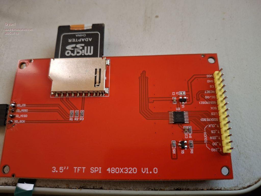

If all else fails try ILI9481, ILI9341, ST7789_320 etc.
It might be a newer IPS panel, so I would try ILI9488W in first instance
@Bryan: A picture of the display could help

Morning Guy's well over a caffine decided to try a few options so I tried different drivers and to my surprise the backlight worked with EVERY driver but the gui test lcdpanel failed on every one
Here is a pic of the back of the lcd
So my next job with this is to rip out all the wiring and start again just to see if that is the problem.

Ok that looks like a standard ILI9488 and has U1 fitted so Vcc should be 5V.
If you can wire it up like this, which I have working, hopefully there will be a different outcome.
Only System SPI & LCDPANEL drivers installed (no touch or SD)
Panel       Pico
VCC         VSYS (5V)
GND         GND
CS          GP13
RESET       GP14
DC/RS       GP15
SDI(MOSI)   GP19
SCK         GP18
LED         GP7
In your first test the SD card also didn't work suggesting the SPI wiring may be the culprit, provided the SD card was no more than 32GB as that is all the LittleFS in the Pico can handle.
If the panel still doesn't work the SPI bus can be checked with just the SD card.
Remove the LCDPANEL and driver and add the SDCARD driver

Well rewired it all up did a clear flash and put 6.03 back on and just did the lcdpanel option and noticed it didn't light up like before so did a gui test lcdpanel and got the bubbles   Went and did the gui calibrate and got thru it first time.
PicoMite MMBasic RP2040 Edition V6.00.03
OPTION COLOURCODE ON
OPTION CPUSPEED (KHz) 200000
OPTION LCDPANEL ILI9488, RLANDSCAPE,GP15,GP14,GP13,GP7
OPTION TOUCH GP12,GP11
GUI CALIBRATE 0, 240, 204, 1251, 858
OPTION SDCARD GP22
So got the lcd and touch working and I replaced the 32gig sdcard with a 2 gig but still no sign of the sdcard working

Good to hear the LCD is working!
The SD card is drive B:
Type B:<enter> at the prompt to change drives then "files"
A 32GB card should be ok but that is the maximum.
Edited 2025-07-14 13:12 by phil99
