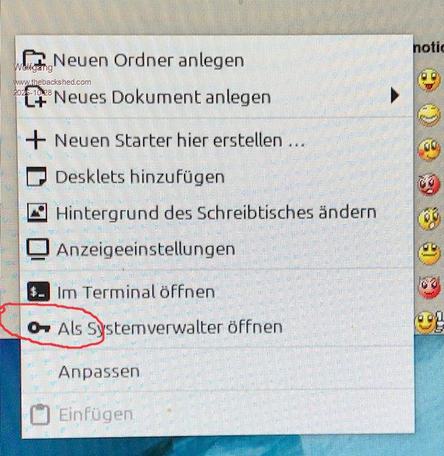

Due to my attempts to start MMedit without WINE, I have locked myself out of Linux Mint. I can no longer activate Timeshift or activate Users and Groups.
When I request root privileges, the terminal tells me that I do not have root privileges.
Even powering off and restarting does not give me access to Timeshift, on whose hard drive I had previously stored backups.
Do I have to completely reinstall my Linux Mint?
Can you help?
Posts: 9039
Posted: 04:29pm 27 Oct 2025
How are you asking for root? There are various ways to use sudo.
See if
man sudo
brings up anything useful.

dddns
Joined: 20/09/2024
Posts: 909
Posted: 06:23pm 27 Oct 2025
The root account is "disabled" by default in modern distributions.
You setup the machine with your username and this is the first username which will be in the group "sudoers". AFAIK "sudo" means "superuser do" and superuser is the root account.
If a second user is setup on your machine, then you the administrator need to add the second useraccount to the group "sudoers" in order to allow system near changes like installing a program or using the serial port..
The root account itself is normally never used. I think it's common opinion in the community to give root a password because of security reasons. But not for usage in first sight. It can be important in case something "happens" to your useraccount like you cannot login anymore.
So your password is needed when the system asks you for "Administrator password"

Posted: 06:49pm 27 Oct 2025
@dddns
After Power up the system asked me every time before for the admin-Password. But now the system is in a mode trapped, where it don't ask me for the Admin-password after Power up. I can work with Linux as usual and any limits, except I want to use Timeshift or "Users and Groups".
At the moment I don't know what to do. All the advices of the AI's didn't help .
Wolfgang
Posts: 4366
Posted: 08:20pm 27 Oct 2025
See if sudo works.
You can probably do
sudo bash
and have a root shell.  Beware! It's a root shell so you can cause massive damage (to the software and/or your data) if you're careless.
If the above doesn't work e.g. because you're in a user without sudoers group, you can try
su - otheruser
(note the spaces)
where otheruser can use sudo.
You'll be asked for that user's password.
