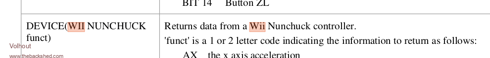

Posted: 08:06am 12 Jan 2026
@Geoff,
For the user manual of 6.01.00, but also for 6.02.00.
The function should be DEVICE(NUNCHUCK funct). The text WII should be removed.
