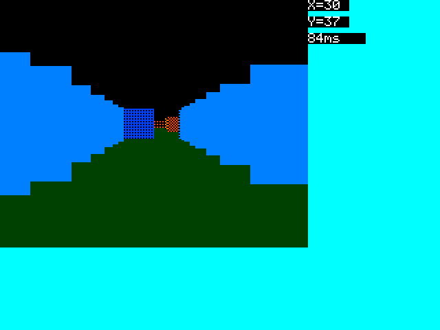

another millisecond/Frame saved @252000
Replace
 mx = Int(px) : my = Int(py)
 If Not rayDx  Then dDx = 1000 Else dDx = Abs(1 / rayDx)
 If Not rayDy  Then dDy = 1000 Else dDy = Abs( 1 / rayDy)
with
   dDx = 1000*Not rayDx + Abs(1 / (rayDx+.01))*(rayDx<>0)
   dDy = 1000*Not rayDy + Abs(1 / (rayDy+.01))*(rayDy<>0)
The additional  +.01 serves only to prevent division by zero.
Unfortunately, converting IF queries into mathematical functions only works in simple forms:
i.e. IF a=0 then doit=1 else doit=5
becomes something like
doit=not a +5*(a<>0)
Replacing Queries with multiple THEN conditions do sadly not save time, rather the opposite.
One important thing is to remove ‘expensive’ calculations and queries out of the loop for image calculation. As these are used several hundred times per frame. In contrast, the keyboard/gamepad query is only called once per frame. Of course, this can also be optimised, but it will do virtually nothing to improve the speed.
Edited 2026-02-26 01:03 by Martin H.

Hello Bill,
Thank you for your efforts.  I will try to take your suggestions into account and test them.
I don't quite understand the changes in your published file.
None of the suggested changes have been incorporated into the file you published.To me, that looks like the code I posted on 23 February 2026. Did you perhaps zip the wrong file?
As mentioned above,
slower than
Replacing IF THEN ELSE with a logical formula whenever possible works faster in most cases.
I will look at the rest of the suggestions and try to implement them.
In my opinion, filling the  floor/ceiling  only when rotating is only correct if you are moving forwards; if you are moving backwards, the background must also be completely redrawn. Here, checking the possibilities would take more time than the 2 BOX commands at the beginning of the frame.

  Turbo46 said   I'm trying to do too many things at the one time.
Haha, I know exactly what you're talking about
Thank you, but the result is, let's say, semi-good
This has more of a Minecraft feel to it than a Raicast. I'll will take a look at the code. I just had a discussion with MS-COPILOT about improving my DDA routine, he had a lot of suggestions, none of which really speeded things up, quite the opposite. (later, he then saw that too)
That's why the AI ​​suggestions aren't always real improvements; for example, Copilot keeps forgetting that it's about interpreted basic and that TRUE=1 in MMBASIC
Martin

' Raycaster 2 in MMBasic, DDA method (Digital Differential Analyser)
'V0.87.. added Lookuptables,changed to Blit vs Box,compressed math
'added possible dithering,compressed math more, changed map to 1D Array
'By Martin H. for https://www.thebackshed.com
'The software is subject to the terms of the GNU General Public Licence (GPL)
'and may be freely used, copied and updated.
'Individuals are encouraged to freely use and modify the software.
'Start
Dim integer dither%=1,mmb4w
'add CMM2 here
If MM.DEVICE$ = "MMBasic for Windows" Then MMB4W = 1
CLS
If mmb4w Then
  MODE -7 :CLS RGB(cyan)
PAGE WRITE 1
Else
  MODE 2: CLS RGB(cyan)
  FRAMEBUFFER create:FRAMEBUFFER write f
End If
CLS

accelerated once again by ~5 ms.
'no comment

Hello Martin,
with the ILI9341 standard driver I get timer values between 40 and 60.
With the buffered driver it seems to be even faster, but I can't see the numbers.
In both cases the "Mode 2" needs to be removed, but with the buffered driver
Blit framebuffer F,N,0,0,0,0,scrW,scrH
doesn't work.
I replaced it with
framebuffer copy f,n
what does not give a complete correct screen, but the maze is fine and super fast. Maybe one for @matherp

Thanks for the feedback. I'm now nearing the end of my development and optimisation process. As far as I remember, we managed to get F to N Blitting working on LCD with Petscii robots..
What I'd still like to insert, before the version jump to 1.0 is the rhythmic swaying (‘view bobbing’) when running, as seen in Doom.
But not today ;-)

Another data point for you, I have tried out your latest DDA program from above on 480x320 LCD ST7796S, 2350 running at 420MHz.
All I had to do was remove the Mode 2, everything then just worked, full screen.
At this resolution I'm getting around 60 to 76mS per frame, If I limit the screen size to 320x240 (using Poke Display Hres 320 & Poke Display Vres 240) I'm seeing an update rate of about 30 to 45mS per frame. Not Bad! :-)
If I limit the CPU to 252MHz I get around 90 to 130mS and 50 to 75mS respectivly.
Regards Kevin.

With the legacy ILI9341 driver it works for me as well, but not with the buffered.This is on USB RP2350B Edition V6.02.01b6

If you go back to the original code, just removing the Mode 2, then modify the main Blit
Blit framebuffer f,n,0,0,0,0,scrW,scrH
to
Blit framebuffer f,n,0,200,0,0,scrW,scrH
You can see some detail in the single line, so it looks like the blit is only copying a single line, not the whole height of the frame, ie scrH.
Regards, Kevin.

If I replace with
the maze is correct
