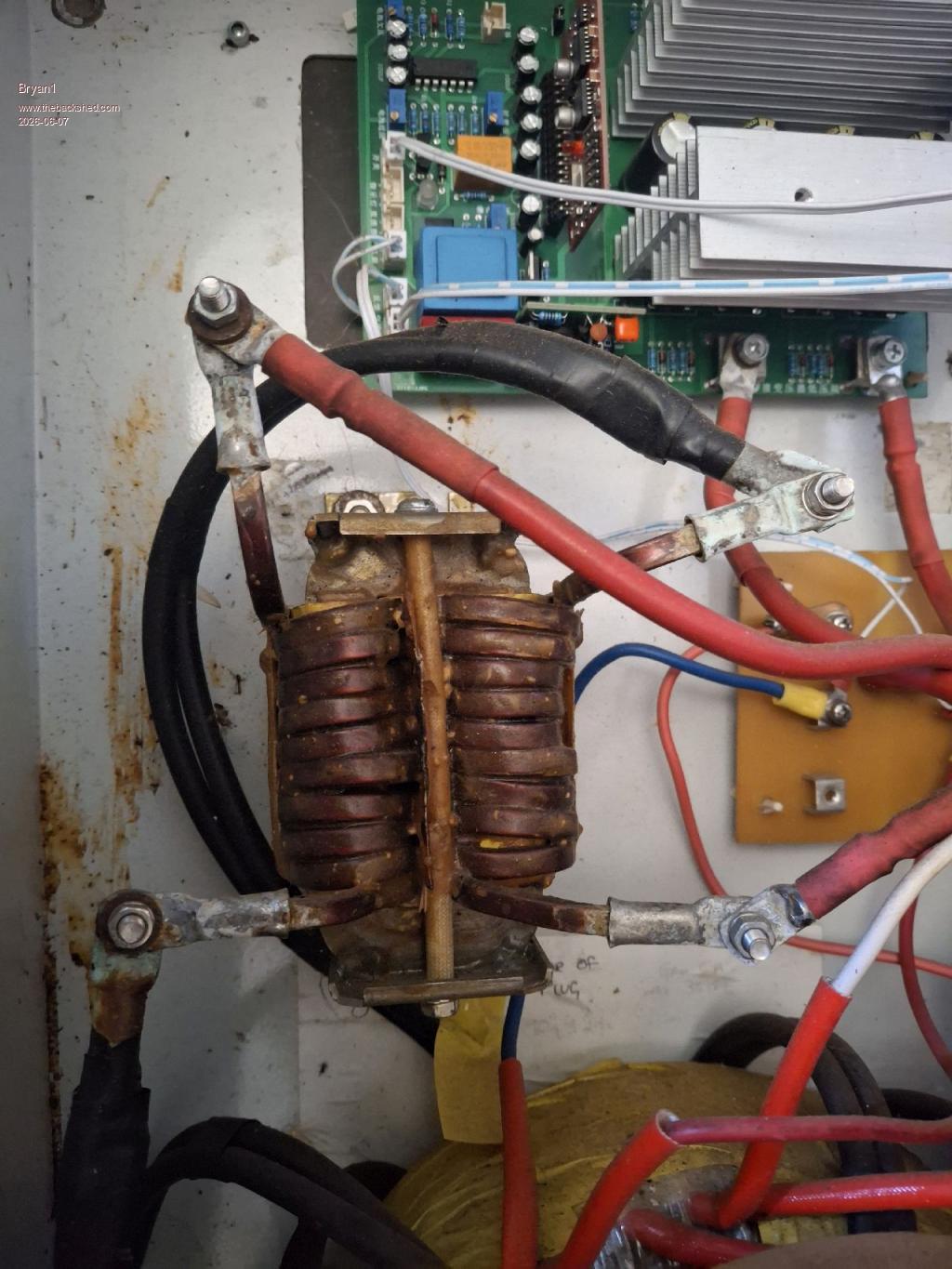

Bryan1
Joined: 22/02/2006
Posts: 2297
Posted: 01:08am 07 Jun 2026
Now we are on the topic of making a Induction Tester it would be nice if we can set it up for dual chokes like this one I made back in the day.
This design is Tony's where 10 turns on each side of the big dual choke on the Aerosharp. I did set it up with my first Ali inverter board and it ran fine powering 2 vacuums so that choke does work and it would be interesting to see at what current it saturates.
Regards Bryan
Posts: 3416
Posted: 01:23am 07 Jun 2026
With the choke removed from circuit, join the transformer ends together then connect the inverter ends to the tester.
