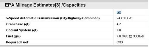

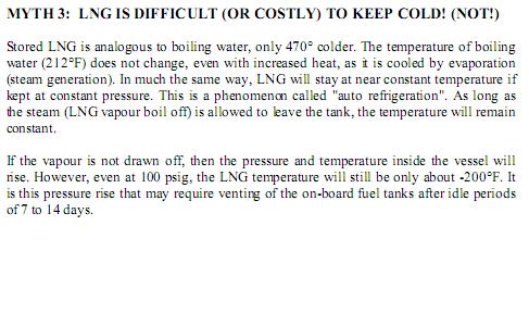

Posted: 05:32pm 01 Jun 2010
Propane, Is not the same as NG. its Vapor pressure at 100 D. F. is 175 psi. Its pressure is 0 at -44F. In the polar regions the tank must be kept near the fire to boil the liquid to sustain the flow of Gas.
My choice would be a Hybrid Constant speed engine charging into a battery pack and powered by compressed N Gas.
EDIT; Pete,
The 3000 Psi came from a mixture of info for LNG and CNG. The Honda Civic GX uses Compressed N Gas and the tanks are crammed full to get reasonable range, the Honda gx has equivalent of 7.8 gallons gasoline at 3600 psi compressed N Gas. about 280 Highway Miles.
Other Mfr's have Sold N Gas vehicles Using High pressure Tanks.
From Honda spec. page.
Edited by Greenbelt 2010-06-03

Posted: 10:18pm 01 Jun 2010
Hi Greenbelt
It would require a well insulated tank here in Australia as I have seen temp in the west of Queensland at sixty degrees in the midday sun. Would need underground insulated tanks to stay liquid with venting and all, but in practice if it was running a power station the boil off would keep it cool.
I think it is suited more for power generation than mobile applications.
As Pete says the propane or butane fraction is a better proposition there.
