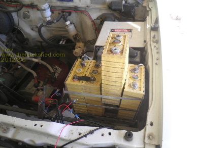

Posted: 10:08am 11 Feb 2012
Tinker, not practical end to end. Besides, they are already, as well.
Grub, that would increase the heat dissipation. My biggest problem in the main pack is they are inside a sealed insulated fibreglass box. The heat can't get out. My next set of batteries I intend to make alloy checker plate boxes, with air gaps, still sealed, but heat can dissipate throught the alloy.
Generally they don't need anything between them. You can see the ribs in the side of the cells, the ribs keep the cells apart a little and so heat rises up the holes.

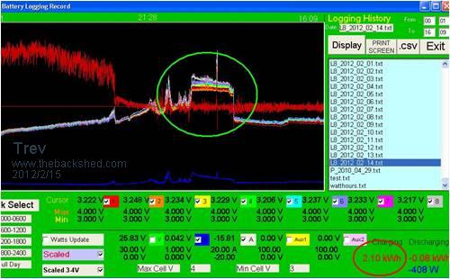

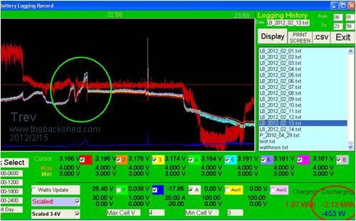

Gordon sent me an update on Relativities Active Balancing testing.
Quite some time ago I sent 8 cells x 90ah to Gordon to connect up to his 24v wind & solar system for the purpose of testing the Relativities. In a recent post I said, must be near 3 years now. Gordon assures me it is just over 2yrs, like 2 yrs and 3 months.
Gordon says
Here are some pics, of the drawdown curves, and the recharging curves. We used over 2kWh from the battery. Check out the kWh discharge, 2.13kWh, and the kWh used to recharge, 2.10kWh. These are circled in red. Pretty close to the same energy. A tribute to the performance of the Lithium chemistry. The dark red trace is battery current. Charging above centre, and discharging below, with a +/- 20A scaling. The green circles show the normal absorption time, as well as in the second pic, the battery was equalized. This is a fully automated system, with no user intervention.
The cells do separate slightly in voltage at the extreme voltages, but the equalizers can be seen to be bringing the differences down. This is the blue trace. It had been about a month since the last equalization had occurred. The multi coloured traces are the superimposed individual cell voltages. The recordings are at 10sec intervals. The normal scaling is 3-4V, that is 3v at the bottom and 4v at the top of the black window. This is a narrow range, so the working voltage range of the battery is from about 3.45 to 3.2 cell Volts, and the battery is considered charged at a cell volts of 3.65. The centre of the screen is 3.5V, or equivalent to 28V on the battery. As you know, this 8cell Lithium pack is in parallel with my 24Vnom lead acid battery.

By the look of the results the equalization is working well and maybe the
batteries are more suited to this style of use, as I have a number of people tell me that the string of cells to get high voltage for care use kills the odd cell,

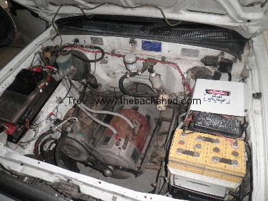

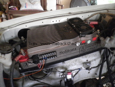

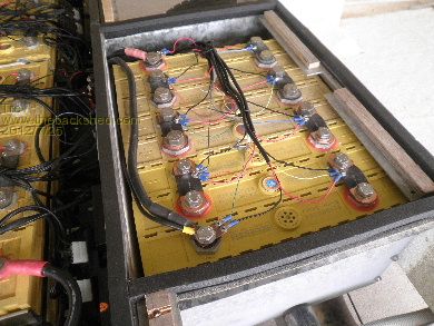

About a month ago I fitted a Soliton 1 speed controller to the EV Hilux. Fiday, tidied up the wiring.
Very easy to program with a standard ethernet cable to computer conneted to the web interface. I have it set at 600A max, standard factory acelleration and motor max votage at 150v.
This controller is very nice. Smooth and very controlled. Hilux acceleration is a bit quicker. The Soliton controller is better efficiency too. Generally I use around 14.5kwh to do my normal 75km round trip each day. With the Curtis I used around 17kwh. Controller heat is no longer an issue. It delivers power much better than the Curtis.
The engine bay looks even more empty now.

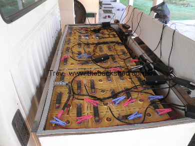

Posted: 09:27am 26 Feb 2012

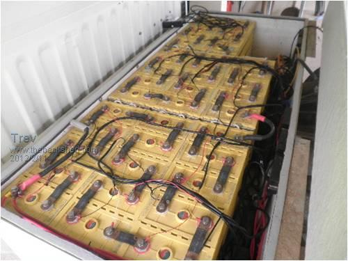

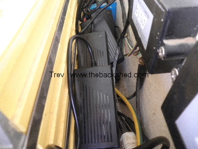

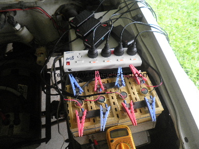

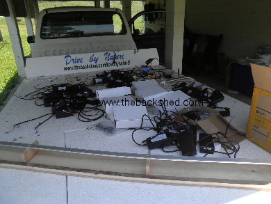

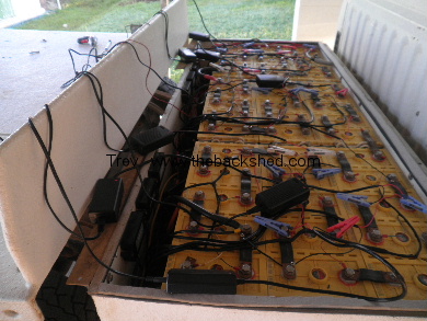

The 3.7v chargers have been taken out, a while ago.
The 14.8v chargers have been fitted, waiting for the Relativities Active Balancing circuits. Yes, we are going to test again in the EV Hilux! It has been a long time! Am I excited? Should be here soon. I did not bother trying to mount the 14.8v chargers, they are just in the battery box.
The idea is that the 14.8v chargers can assist in providing a better spread of power without the huge number of chargers used in single cell charging. It is at the end of charge that the biggest difference in cell voltage occurs, and that's where these 14.8v chargers will work. Only needed in the long series string of an EV. Not needed in a solar/wind RE system using a smaller number of cells in a series string.

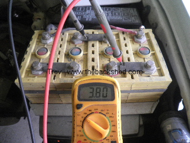

Last weekend I had to manual balance the main pack again. I used several 3.7v chargers and a 12v auto light. Much quicker manual balancing than I have done in previous times. Though much longer time than when I had a 3.7v charger on every cell and every morning they were switched on.
The 12v block voltages were getting further apart. Peak difference this morning was 3.80v to 3.33v. I connected 4 of the 3.7v chargers to balance them. As said before, these cells (12v block cells) have not been balanced since I had the very first Relativities prototype on them. After a few hours the peak difference was 3.71v to 3.73v. Very Good. They will be right for a long time again.
Edited by Trev 2012-02-27

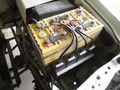

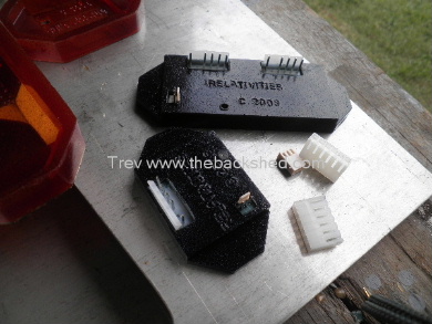

Posted: 11:13am 27 Mar 2012

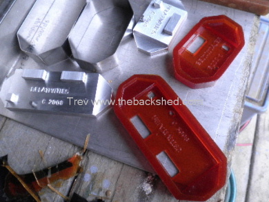

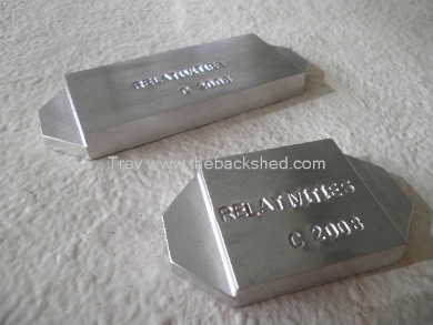

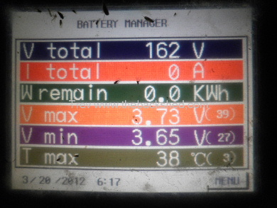

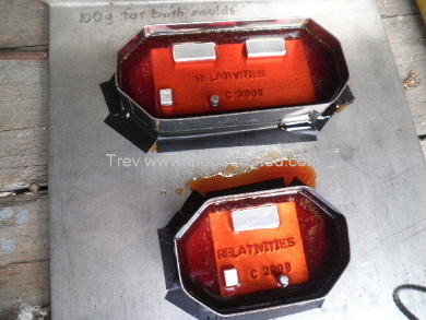

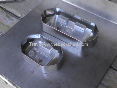

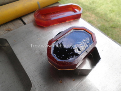

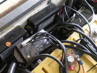

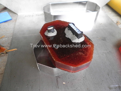

The new version of Relativities arrived. I made new moulds to pot them for protection. With plugs, all the wiring can be done without risk of damaging the Relativities. A wiring test circuit was also provided, so all wiring can be tested to make sure it is connected correctly before connecting Relativivites. A brilliant setup. They are also now made in 8 cell units (balancing 8 cells), as well as the 4 cell units (balancing 4 cells).
I have 5 x 8 cell Relativities and 1 x 4 cell Relativities. They are connected across 44 cells, not overlapped. I am using the 14.8v chargers to break up and distribute the charge across the pack and then Relativities active balance all the time in a smaller area.
It is great to see a cell difference of only 0.08v each morning. Relativities and the 14.8v chargers are working well.
Except I have a couple of cells that have a higher self discharge than the rest of the pack and so I have the single cell (3.7v chargers) setup in that area of the pack. One of those 2 cells, only started about a week ago, became obvious when lower than the rest. I have 3 x 3.7v chargers connected to it and so it gets 12A help every morning.
With a new pack, or a pack well looked after, Relativities may work by themselves without the small chargers, but not this pack I have now.
Relativities has been connected for a few weeks now. All working good. They are over the back of the battery pack. There was not quite enough room above the batteries. The plug adds a little more height to the units. An example picture of the monitor screen shows just 0.08v difference between the highest and lowest cell. This is how it is every morning.

Trev
Joined: 15/07/2006
Posts: 676
Posted: 07:25am 28 Mar 2012
Klaus,
9 wires to balance 8 cells and 5 wires to balance 4 cells. Each Relativities has one negative wire for the whole block and one positive wire for each cell in the block.
No heat (no burnoff). It transfers power from a high volt cell to a low volt cell.
Still in testing, although we are considering a small production run.

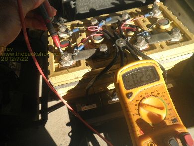

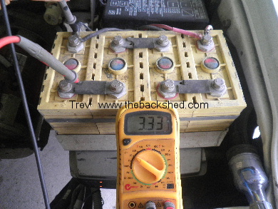

I have drained the 12v block too low, too many times, and one cell developed a higher self discharge than the others. I removed the C-Tek charger and fitted 4 single cell chargers. But the 4 single cell chargers (4A) were not able to replace the normal daily power usage when switched on over night (off peak). But I thought it was ok, and just play catch up on the weekends. Obviously not.
One morning not so long ago, I found that the single cell charger did not switch on, possibly because the cell voltage was too low. Well that doesn't help a cell that is already too low. It still had to supply power to the main monitoring screen, while the main pack was being charged at the same time (off peak overnight).
I found it had been reversed. Dead. I tried to charge it but it would not take a charge.
So I replaced it with a LYP. The original 4 are LFP. I will leave it with single cell charging, so the 2 chemistries don't muck me up if I were to charge with the C-Tek.
Dad cut the dead one open. Nothing run out, but it was moist with something inside. A clear like fluid. The plates were just copper and aluminium foil alternating with some kind of insulation between them.

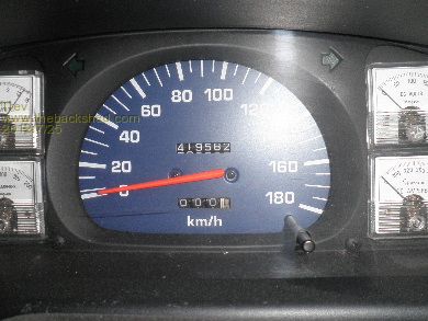

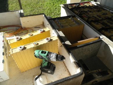

Posted: 01:09am 25 Jul 2012

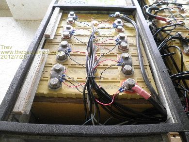

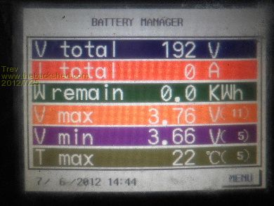

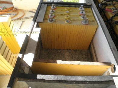

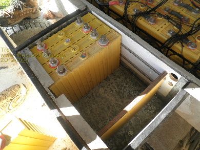

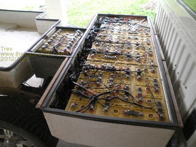

I have wanted to add more cells to my main pack for a while. In fact my camper set was originally bought to be in the main pack, plus one more, making it to 50 cells.
With the pack getting to the point were range was borderline reaching 80km, I have now made the effort to add the extra cells.
With current situation and thinking decided to use these 5 plus 3 more, making it up to 52 cells now in the pack. These 8 new ones are LYP and the old ones are LFP chemistry. The Zivan chargers have the output voltage adjusted to suit the new pack voltage. For balancing, I did not have any more Relativities, so single cell (3.7v) chargers are used. All small chargers are switched on by the end of the Zivan charge. These 8 new cells are also monitored on the same monitoring screen as the others. Performance and range has been increased.
Relativities testing has proved reliable. They are still working.
So far have driven on these batteries, 419582 - fitted with speedo reading 350153 = 69429km.
That makes it $16200 / 69429 = $0.23 cents per km.
There is still more power in them yet.

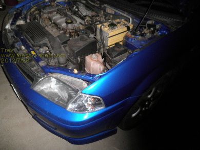

Sideline note (not EV).

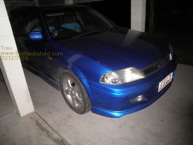

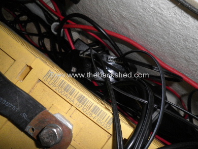

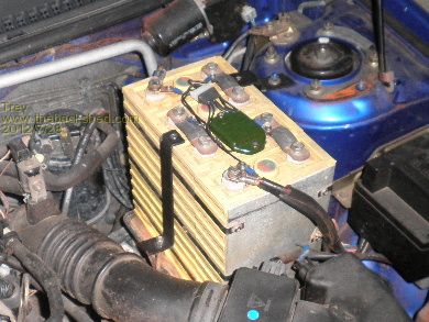

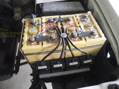

Tested an old version of Relativities on a 12v 90ah lithium block used as a standard vehicle starter battery. This battery block was the one I used in the mower as a starter. It has been over charged, I discovered the mower does not have regulation. If I remember right the pack was charge to 18v?? It swelled a bit but still works well.
Measured the instant jump of current on start up to be 250A.
Both, lithium battery and Relativities are working well.
Our Ford Laser is our long range vehicle.
I can't remember exactly when fitted to the Laser, must 3 to 4 months ago.
Trev @ drivebynature.com

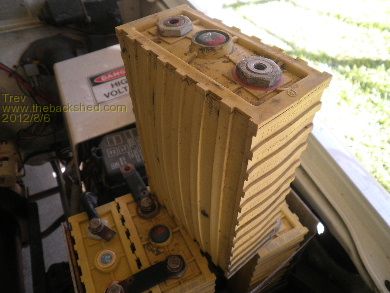

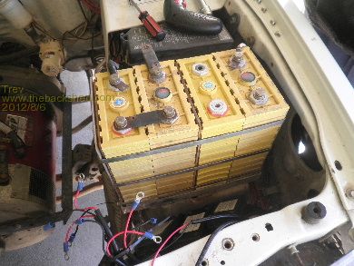

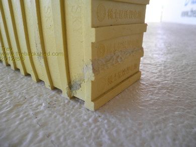

Posted: 01:06am 06 Aug 2012
Last week went camping with a bunch of year eight students. Too much fun and very little sleep.
Home on Friday, went to bed early, very tired and forgot to plug in. Next morning discovered the 12v battery had drained its last and one cell with voltage reversed. They don't like being drained empty! I tried to charge it. To start with seemed to take a charge but would not go passed 1.15v. Removed chargers and immediately dropped back to below zero.
So removed it. It was hard to get out with the ends still fixed in the mounting frame. Very much swelled, even the top and edges.
I decided to put in a cell that was damaged in transport (split). It apparently had leaked out a bit of fluid? Dad used a soldering iron to melt over the crack. Charged it several weeks ago and was still holding charge. Fitted, charged and tested capacity on discharge. I figure it has about 50ah. Originally a 90ah cell. Should do me for a while. I don't normally use that much. It will be interesting to see if it can last.
