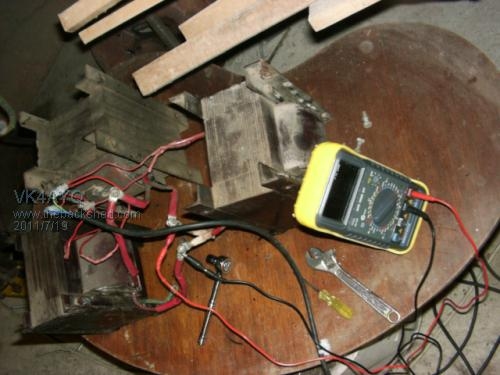

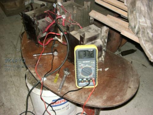

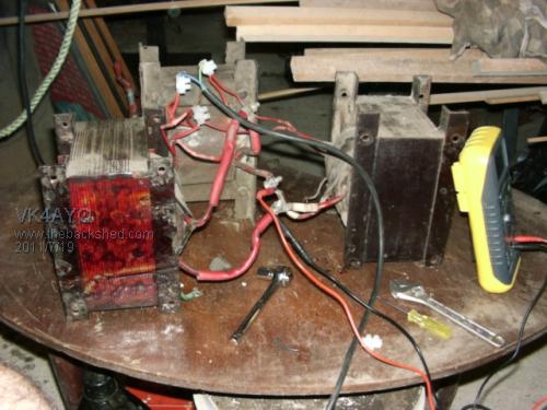

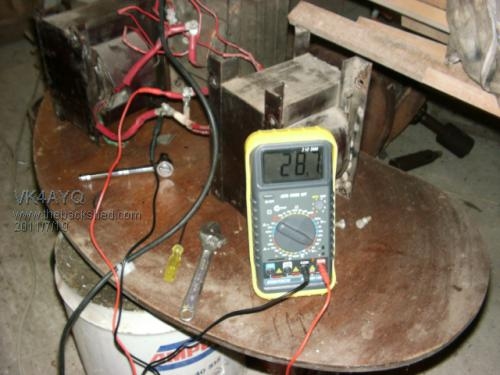

Posted: 07:19am 19 Jul 2011
Hi All
I did some preliminary testing today on a transformer coupled set up, still in the lathe as before and with 30 meters of 1.6 mm power flex lead.
RPM---- delta AC---delta dc - AC star ---DC star
40 ---- 1.0 ------ 1.45 ----- 1.70 ----- 2.5
52 ---- 2.2 ------ 3.20 ----- 2.80 ----- 4.0
67 ---- 3.2 ------ 4.60 ----- 4.06 ----- 5.8
88 ---- 4.5 ------ 6.50 ----- 5.70 ----- 8.3
113 --- 6.0 ------ 8.70 ----- 7.60 ----- 11.0
147 --- 7.8 ------ 11.3 ----- 9.90 ----- 14.3
190 --- 10.3 ----- 14.9 ----- 13.0 ----- 18.8
247 --- 13.4 ----- 19.4 ----- 17.0 ----- 24.6
320 --- 17.2 ----- 24.9 ----- 22.2 ----- 32.2
415 --- 22.3 ----- 32.3 ----- 28.3 ----- 41.5
540 --- 29.0 ----- 42.0 ----- 36.9 ----- 53.5
700 --- 37.0 ----- 53.5 ----- 47.0 ----- 68.0
The above figures are running without load I will hook it up to the batteries tomorrow if time allows and do some load volts and amps testing into the actual batteries.
All the best
Bob

Posted: 06:42am 20 Jul 2011
Hi All
A bit more testing with the alternator connected to the batteries, first run was with secondary of the transformers connected in Delta.
Delta
RPM 247 amps 0 0 watts
Rpm 320 amps 2 60 watts
Rpm 415 amps 7 210 watts
RPM 540 AMPS 23 690 watts
Rpm 700 amps 45 1350 watts This is to fast to be a realistic in use measurement
Second run with secondaries connected in star.
Star
Rpm 190 amps 0 0 watts
Rpm 247 amps 5 150 watts
Rpm 320 amps 15 450 watts
Rpm 415 amps 22 660 watts
Rpm 540 amps 27 810 watts
Rpm 700 amps 32 960 watts This is to fast to be a realistic in use measurement
DC volts was 30 volts at the three phase rectifier battery voltage went to 28.5 under testing voltage drop was in the 15 meters of 6mm cable to the battery bank.
Due to the excess power available in the blades from 170 RPM with a wind speed of 4 MS I will be trying the boost modules to pick up that power before main rectifier cut in. in delta configuration this amounts to 700 odd watts available, and around 300 watts in star configuration.
Looking at this extra power situation I will try 3 boost modules one on each phase for a total of 400 watts before cut in of main rectifier. This should allow cut in at 147 rpm in delta and 113 rpm in star. this would coincide with 4 to 4.5 MS.
All the best
Bob
