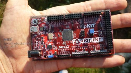

Then it is possible to be a difference between the stock bootloader Ken burned again on his Max32 and your stock bootloader? Edited by vasi 2011-08-27

Posts: 47
Posted: 02:13am 26 Aug 2011
Thanks for your suggestion.
I just got the Max32 yesterday, from MicroChip. I paid lots extra to get it shipped here via FedEx and pay customs duty on it. I don't know if there are different bootloaders or not. Based on your suggestion, I'll see if I can figure out what I have.
Then I had a thought, and tried loading a different avr hex file, using avrdude. It worked OK. It flashes the pin 13 LED. I had previously tested the Max32 using the IDE.

I was able to install StickOS on the Max32, using the current avrdude.conf, with no problems at all.
avrdude -C avrdude.conf -c stk500v2 -p pic32 -P COM13 -U flash:w:StickOS.max32.v1.84c.elf.hex
StickOS for Microchip PIC32MX7-F512L chipKIT Max32 v1.84c (www.cpustick.com)

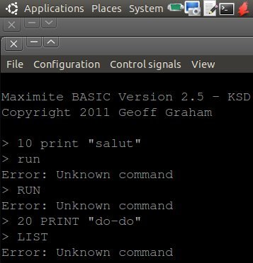

ArtBecker
Joined: 25/08/2011
Location: Philippines
Posts: 47
Posted: 08:21am 30 Aug 2011
I loaded the chipKIT Max32 MPIDE software on my linux computer, running Ubuntu 10.10, and tried installing the Maximite-2.5-ksd-ChipKit-Max32.hex file.

Hi,
My board must arrive in a day or two, then I will be able to find a solution. First, compiling the Gerard's version (which will require making a minimal shield) using an .ld file for Chipkit, then, to see if I can manage to modify it for mass storage (and that means another shield). Of course, Ken's sources will be of some help.
No promises but it is also my interest.
Vasi
P.S. All of this starting from the premise that you have the original, untouched stock bootloader and Ken a re-burned one. If my board is working with Ken's firmware from start then you will have to return your board.Edited by vasi 2011-08-31

Hi Ken.
I can confirm, avrdude is crashing on both Windows Vista and Linux Ubuntu 10.10 .
I have a warning from the linker:
[code] C:\Apps\Microchip\C32\bin\..\lib\gcc\pic32mx\3.4.4\..\..\..\ ..\pic32mx\bin\ld.exe: warning: cannot find entry symbol _reset; defaulting to 9d001000[/code]
The entry is missing from the .ld file provided with Chipkit Max32. Is that a reason to worry, the default address is ok?
Man, I have a lot to learn about this board.

I was able to install the hex file OK, using windows, but afterwards I can't connect with the Max32, using PuTTY or TeraTerm, via the USB/serial connection. Is this due to incompatibilities with the Max32 bootloader and the bootloader from MM Basic v2.1? Or am I just missing the point?
In normal operation, when the Max32 board is connected to the USB port, the green LED flashes fast for 4 seconds (bootloader), then blinks slowly afterwards. What happens now is strange.
When I connect the Max32 to the USB port, the rx/tx led flashes, the green led flashes quickly for a second, then quicker for 3 more seconds, then the green led stays on solid. It is usually supposed to blink slowly at this point.
When I try to connect usingPuTTY or TeraTerm, there is no rx/tx flash, but the green LED flashes quickly, then goes back solid again. Hitting <Enter> causes the rx/tx led to blink appropriately, but the green led stays solid. Nothing appears in the PuTTY or TeraTerm screen.
What baud rate are you using (assuming that USB/serial communications are possible)? I tried several, but all with the same result.
I reloaded StickOS and it works OK.

As I don't have the hardware ready for the original MMBasic, I compiled the sources of Ken where it uses UART2 for console and at least, I have a prompt:
I will start hunting the error and also will try to "restore" the sources of the last firmware of Ken because are incomplete (and not compilable).
