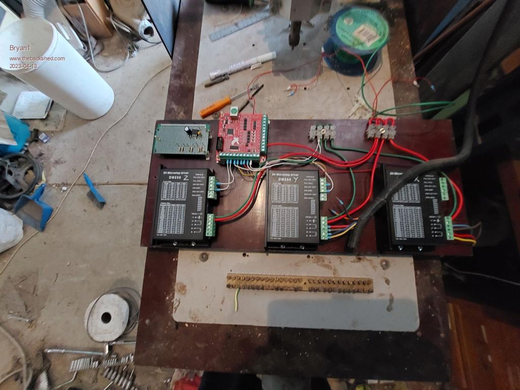

           Well I did have to go back to find this thread and as I have said I bought a desktop computer from Cashies with win10 on it which was buggy as hell so I put my old Win7 home premium disk in and installed that and some of that fun is shown in my win10 thread.
Anyway getting closer as I have bought 3 off DM559 micro steppers and a USB controller board.
Here's a pic of the new board setup
Now on reading the DM556 datasheet one does need to put a 2K resistor on the P and D lines to reduce the current if 12 or 24 volts are used. Now as the schematic for that USB board does have a 10 volt input and in the drawing it shows 12 volts to that pin so with that old simmstick proto board I put a 7812 reg on and so far 3 off !k resistor in series to get 2K as going thru the Adelaide hills all the electronics shops had closed that I used to go to.
So went into Home of 12 volt and grabbed a 300 pack of resistors for $10   typically 2K wasn't in there so 2 off 1K's will do the job.
Now in my gear like I found those 50 amp current sensors only to find they are no longer made I new I still had some 7812 chips left. Well the only ones i found was in a DPAK form smd and found it was easy to solder them to the proto board. There is a 100uf 50 volt cap on the input and a 10uf tantalum cap on the output. I will put more earth pins on there to cater for the limit switch's etc.
So getting there and soon I do hope to get this running, I do have a mate coming down this weekend to have a look as when connecting something after close to 10 years a second is better than one.
Cheers Bryan

Now as I have those 3 DM556 boards all I need to make is a board so opto outputs from the CMM2 to the modules are protected.
Got plenty of opto parts on boards here and with some veroboard the protoboard can be made.
The more I think about this is eh we need a pulse for enable, a pulse for forward backward and measurable PWM for the motion.
Take this with all 3 axis and only 9 pins are needed for the drive, now for the limits one can either just use one pin but as we have a 40 pin connector each limit can be detected.
I will need to get a USB power supply for the CMM2 as at the moment I'm using my torch which has a 1.5amp outlet. I got a 19" screen to work but that 24" lcd with all the usb outputs wouldn't work with the CM2.
Over the next few days I'll have a go at making a program but coding has always been my problem and the I think about this it time for an old dog to learn new things.

            I have been reading the datasheet on the DM556 and it will accept as low as 5 volts as the logic level and it does go all the way upto 24 volts.
I reckon it would be best to use an opto going to a NPN transistor and pulling up the logic lines to 5 volts then using the digital output pins to switch the logic for the enable and direction pins.
For the pulse pins PWM so the speed can be adjusted also hooked upto a count pin so the CMM2 can know when the distance is reached.
Now I do think to read the G-code if the file was set to a text file each line could be decoded one at a time.
Going the opto route is the safest and best way but I'm asking just to see if will work hooking the pins straight upto the DM556 and see if the steppers actually move or just wait and build the opto board first.

Well saw the new year in trying to get the steppers to move with no luck, first tried PWM and when I hit run there was a noise coming from from the DM556 but no movement. So the tried servo with the same result.   The green LED was on with all 3 of the DM556's so and no red LED lit at all thru the night.
Now for reference I did pullup each data line with the 5 volt rail on the CMM2 and connected ground from the CMM2 to the board.
Then just tried pin(12) = 1
pause
pin(12) = 0
Now using my fluke 865 on scope mode only saw 3.5 volts and no hertz, toggled the direction and enable and did see the voltages change so that did prove the CMM2 does have life outside.
So I do think the voltage is too low to drive the DM556 direct and I will need to make up a board and use a higher DC voltage so when the PWM running the 1/2 average voltage is above 5 volts.
