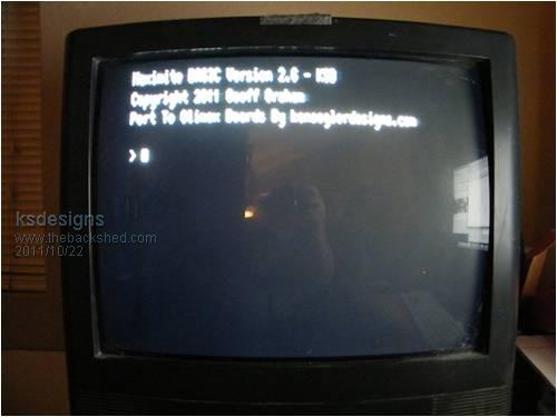

Posted: 03:38am 22 Oct 2011
ok don't know why but i recompiled it under MPLAB-X on my mac and it works now
Dont look so good but no vertical roll now.
These values work only 16 lines 18 you will lost on top and bottom.
ken
#define C_VRES 192//216 // Vert graphics resolution (pixels)
#define C_HRES 304 // Horiz graphics resolution (pixels)
#define C_LINE_N 262//312 // number of lines in PAL frame
#define C_LINE_T 5084//5120 // Tpb clock in a line (64us)

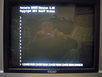

Hi,
I have loaded the V2.6E software from Geoff and tried it to a 20 inch Teac color TV.
Immediate sync up and I can easily view 50 characters by 18 lines of text. I did not adjust the TV. Unfortunately there is a slight jitter of the characters compared to the PAL signal to the same TV. I am not surprised to see 18 lines, and think that Ken’s monitor may be over-scanned. On my TV the NTSC display used more vertical screen space than PAL but there was an adequate margin. I could view the video waveforms readily with my oscilloscope and observed the correct timing within the limits of the instrument. It is not young (nor am I) but a dual trace 65 MHz with delayed sweep and a TV sync and calibrated. I looked carefully at the expanded sync of the NTSC signal, searching for a reason for the jitter but found nothing incorrect (yet).
My composite video waveform was nearly 700 millivolts when terminated in 75 ohm. This should be about 1 volt. My Dontronics SM1 has the clamping diode U3 fitted (.7V clamp) but I do not wish to remove my surface mount diode. Perhaps 40% more sync level may remove the jitter, could someone try this. When testing composite video remove any VGA monitor. I am still thinking about the jitter. Perhaps a small number tweak could help? I have photographs of waveforms but include only the Teac NTSC display here to show 18 lines by 50, I think myself also.
Not yet the final answer, also that Ken should have a problem with a compiler is a worry, but not a unique experience.
