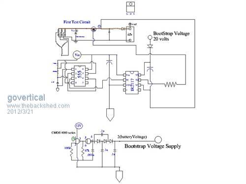

Posted: 10:00pm 20 Mar 2012
Hi, new test circuit based of information received and suggestions. Basically it is the same circuit as before with a blocking diode added at the plus battery terminal and a voltage pump for the bootstrap capacitor. Vg - Vs > Vthreshold , 20 - 12 = 8volts.
If it works the mosfet’s can be paralleled and the control circuits can be duplicated for increased current output.
I apology for jumping all over with this project. I was so happy with the results driving a resistive load I lost focus of what I am trying to achieve. I am concentrating all my efforts now to interface the working circuit to charge a 12 volt battery. I have not tried all the suggestions but the problem has been traced to the bootstrap not charging, that has been suggested by others. Thank you for all the help I have been receiving and comments are welcome.
just because your a GURU or forum administer does not mean your always correct :)
Posted: 10:27pm 20 Mar 2012
The blocking diode after the buck regulator choke will certainly isolate the battery at initial startup.
But when the MOSFET is off, the source voltage will then just be left floating.
It needs something to pull the source right down to ground, because that is also the charging path for the bootstrap capacitor.
Twenty volts is getting dangerously high for the bootstrap supply voltage.
The MOSFET gate voltage is only rated to twenty volts maximum.
If you start popping MOSFETS, that will very likely be the reason why.
Twelve volts is ideal, fifteen getting rather high, and twenty volts is extremely dangerous.

Posted: 12:03am 21 Mar 2012
Hi, in the past I received a suggestion to attach a 100k resistor between the gate and ground to make sure the mosfet turns off, would that provide a path to return Vs to zero volts? Thank you for information.
Posted: 12:11am 21 Mar 2012
  govertical said   Hi, in the past I received a suggestion to attach a 100k resistor between the gate and ground to make sure the mosfet turns off, would that provide a path to return Vs to zero volts? Thank you for information.
No.
The problem is not turning the MOSFET off, but turning it on.
For that to happen the bootstrap capacitor needs to be charged to maybe 12 volts.
The bootstrap capacitor can never charge up at all while the negative end (also connected to the MOSFET source) is left totally floating.
The negative end of the bootstrap capacitor MUST BE GROUNDED at least momentarily for it to charge up.

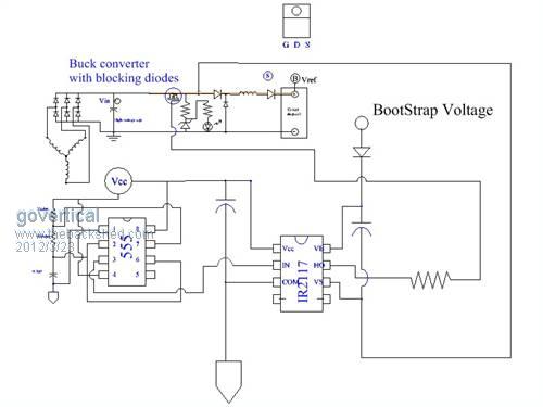

Posted: 12:51pm 22 Mar 2012
Hi, I am thinking about adding a second blocking diode. Would a zener and LED configuration be able to pull Vs to ground during the off cycle? Any comments will be greatly appreciated.
Edited by govertical 2012-03-24
Posted: 08:40pm 22 Mar 2012
  govertical said   Would a zener and LED configuration be able to pull Vs to ground during the off cycle?
No that will not work.
One way to do it would be with a sufficiently large fully discharged capacitor, with an associated bleed down resistor for initial startup.
Once running, the back EMF from the choke will keep it running.
The other much better solution, is to power the bootstrap capacitor continuously from a fully isolated independent power source. Edited by Warpspeed 2012-03-24

Posted: 02:52am 23 Mar 2012

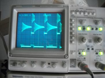

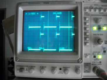

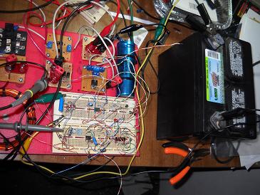

Hi, I was able to find all the needed parts to make all the required connections to interface the circuit to a 12 volt battery. I am using two bench power supplies, one to power IC’s and the other for Vin.
I had just a LED and 22kohm resistor from the mosfet Vs to ground and the mosfet was turning on and off when connected to the battery.
With a capacitor at the output of the circuit no current would flow into the battery. I removed the capacitor and I was able to measure 0.14 amps flowing into the battery.
I had attached a variable resistor to the 555 to be able to test different duty cycle, I adjusted the variable resistor to low and the 555 fried, so I have to purchase some replacements before I can continue testing. Without the valuable suggestions I would not have been able to get the circuit developed to this stage, Thank you. I will post more test results after I replace the 555, thanks again.

Posted: 01:26am 24 Mar 2012
That is quite likely if the PWM duty cycle and input voltage produce an AVERAGED output voltage below the battery terminal voltage.
If the battery voltage is twelve volts, you need a higher voltage than that to charge it.
Say 50% duty cycle and 28 input volts, or 33% duty cycle and 42 input volts for example.

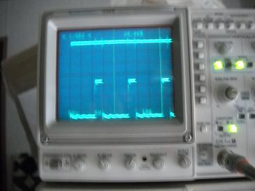

Posted: 02:27am 24 Mar 2012
http://www.youtube.com/watch?v=-UalBvsoTuE&feature=youtu.be
New video of circuit operation with PMA and battery load
New video of circuit operation, I am manually operating the PMA.
12 volt battery as load. Waveform is Vs of N channel mosfet. Vin = 20 volts at highest RPM, current into battery 0.75 amps at highest RPM.
The waveform is not what I expected, at this time I am unable to explain results. It looks like I have to inverter the control signal. comments welcome

Hi, when I use the PMA to test the circuit I get very different results from the results obtained when using the just the bench power supplies.
Posted: 03:47am 24 Mar 2012
Probably because the bench supply is a stiff voltage source, and the PMA is more like a current source.
When you load the bench supply, the regulated voltage stays the same.
When you load a PMA, the voltage will drop significantly.
