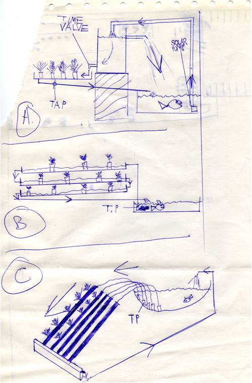

Lapsy
Joined: 28/01/2012
Posts: 103
Posted: 10:19pm 26 Feb 2012
3 Examples and ideas sort of mashed together here...
Please excuse sketchy sketch and oldschool paper torn off...
And to save mega posts and questions T.P stands for Timer Pump!
A. is using a water valve on a timer. Solar pump on its own circuit fills a tank which gets to a level and cascades out into fish pond to aerate the water. Valve is situated lower than this and opens on the timer into another tank of veggies. It then floods to a point. valve shuts or runs out of water. Veg tank slow drains back to fish. Advantage of the valve is it can run dry with no damage as it just stays open. No power to the valve & its closed. Issue is the tank the plants are in. If you expand on it, you may need to expand the water tank (With the valve on also) or hope its a sunny day so the solar pump keeps transfering water.
B. is a gravity pipe version. Pump pumps water up to top pipe vetically. Gravity carries water back to pond via each pipe by falling. Not what I want to do but idea for piping came from that. Usually people push a constant flow of water through this, slow pumping all the time. This will drain the battery in this design. Not good!
C. Simmilar to B but instead of stacking upwards the pipes are level next to each other horizontally. Although the pipes flood simmilar to A.'s plant bed. Slow return to the pond held up by an irrigation tap. I think...1 pump per pipe... as manifolding equal amounts to each pipe may be an issue to regulate.
Long as its the same pump for each pipe I think its safe so say they would pump approximatly the same volume (in theory). Pumps activated by timer. Could probably still have a solar pump on seperate circuit to run water filter/aerate water on the fall also.
SO... A or C I think so far. none of this is the actual idea I will go with but this is as close as it gets as a current idea.
Cheers!Edited by Lapsy 2012-02-28

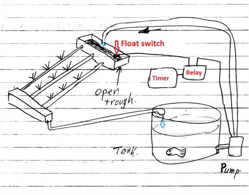

larny
Joined: 31/10/2011
Posts: 349
Posted: 04:55am 27 Feb 2012
Your pictures are worth 1000 words. Now I see what you're doing.
Here is a thought.
You said a manifold would not be any good as the flow in each pipe may not be equal.
If you had a trough as drawn, the head for each pipe would be equal, so the flows should be about equal.
However, I don't know how high the trough would have to be above the vegies to provide enough head.

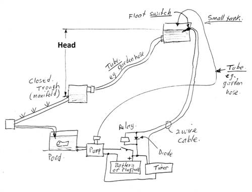

larny
Joined: 31/10/2011
Posts: 349
Posted: 09:39pm 28 Feb 2012
When I said "Float Switch" I meant an electrical float switch not a toilet cystern type Float Valve.
See the attachment below for an variant of what I posted last time.
This idea provides more head than the previous.
I don't know how much head you will need, you will have to experiment.
I'll post another variant later in the day. I have other things to do ATM.
Len

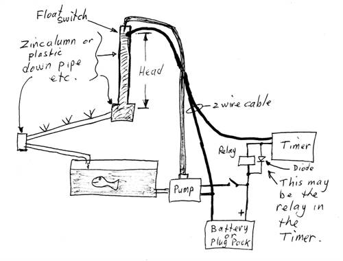

Joined: 31/10/2011
Posts: 349
Posted: 10:04pm 29 Feb 2012
Here is the promised next suggestion.
It is a variant on the previous.
Note that the relay & diode may be the ones in the Timer, it depends on the starting current of the pump motor.
The point of the Float Switch is to turn the pump on when the water level in the column drops & to switch it off when the level reaches the limit.
Alternatively, you could simply have an overflow that goes back to the pond so the pump runs continuously while the relay is operated by the Timer.
JayCar sell a suitable Float Switch.
However, they may be available from irrigation parts suppliers.
Len

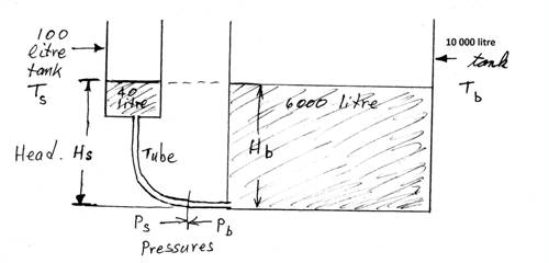

Joined: 31/10/2011
Posts: 349
Posted: 10:09pm 02 Mar 2012
This should help you to visualise the “head” of water and its relationship to the water pressure.
The diagram shows a 100 litre tank connected via a tube to a 10,000 litre tank.
Obviously, when water is poured into one tank or the other, water will flow through the tube until the levels are equal.
At this point the head of Ts is equal to the head of Tb, i.e. Hs = Hb.
Therefore the pressures are equal and opposite, i.e. Ps = Pb. Thus there is no flow in the tube.
Now suppose someone pours 50 litre of water into Ts quickly.
Initially, the level in Ts will be higher than that in Tb, so Ps > Pb.
Therefore water will flow from Ts to Tb until the levels are again equal.
Len

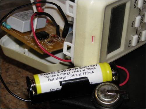

Funny this... as bricklayers have been known to use a clear plastic pipe and water as a level. Water always levels out even. Usually used to check the corner heights of houses to make sure each corner is level. Cheers also for the header info. Something to definatly consider taking into account on this design.
Also got a slight mod update... got round to soldering a AA battery clip into the timer.
LCD is lit and functioning unfaded, so plenty of juice there. Plugged into mains, AA seems to be charging nicely, batterys not feeling warm so seems steady.
In the pic you can see the old coin cell I took out. I had that charging overnight but woke to no LCD display so thats over with. AA is Nicad which was the original type in the timer. The replacement coin battery shown was obtained from Battery World. The NiMh and was nowhere near as good as the original, they charged me something like $8 many years back, and were the only people I could find to supply a replacement. See how this runs in meantime for timer recovery.

larny
Joined: 31/10/2011
Posts: 349
Posted: 03:06am 04 Mar 2012
I presume the reason that the NiMh battery did not work well is because they need a different charger to NiCADs.
As you probably know, the disadvantage with NiCADs is they have "memory" so they need to go through full charge/dicharge cycles.
Len
