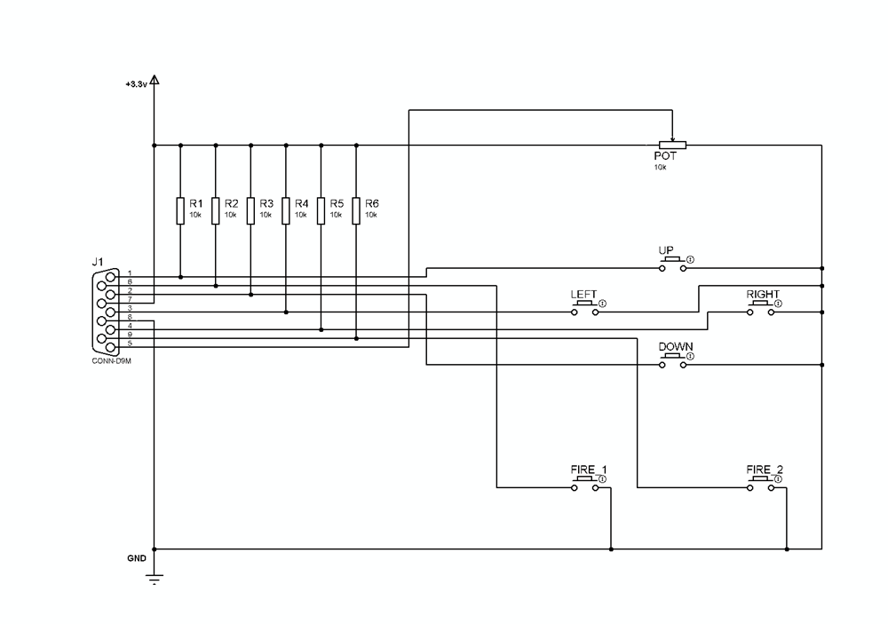

I'm having "Joystick Nightmares"!
First, I couldn't get the Wii Nunchuck to work at all.
So I gave up and decided to go to an Atari style stick and while it works, it's response is terrible.
I'm sure I've wire up all the correct joystick lines to the appropriate digital pins (as Darth's) but I often seem to get multiple reads of the positions.
I've written the following test routine...
FOR x=11 TO 15
SETPIN x,2
NEXT
SCAN:
LOCATE 0,100
FOR x=11 TO 15
PRINT PIN(x)
PAUSE 10
NEXT
GOTO SCAN
(The PAUSE 10 was put in to give the read some settle time, shouldn't be needed)
Often when I move the joystick UP, I get an UP and RIGHT reading. Two readings! Which causes my game to do the wrong thing. Other times it doesn't read at all and other times it reads correctly.
I thought it was the joystick so have tried a few, same problem.
I removed the joystick and shorted the direction pins manually with a probe/wire, again the same.
I'm using a prototyping board for the MM connected via a ribbon cable to the MM. Could it be interference? I'll buy an edge connector today and wire the stick directly, keeping wires short.
I just can't seem to get accurate digital reading from the joystick.
Any clues anyone?Edited by Nick 2012-03-17
Vikingboy
Joined: 23/09/2011
Posts: 82
Posted: 11:15pm 15 Mar 2012
Hi Nick,
Just an idea, you will need pull op or down resistors for the atari style as they are just straight switches, I found without them I got unreliable results, also as they are switches you may find a debounce routine may help.
rgds,
Andrew
Nick
Joined: 09/06/2011
Posts: 512
Posted: 11:33pm 15 Mar 2012
I think you could be right on this. What value pullup resistors should I use? 1K?
And do I tie the individual direction pin to 5v?
Vikingboy
Joined: 23/09/2011
Posts: 82
Posted: 12:03am 16 Mar 2012
I am by no means an expert and some one else can probably tell you the correct value, but I just used some 500 ohm resistors and pulled each input line high and then closing the switch for each direction pulls it back to 0v.
and set the pin appropriately, or use an interupt to be active low, dont know which would be more suitable.
rgds,
Andrew
darthmite
Joined: 20/11/2011
Location: France
Posts: 240
Posted: 03:36am 16 Mar 2012
Hi Nick ,
I forget to tell you that all button are pulled up with a 10K resistor.
The normal state is 1 and when you press a button you get the 0.
Here is my joystick test program :
'Amiga Compatible Joystick test for Maximite
CLEAR
CLS
'PIN 11 = UP
SETPIN 11,2
'PIN 12 = DOWN
SETPIN 12,2
'PIN 13 = LEFT
SETPIN 13,2
'PIN 14 = RIGHT
SETPIN 14,2
'PIN 15 = Button 1
SETPIN 15,2
'PIN 16 = Button 2
SETPIN 16,2
'PIN 1 = Potentiometer
SETPIN 1,1
'Main Loop
DO While 1
locate 0,0 : print "UP = ";PIN(11);" "
locate 0,20 : print "DOWN = ";PIN(12);" "
locate 0,40 : print "LEFT = ";PIN(13);" "
locate 0,60 : print "RIGHT = ";PIN(14);" "
locate 0,80 : print "BUTTON 1 = ";PIN(15);" "
locate 0,100 : print "BUTTON 2 = ";PIN(16);" "
locate 0,120 : print "POTENTIOMETER = ";PIN(1);" "
loop
here the Schematic :
Edited by darthmite 2012-03-17

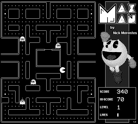

Posted: 08:14pm 26 Mar 2012
MaxMan is here!
Written completely in MMBasic for the Maximite Computer developed by Geoff Graham.
Firstly, I must stress to the programming purists out there that MaxMan is NOT an example of structured coding. It contains many GOTO statements and has heavy use of multiple statement lines. For many, the code will be very hard to understand … but I have no problem following the code myself.
This game is to be ENJOYED, not STUDIED.
Copy the files to your SD card and RUN”MAXMAN” to get it going on your Maximite.
The game supports keyboard and joystick (using Darthmite’s Atari stick specification). Unfortunately, no Wii Nunchuck (couldn’t get my nunchuck to work). More control instructions are included within the code opening REM lines.
It features arcade-like sound effects so hook up that amp!
It is designed for a VGA display, LCD or CRT (looks best on a CRT).
It requires MMbasic 3.1.
I would be curious to know if it also works on the other Maximite compatible machines.
Enjoy the first commercial grade arcade game for the Maximite!
DOWNLOAD: 2012-03-27_061443_MAXMAN.zip
Edited by Nick 2012-03-28
