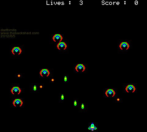

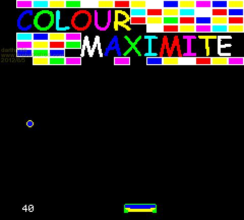

Posted: 07:45am 05 Aug 2012
Hi
Before i restart to work and get no more free time i have want made some
other tests with the last MMBasic v4.0 beta 12.
The today tests was a arcade like game ...
And a little Breakout game ...
And to see everything move i made a little video
Arcade / Breakout video

Very good darthmite. These programs you are producing show others what the new Colour Maximite and MMBasic is capable of.
The important thing to stress to everyone, especially those from outside of the Maximite camp is that alll these demo's are written in simple-to-use *Interpretive BASIC*, no compilation, no C or assembly code but B A S I C.
These new graphics commands can be used for more than games.
