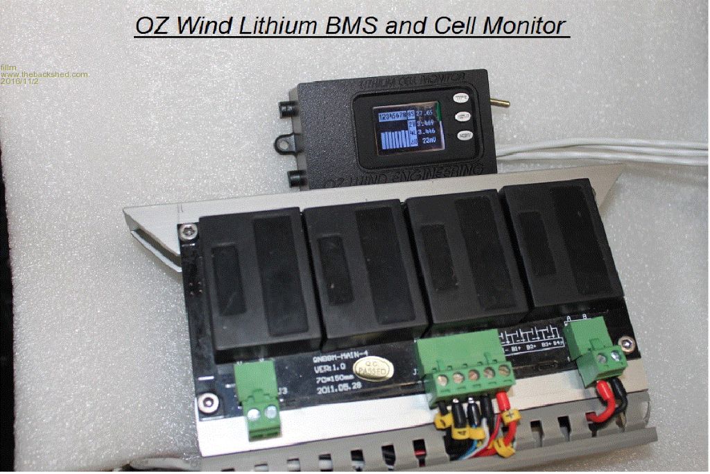

Hi Tinker ,
Just caught up on this thread,and well done for persisting. Might be interested in having a go at building one for my ultracap bank, but for 25 x 3000F that would mean 3 of these and dropping a cap.
The little diode and LED balancers work OK and have changed a couple of LEDs that were slightly different causing some out of balance, this can be tolerated because of the extra Cap giving a upper voltage point of about 68V and the cost of the cap is way below balancing but with batteries it is a different story.

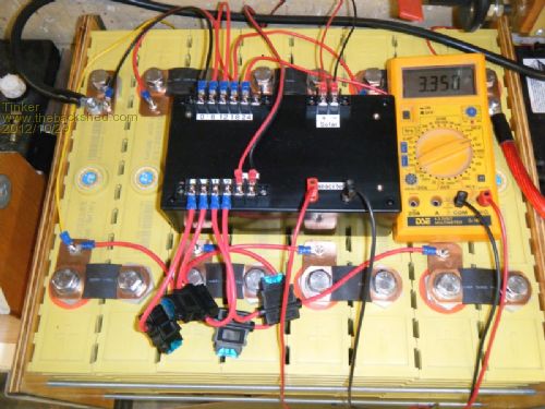

Some further observations on my battery cell balancing contraption:
For the last few days the battery bank got really fully charged, the charge current was way down around lunchtime to <2A for a 600Ah bank whereas at about 7:30 AM it was charging at 30+ Amps.
Yes, the relay / supercap combination works but albeit slowly. The supercap used is 50F BTW (2 x 100F in series). The max battery charging voltage from the MPPT leveled at 28.9V and remained at that until the panels lost the sun in the evening.
The max voltage at an individual cell was measured at 3.8V with about 0.3V min/ max difference, the latter dropping slowly during the afternoon, there was still a 0.2V min/ max difference at the end of the day.
So, my balancer kept the cells well inside their upper limit. This was not so without it as I initially - before connecting the balancer - measured the cell difference and found one hitting 4.0V at which stage I removed the charge input.
I will experiment with longer 'relay on' periods in the next days and see if there is much difference.
Regarding switching currents at the relay contacts, I measured these with a clamp on Amp meter once the balancer switched itself on, (happens when MPPT input voltage rises to 36V - its around 33V when charging is flat out), and it was between 2 and 3 Amp for the 2 - 3 seconds each relay is activated. This dropped once the bank was fully charged as smaller & smaller 'packets' of charge were transferred between the cells.
With the relay contacts rated at 25A DC switching I don't think contact burnout will be a worry since I solved the relay timing problem.
It is my opinion that this device is good for 8 battery cells max, I think the time delay in transferring charge 'packets' between more cells or capacitors is too long above that number. If I had a 48V system I simply would use 2 balancers working independently, its highly unlikely that there would be much difference between 2 sets of 8 cells connected in series then.

If you are interested I can offer a closer alternative, a BMS that is continuously active and can be turned of if necessary and will easily balance to within 10mV I have Junsi's across 2 x 24V 400A/hr Winston which of course are 48V and run a charge V of 57.8, On one cell it separates 200 -300mV every cycle and is easily bought back with in 10mV in a few hrs at the upper V.. I am on the south side of Bris . I have fitted them to quite a few systems and they work perfectly in regular Off - Grid lithium systems. If you want more info contact me privately or PM .
Sorry for the hi-jack Tinker

A Junsi is a cell log device, it monitors each cell (up to 8) and has a small alarm output that will pull in on LV, HV or cell high, depending on the parameters you set. My second one has parameters set outside the first, so if the first one fails an alarm is sounded
http://www.jun-si.com/EnProductShow.asp?ID=105
Small device about 30 AUD but quite good, need to be careful of the relay output, just use it to switch a bigger relay, apart from that very solid device.
Only issue using it on a 8 cell pack is that it only draws power to run from the first 6 cells, over time creating an imbalance.Edited by busman 2016-11-02

Hi Klaus,
Personally I do not have or have or had any problems with the Junsi Monitor causing imbalance, the power drawn is minuscule weighed up to the benefit of having a constant little screen to see the individual cell voltages as well as the alarm output and inbuilt pezo beeper.
All my systems have the BMS with the Monitor as shown and have no problems keeping my bank of 400A/hr with in 10mV. I have one cell that always separates and to 200~250mV every cycle and in a few hrs it is back in check.
Edited by fillm 2016-11-03
