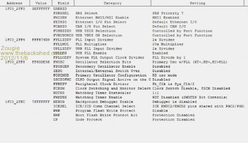

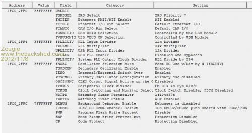

Hi Guys, I've just taken some screen shots of MPLBAB 8.87 comparing bit configs of both the Maximite V4.0 color w/bootloader firmware and UBW32 native bootloader.
Below is the screenshot of the MMBasic 4.0 w/bootlaoder bit configs I have previously tried which resulted in a non runner PIC:
And here is the UBW32 native bit config which did work, but resulted in the non functional pin 1:
Appologies if the quality isn't perfect, it should be readable though.

Posts: 2984
Posted: 10:23am 21 Nov 2012
Hi George, Johan and others,
I have just hit the same problem with a UBW32, It appears that the oscillator settings on some UBW32's are not working, I have emailed Geoff and he has responded with....
"Both modes should be the same except that HS mode should be more forgiving of lower performing oscillators. But maybe it is over driving the crystal on the UBW32 board."
SO I gather that some batches of PIC32's or the XTALs differ in some way..
Anyway the fix (Thanks George, Johan and Geoff) is to load them automatically (the default) then uncheck the and change the "configuration bits set in code" check box and make the changes as per this PDF (see red section) You should see that adress 1FC0_2FF8 has becomes FF600DDB.
