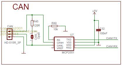

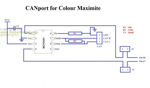

  bigmik said   Hi Lopez, All,
Secondly, taking note of the section of my schematic, (the one with the pale yellow background), please note the pin Numbering of the IC is not the same as the PHYSICAL pin numbering so dont wire up as if the position of the pins are as shown, use the pinout as shown in the "package types" above., (i.e. The NUMBERS are correct, the physical location of the pins is not.)Mick
Thanks for pointing it out again Mick.
Here is a diagram where pin numbering matches actual pin configuration.
R2 is a termination resistor and may not be needed.
Note how the CAN plug pin numbers do not match the Duinomite Mega. I am using the same plug for my CGcolourmax1 CANport as that is used by Duinomite Mega. I need to swap pin numbers 2 and 3 so the CANport plug pins are compatible between my CGColourMax1 and my Duinomite Mega.

Hi Lopez,
Thanks for the new diagram, The R2 is mentioned (with an *) in the Parts list and also in the manual that it is a termination resistor and `may' not be needed.
  Lopezjm2001 said
Note how the CAN plug pin numbers do not match the Duinomite Mega. I need to swap pin numbers 2 and 3 so the CANport plug pins are compatible between my CGColourMax1 and my Duinomite Mega.
Yes that was an error on my part that I didn't discover till the boards went for production, however as the pins appeared on a `non-standard' 3 pin header and meant that anyone using it would need to make their own cable I figured it was a moot point and wasnt worth a mention. I admit, I didn't foresee someone swapping a cable from a DM to the UBW32-CMM and vice versa.

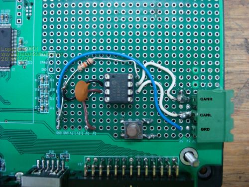

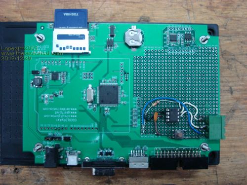

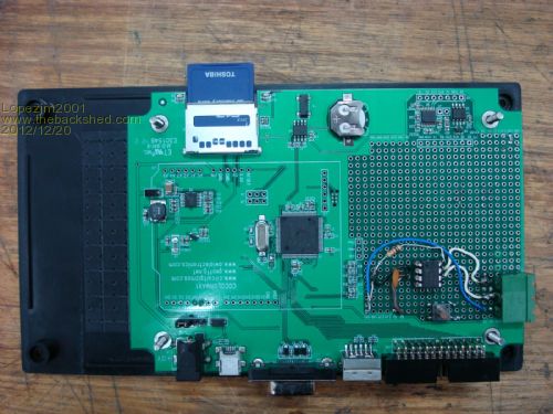

Posted: 10:36pm 19 Dec 2012

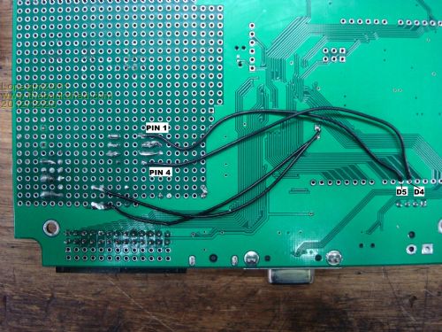

UPDATE: I have added my CANbus port circuit as shown in the photos below. Geoff has provided me with a beta version of MMbasic with John Harding's CAN commands which I have downloaded for the purposes of testing Geoff's MMbasic.
Unfortunately at the moment when I run the MMbasic program I get the error "Failed to Enable CAN module". What to do next. I tried adding a 120 ohm terminating resistor - same.
I have tried using three MCP2551I/P. One I bought from China(hong Kong) on Ebay and the other two I bought locally from Element 14 which came from the USA. They all give me the same result i.e. "Failed to Enable CAN module".
Any help from you guys would be appreciated.

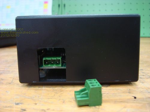

PS - I bought a box from Jaycar which I milled it at work and fitted OK.

I don't see it as the MCP2551 as it's just a transceiver.
Sounds like a software bug.
JohnEdited by JohnS 2012-12-21

How much did those MCP2551I/P cost, and shipping? (i am curious because i might open shop to sell those and other electronics of course and wonder if it is worth the effort.)
They are only drivers and are not able to be 'enabled'.
The PIC32 has however CAN peripherals that have to be enabled before they can be used.
Enabling will give the specific CAN functionality to certain pins.
I guess the error comes from MMBasic trying to enable the CAN peripheral in the PIC32.

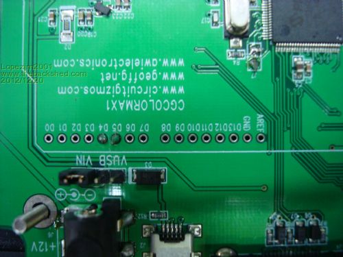

Is the chip on your CGCOLORMAX1 a PIC32MX795F512L. I believe that the earlier CGCOLORMAX1s were only fitted with the PIC32MX695F512L (which does not have CAN).

Lopezjm2001
Joined: 08/07/2012
Posts: 42
Posted: 07:39pm 20 Dec 2012
  TZAdvantage said   How much did those MCP2551I/P cost, and shipping? (i am curious because i might open shop to sell those and other electronics of course and wonder if it is worth the effort.)

It is PIC32MX695F512L-801/PF. Mistery solved. Now I may as well just throw the f...... thing into the rubbish bin.
OUCH! Geoff picked it in one.
It has no CAN. That is the problem.
