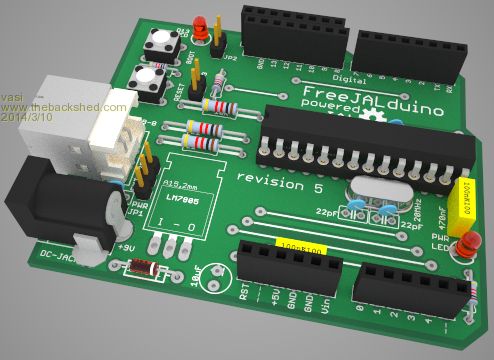

- in Eagle (with some scripts help) I can generate excellent 3D images, very good for illustrations, documentation and advertising like the one bellow:
But you can get good 3D images with DipTrace too:

I agree the eagle 3D looks better but in all honesty I have never needed nor wanted 3D and even though Protel99se has 3D..
I want nice, readable Schematics and good artwork..
That aside it does have some interesting 3D views, like transparent PCB so you can see through the Board for both layers and components and a "stretch mode" so you can see internal layer connections...
