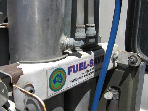

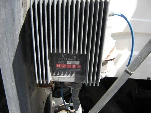

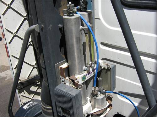

For the interest of all, while i was away i called in on trucking company and took some photos of a HHO system used on some heavy transport that i quoted in a previous posting.
It might be hard to understand that these systems costed around AU$5000.00 per unit and now are on a fleet of trucks as they have proven their worth from a single trial conducted by the fleet owner.
I know of no fleet owner that would spend that sort of dollars if a good return was not garenteed from the investment cost due to a trial.
As i maintained previous the benifits are there for heavy diesels but not pracital for smaller vehicals.
As far as i can aceataine the system runs on 12 volt as the control module is nothing more than a 24v to 12v converter one attached to each cell.
The system has 2 x HHO cells and a bubbler as a flash back arrester.
Every chamber is made of SS tube, welded as as sealed unit.
The electrolite used is Phoshoric acid and water.
Bubbler
System supplyer/installer
Power supply
For the oversea's members these are the baby rigs running these systems, called a "B'Double" here.
I say baby in size as road trains are much bigger and are more common to central Austraila and lesser built up areas. ( you try turning a primemover with a triple set of trailers through a set of trafic lights #&*@ no more lights $$$$ )
The rigs shown do a 1000km round trip daily, 6 days a week.( washed and serviced on the 7 day )
Which would be considered a short run in trucking standards.
Pete.

Errr?
The stronger the acid the more current it draws but nothing else changes, other than current = HHO production rate,
I think these cells were operating under 10 amp per cell.
Pete.

oztules
Joined: 26/07/2007
Posts: 1686
Posted: 05:38pm 12 Jan 2010
How many cells Pete? If it is only 2 cells......20A.... I smell snake oil. At least Bob had equivalent to 1000A for his 10L/min This was more than plausible.
20A is only 20/1000 X 10 = 200ml/min. If that effects a massive motor like that... draw your own conclusions.... must be using cold fusion.
2 cells would have to draw over 500A each to match Bobs unit.... and I suspect his motor was not quite of that scale.
Out of curiosity Bob, how much water was used for how many miles ...... even a good guess will do..... we can then calculate the number of water molecules used, and compare that to the original calcs.
