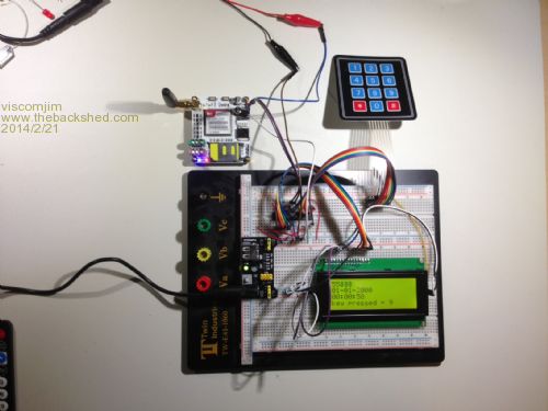

MicroMite Cell phone...
Works great - can make and receive voice calls using headset, best part is playing with SMS to control things...
So far I can tell you the keyboard routine works great, the LCD works great using 2004A, serial works.
This thing is great!
Thanks Geoff

@ viscomjim - what cellphone module are you using, where did you get it, and what did it cost?
I have something like this in mind, and as the commercial SMS module is $400 a pop, I would be VERY interested in your module, especially as you seem to have got it going without much pain, so it would seem.
I would need to see if that module can talk to the New Zealand cellphone networks, but if you would please link me to it....

The GPRS/GSM module is called Efcom pro. The manufacturer is Elecfreaks.com It also comes as a shield (for maximite use). I paid $45.00 for it on ebay new. It uses the SIM900 module and simple AT commands like a hayes modem did back in the day. It will need a sim card to operate. I got a month to month cell plan with talk and SMS only, no data to keep it cheap ($5.00 month), however the unit can do data also if you want web connectivity. Using caller ID, you can do a simple operation (like open a gate) and never answer the phone, or use SMS and do whatever your heart desires. Make sure to use COM1 as it is 5v tolerant. I powered mine off a 5v 2A separate wall wart to play with as the data sheet says it can have up to 2 amp spikes once in a while. I guess larger cap could help with a smaller supply.

sometimes ago i used a gsm module with the maximite .
its really great and provides a lot of gsm info if you have the right AT commans for.
i use a 2,5 A power station for because the module needs moore power if the conection is miserable.
( works at home but not in my garage) . also it needs antenna tuning .
ill never tested internet connection with but for sms its great.
its a little bit like " build your own iphone" because u can also play games with the maximite if you will.
