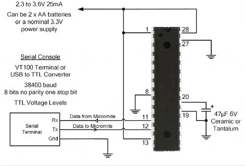

A device with a portpin that shows an Arrow pointing to the device is receiving data on this pin.
So this pin RXD.
An Arrow that directs out of The pin sends data on this pin, so its TXD.
This IS also an industry standard for fibrechannel or SAS ports.
Absolutely clear an logic.
Posts: 2984
Posted: 12:53pm 20 Mar 2014
  viscomjim said  How many beta testers for micromite and how many users of maximite have ever considered this as an issue. I have not seen any forum posts that read, "I can't get my terminal program to talk to xmite as I can't seem to figure out the meaning of RX an TX."
Hi viscomjim,
This is probably because Geoff supplied a circuit that it completely clear and unambiguous.
See the following Circuit from the manual. Not only did Geoff draw little arrows to show direction, he added text to emphasise it.
Posts: 10100
Posted: 01:11pm 20 Mar 2014
Yes, I have to agree - the manual is superbly written.

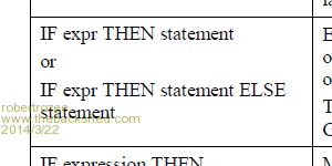

a bug, perhaps. a new bug!
the following code fragment fails abysmally:
Function keypress(a)
Print "called"
If keyvolt > 1.7 Then
keypress = -1
Else
If keyvolt < 0.140 Then keypress = 1 Else
If keyvolt < 0.225 Then keypress = 4 Else
If keyvolt < 0.330 Then keypress = 7 Else
the error comes up at the line containing 0.140 (the previous different IF format was just to see the error pushed down to the next IF statement). the output is:
  Quote  > run
called
[30] If keyvolt < 0.140 Then keypress = 1 Else
Error: Invalid syntax
i think that the problem is the interpreter being unhappy with keypress being assigned to withing a 1-line IF... THEN... ELSE statement without parameters to the function. ie, the interpreter is trying to call the function keypress, rather than assigning 1 to the returned value.
there is also something wonky about creating and calling a function that has no arguments. i added the (a) to try and get around that.
rob :-)Edited by robert.rozee 2014-03-23
Posts: 3372
Posted: 04:06am 22 Mar 2014
The problem is with the syntax that you used. You have a single line IF statement and the correct syntax is:
IF <condition> THEN <statement> ELSE <statement>
But you have nothing after the ELSE. The interpreter is quite correctly saying "else what?"
You should use the multiline version:
keypress = 1
ElseIf keyvolt < 0.225 Then
keypress = 4
ElseIf keyvolt < 0.330 Then
keypress = 7
EndIf
Standard Microsoft syntax, page 37 of the manual.
Geoff
Posts: 2556
Posted: 04:12am 22 Mar 2014
aha! i had just copied the syntax from page 37 as it was formatted:
rob :-)
