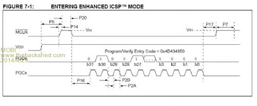

To programme the PIC32, basic wiring should be as for uMite in Geoff's technical manual.
Programming mode is entered using the timing chart shown and then clocking in a 32 bit data sequence "MCHP" MSB first. (wouldn't stand for Microchip now would it?)
That is the easy part

Looking at the timing chart, it seems that there may be a problem. Time P17 must be a maximum of 100nSec which is outside the capabilities of MMbasic.
I'll give it a try but might have to do only 4 wire yet (or devise a MCU dongle - which isn't the general idea. Edited by MOBI 2014-04-30

What you mention above about P17 is not 100% true about timing (data sheet probably wrong - there's a surprise!). I have recorded and studied a timing capture of an actual programming session.
In this capture I am seeing P17 as 2.5885mS . . . so keep going - it should work fine!!

If that P17 has to be fast after the last databit then you can probably use the PORT command to set that last bit and change the MCLR at the same time from BASIC.
Those two bits will then be set from within the firmware and that is probably very fast.

Referring to the Figure 7-1: ENTERING ENHANCED ICSP MODE shown above.
I have a different version of Figure 7-1 from document: -
DS60001145M
“PIC32 Flash Programming Specification”
2007-2013 Microchip Technology Inc.
On the Figure 7-1 (Page 19) P17 becomes P19 with a specification (Page 59) of Minimum 40 ns.

  Quote  In this capture I am seeing P17 as 2.5885mS . . . so keep going - it should work fine!!
Thanks, that saves me cranking up the cro. I did wonder if the P17 could be longer. It wouldn't be the first time Microchip got delay mixed up with rise time. I think the short time constraint is due to needing the MCLR high before any internal timers kick in.
I think the P17 is the only one that is a maximum and all the rest can be mSecs.

Apparently 4 wire programming doesn't need the special "enter program mode" but as I said earlier, most boards are set up for 2 wire ISCP.
@Keith, sorry, I missed your post. Typical of Microchip, different data sheets on the same subject have different info. Surprising I still have much of my hair yet. I'll persist with 2 wire method even if I have to concoct a dongle to interface.Edited by MOBI 2014-04-30
