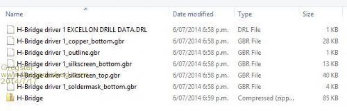

You will also need to export the drilling information, normally in the form of an Excellon Drill Data file, which is normally just a TXT file, but my program(Sprint Layout 6) exports this file as a DRL file(Drilling). I just send this to iTead as is(as a DRL file), but make sure I rename it to EXCELLON DRILL DATA.DRL with the PCB filename as with all the other gerber files.
You will need to zip all the separate files into one ZIP file with the likes of 7-Zip, and then send them the one ZIP file, which will contain all the separate files.
Sounds like a mess, and a pain, until you do it a couple of times, then it is easy and you do it without even thinking. No matter which PCB house you choose, they all pretty much need the same set of files in a ZIP, so it's more-or-less the same procedure for any place you try....

I am not Mick, but this is all I did - export the Gerbers and drilling data to a folder somewhere, then zip all the files into one ZIP file, and send them that along with your order-number.
These filenames were generated by my PCB software(Sprint Layout 6), but I did add the EXCELLON DRILL DATA to that file, for clarification.
I zipped all the files into a single ZIP file using 7-Zip(store, no compression), and then emailed that ZIP file to them.
