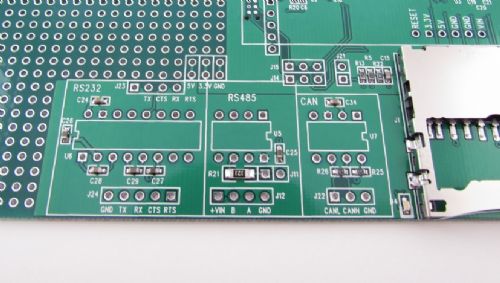

I've sold a bunch of the CAN interface chips with the CGCOLORMAX2. See below for the CAN interface board area.

  CircuitGizmos said   I've sold a bunch of the CAN interface chips with the CGCOLORMAX2.
yes, but has anyone out there actually made use of the maximite's CAN to control or talk to a device? for instance talking to a car EMU, interfacing to trimble machine control sensors, communicating through a harsh environment between two maximites, etc. and not just an 'i plan to', a real 'i have written code that' :-)
i'm afraid that being on to-do list doesn't really count... i have many things on my own personal to-do list that will quite certainly never make it into the light of day.
