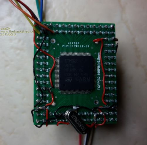

I'm trying to run STM32F407VGT, with the above pins configuration and firmware B12 but not working. Console and USB does not respond. Suggestions?
VCAP between VDD and GND
VCAP on pins Vcap vs GND
10K between boot and GND
10K and 100nF on reset + progs connections + USB connection
8MHz quartz
uart Console pins 25 and 26
The quartz is oscillating but if I connect the USB is not recognized by PC.
Please Help me

Posts: 313
Posted: 08:24pm 26 May 2015
Hi Zonker
Thanks ... then.. I used to program STM32 with STlink protocol through a old discovery in configuration programmer. I can program it but does not work ...
The firmware is Armiteb19USB.hex
Please Could someone confirm or attach a minimal circuit diagram?

Posts: 11938
Posted: 09:29pm 26 May 2015
  Quote  Could someone confirm or attach a minimal circuit diagram?
Look at the circuit diagrams in the user manual for the STM32F4-discovery. Also see this application note
You need to make sure the boot pins are correctly connected. On the USB issue, I think the STM code assumes OTG wiring is correctly implemented. I can't help with this but again look at the Discovery manual.
Zonker: The Discovery board includes a separate ST-Link programmer which can be used to program stand-alone STM32 chips

Hi Matherp
I reviewed the circuit and managed to make it work. Now via USB vcom, now the STM32 ask me as input a pin code ..ahhh ? (firmware is ARMMITEB19USB.HEX)
Thanks for your help
Posts: 11938
Posted: 10:35pm 30 May 2015
Try doing an "erase all" before programming. The options and any user program don't get overridden when programming normally as, by default, the programmer only updates flash sectors that are in the program code. There is a setting in the programmer set up for it always to erase everything.
Please can you post your final minimal circuit - I'm sure many of us would find that usefulEdited by matherp 2015-06-01

Posted: 07:16am 01 Jun 2015
Hi Matherp
I able to run ST32... finally. Very impressed!.
What are the differences with the original version of micromite?
Edit functions work? There is a minimum of manual?
I had plans to create a board with ST32 but had not yet decided which OS put.
Now ....I can think to use the this firmware to create a board suitable for many purposes? I need authorization ??
I will attach a short circuit and of the sample images
