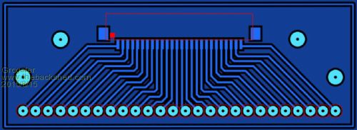

UPDATE: I have removed the FPC(flexible Printed Circuit) socket from the circuit board using Chip-Quik, and have used it to find some new replacements. You can buy 10 of these connectors for US$5 with free freight from eBay.
FPC connector to suit blue keyboard matrix
I also designed an extremely simple breakout PCB for this connector, so that I can experiment with the matrix decoding. This PCB I will etch here at home tomorrow, as it is so small and simple, and then I can get to experimenting with the matrix right away.
At this stage, I am going to try the "Rob method"(robert.rozee) to decode the matrix - a small plug-pack, and an LED + resistor. I will translate the keypresses from the matrix, into a spreadsheet for future reference, and also for including in the constructors pack.

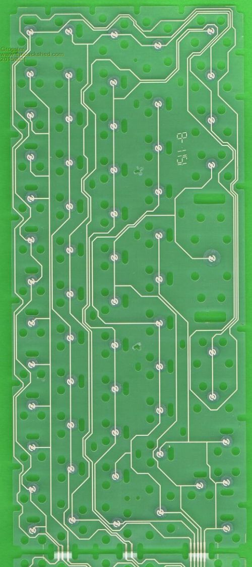

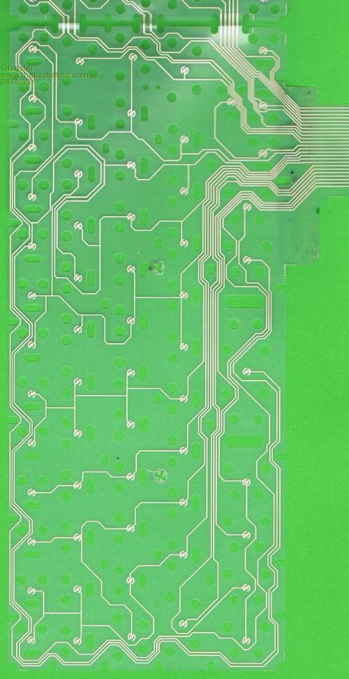

Posts: 10062
Posted: 03:55pm 20 Aug 2015
Yes, last night, as it happened!
Here are some shots:
From what I can see, it would appear to be a 8 x 16 matrix, with the eight on the top layer, and the 16 on the bottom.
The hand-written chart above lists the keycode connections in the CODE column, in a BOTTOM LAYER,TOP LAYER format. Therefore, the ENTER key is CODE 12,20 - meaning lines 12 and 20 will give a closure if ENTER is pressed. There is a normal resistance on this matrix ranging from about 50R through to about 350R for the longest traces.
EDIT: The chart is missing one data point for the ':' key - it should read 12,18.
Pin '1' is the trace closest to the writing on the FPC cable: 'HASKEY.....' etc.
Edited by Grogster 2015-08-22

Posted: 05:51pm 20 Aug 2015
G,
I found some small mistakes in your table.
J and L are both 09,20
F8 and F12 are both 10,15
F10 and F11 are both 12,15
! is missing
: is 12,21 and in your edit it is 12,18
I have sorted a list by row and column.

Posts: 10062
Posted: 06:59pm 20 Aug 2015
UPDATE:
F8/8/* - (10,16)
F12/+/= - (10,15)
J - (09,20)
L - (11,20)
: - (12,21)
Your compressed row/column chart is excellent - that was to be my next step, so thanks.
EDIT: I should warn others reading this, that you basically have to destroy the keyboard, to get it to reveal it's matrix to you, so the one I have been probing is the sacrificial one. I have another blue one, and a couple of black ones from a different trader coming - I hope and expect the matrix to be exactly the same across all colours and suppliers. Wishful thinking perhaps, but I will hold onto that theory for now!!!!
I will now pull apart the other one, and hook up and LED arragement, and test each and every one of those keys on the chart I have, to ensure it is correct before anyone designs anything from it - only to find out I have made another silly mistake! Edited by Grogster 2015-08-22
