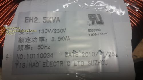

Hi Glenn
The hole diameter is 80 -85 mm. Since my setup is 24v, would I need to use 25mm area cable as your system is 48v? Or do I need to go bigger?
I hooked up a 60w globe and these are my findings. With the lamp hooked in series it didn't come on at at all. .. not even a glow! Some weird like scratching sounds within the toroid when connected and disconnected . Lamp in series in other winding ( inner). Lamp was half as bright.( 132v across lamp)....but this is the weird thing, with the lamp in series on the outer layer and dosent no glow, I connect the inner windings together it comes on bright..confused! Is this a charactist of toroidals or a problem inside? Windings are not shorted as there are separate ohm readings .
I too believe it could be an earlier or maybe different model as yahoo suggests. Took a pic of the old label as for some comparison if you still have yours. May have binned by now!

Posted: 11:56am 27 Sep 2015
Yep looks like there are two possible transformers used by the 2.5kw Inspire's. Either the 240v winding is on the inside, or the outside, of the 130v winding. I got lucky.
Looking at your results. Remember the bulb is acting as a current limiter, we need it to protect things. You did bad things!
When you connected the bulb up and it didn't light, then that was the 240v winding, this is expected. What you should have done then is measured the voltage across both windings and written them down. We need this later to work out the turns ratio.
Bulb in series with other winding, half glow. Thats OK too, its the 130v winding, and by design limiting the voltage across the coil, so the bulb gets about 110 volts. If you measured it, there would be around 240v across the other winding during that test.
When you shorted one winding and the bulb light up. Yep, its a shorted power supply and trying to draw as much current as it can. bad. dont do that.
Go back to your first test, and use a good multimeter to measure the voltage across both the 240v and 130 windings while the bulb in is series with the 240v winding. The 240v winding will be down a couple of volts, this is dropped across the bulb.
For a 24v inverter, you need less turns, thats good, but you should go for heavier wire, 35mm or 50mm ( two 25mm's together )

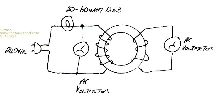

Posted: 01:29pm 27 Sep 2015
Heres a basic test circuit.
Now in this case, because we dont know how many turns are on the primary or secondary, you need to wind a test coil.
Wind say 5 turns of wire ( any old wire ) through the transformer, and connect a multimeter across it. Then connect up the 240v winding like above, with the bulb in series.
Power it up, and take note of the multimeter readings on the test coil, and check the multimeter on the primary is somewhere around 230v, give to take 10 volts..
Say the test coil measured 10 volts, we can work out the ratio's. 10v / 5 turns gives 2 volts ac per turn.

Posted: 03:02pm 28 Sep 2015
ok. Did some testing.
With light in series on 240 windings ( outer) voltage was 222v and the output on the 130v (inner) windings was 124.
With light in series on 130v winding , (inner) voltage was 134v and the output on the 240 was 237v.
With light in series on 240 winding and 5 turns of cable, output was 7.5v.
Hope this enough info to work things out. Thanks for you help.

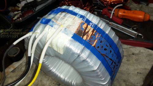

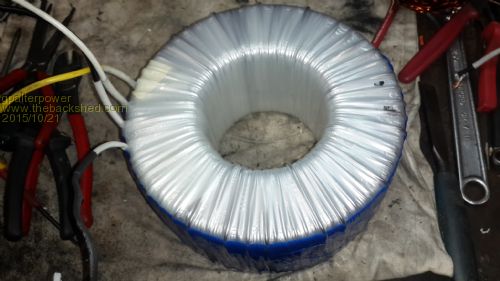

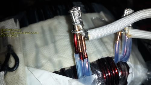

gpalterpower
Joined: 19/07/2009
Posts: 177
Posted: 12:50am 21 Oct 2015
Thanks Gizmo, Bruce and Oz,
Yep... Makes perfect sense to remove the outer winding. It will definately make it easier to wind on the new primary and help with the cooling capability later. Started unraveling it today. There is 2 in hand although they were wound individually . First layer off and I counted 170 turns of 1.9mm dia wire. The hole now is 85mm. After the second layer was removed the hole is 93mm.
Getting down to the nitty gritty and after removing a layer of blue insulation I uncovered a band of copper that is connected to the earth lead ...always wondered where those earth leads went to? Now I understand if there is a fault in either winding will just go to earth. Duh!
After removing more insulation I uncovered the start and finish of the original primary. It is 3 in hand of 2.25 mm dia wire which equates roughly to 12 sq mm.
Im not sure how many turns there are of this but I was wondering if there is some way I could utilise this or part of this 3 in hand wiring to become my new secondary. Any ideas welcome
Oh BTW Oz. It is a 24v system that im building.
Regards Marcus
oztules
Joined: 26/07/2007
Posts: 1686
Posted: 06:52am 21 Oct 2015
So, you have uncovered the 130v winding.... and it is substantial.
Yes you can utilise it if you wish, it is the first 130v of your 240v winding.
From your figures, you are about 1.4v/turn, you need another 110-120v so another 85 turns are needed of two or three in hand... 1.9mm wire.
This will be over the top power wise, but never too much really. 2 in hand will be enough for 3kw.
240/170=1.4v/turn for that core @ 50hz.
For space, if you can peel off one layer of the 130v winding it would not be detrimental for your power, and give you more space to wind the next 85 turns on.
If you were very cheeky, you could split the winding up ( hopefully they are insulated from each other internally). For a 3kw unit I could live with a one in hand 2.25mmm winding. If you were to lose one in hand, and series the other two, you would have 260v secondary, one in hand to use, and more space for your primary.
Primary for 24v would be about 1/16th of your secondary... 260/16=16v .... so 16/1.4= 11 or 12 turns of welding cable.... 50mmsq or more.
If your not going to run this hard for extended periods, this should be sufficient, and save a heap of work..... or strip it all off, and start again with 170 to 180 turns of two in hand for the secondary.. epoxy as you go, and it will be silent as well as virtually indestructible.
Remember, torroids are by far the best transformer, but they are wound with no enamels or other materials in the windings... so vibration is real.
Most torroids ( yes...even in latronics and SME stuff) fail from inter winding breakdown, and arcing. Normal transformers never do.... this is because vibration from the MMF eventually finds a weak spot, and the insulation breaks down. Normal transformers usually fail from o/load because something else has failed... Luckily it is not rampant, but if a torroid is to fail, that will be the usual fault, and the reason for it....... so potting each layer makes a difference to expected longevity and noise.
The copper layer is a shield... less RFI in sensitive equipment, not a safety concern.
...............oztules

gpalterpower
Joined: 19/07/2009
Posts: 177
Posted: 02:59pm 22 Oct 2015
Thanks OZ ,
So there's a couple of way I can do this. The quick way out would be like you say to separate the 3 in hand , series 2 together and disregard the third. I'm assuming that would give me a 3 kw with not much room to spare....... If some one has the toaster on and the fridge cuts in at the same time someone else is boiling the jug for a cuppa....then the inverter IS TOAST. I would like to run the house if that's feasible so Im thinking of just continuing on with another 85 turns of 3 in hand of 1.9. Is that overkill or is 2 in hand enough to do the job and what sort of output could I expect?
Could another way be with the 3 in hand , separate one and wind another say 110 turns in parallel with the single with 2.25 and then series with the other 2 in hand winding. The only drawback is that im only guessing with amount of turns there are and may cause some imbalance and overheating when in a full load scenario. Just a thought!
