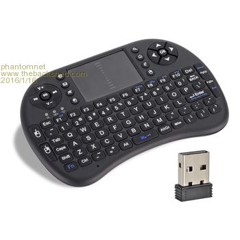

Hi,
Wireless keyboard/mousepad from Ebay (~10 GBP) working with stmF7Mite as keyboard.
Only sometimes it's suspending for a few seconds.
Cheers.
derexponent
Joined: 20/09/2015
Posts: 24
Posted: 12:49am 16 Jan 2016
@phantomnet,
thanks for testing
maybe the release version is a bit faster than the
actual debug version.
i think we should switch to beta befor another year has past

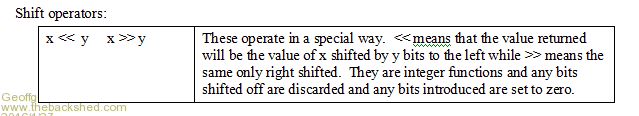

Why don't you use the tokens << and >> for SHL and SHR as used in the Micromite? That would save the users some confusion if they switch from platform to platform.
This is the entry in the Micromite User Manual:

My fault
I just have look at the mmbasic 4.5 version from the manual where was no shr/lhr operator.
Then i just made it 'basic like' and not in C style ...
But it will be do like the Micromite in next version
