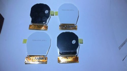

@matherp/kiid
Just for clarification - are the two types of round display now 'working'?
An earlier post by matherp implies the one he was sent would not work BUT I see he has posted a photo of one working??
Another example of how great TBS is at pulling people together to get 'results'. Great work guys and guess the MM SmartWatch will be here soon
Please clarify which round TFT(s) are currently working. Also, what is the sideways viewing angle like??

Posts: 12266
Posted: 10:33pm 30 Dec 2015
  Quote  Please clarify which round TFT(s) are currently working
The driver I have written is tested and works with the R61505V graphics controller.
The issue is that the wiring of the various mounted displays seems to vary. Some purport to be set up for 8-bit operation and have the 8 data-lines connected to pins 9-16 (TFT1P2477). The ones Kiiid has bought should have been like this but were a different variant (TFT1P4967) which are configured for optional 16-bit operation. To use them in 8-bit mode it is was necessary to connect the data-lines to pins 17-24 and also to pull pin 26 (IM0) high). The working display is a TFT1P4967 with the duplicate connections patch wired on Kiiid's PCB.
In general if pins 9-16 and 17-24 are connected together in pairs and pin 26 is pulled high then any of the displays should work. However this is not tested on a TFT1P2477 - if they actually exist .
TFT1P4967 datasheet
TFT1P2477 datasheet
  Quote  Will wait and see which one is the correct one to order
Just because you order a particular display doesn't mean you will get it - ask Kiiid!!! My recommendation if laying out a PCB is to parallel wire the databus as above and to pull pin 26 high - this should(???????) work for any of the variants
Edited by matherp 2016-01-01

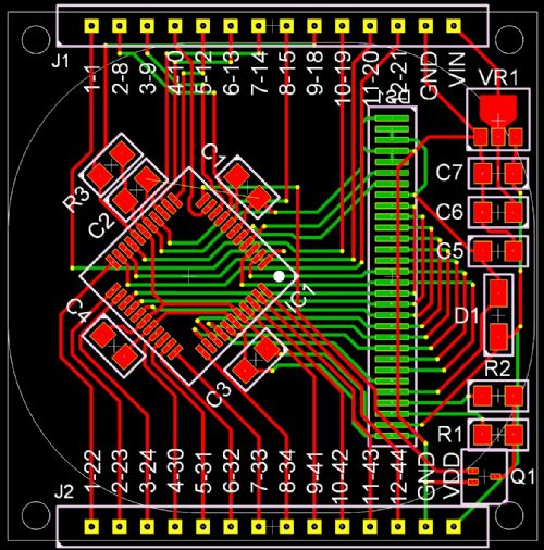

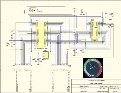

Posted: 05:36am 01 Jan 2016
Ok... 4 round displays on order....
I wanted to get the wiring for the PCB correct, so i think it was said to connect the upper data bus bits with the lower ones in case the display you get is the "other" type... So, I would connect DB0 with DB8, DB1 with DB9, ect.. Then put in a solder ball jumper to control pin 26 "IMO" so as to adapt the interface to use the upper or lower data buss... ??
Other questions:...
Pin 2 and 3 (vcc and IOvcc) get connected together ? (3.3v) ?
CS gets tided LOW, RD HIGH, WR tided LOW...
Whats the "MAX" current for the back light LEDs..? should I use a separate resistor for K1 and K2..?
Does the CFunction code able to function with the 28 pin MM V5 core code..?
Thanks for help on this..! Edited by Zonker 2016-01-02

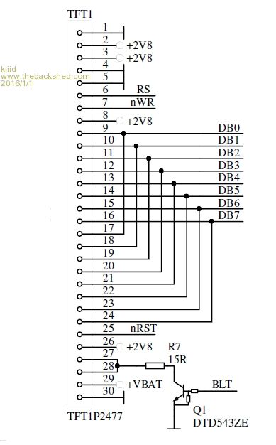

Posted: 07:44am 01 Jan 2016
This is the schematic that should work with both 8-bit and 16-bit displays of this type. IM0 can be permanently high because it is NC in the 8-bit modules anyway.
Note that these displays by specs work with 2.8V supply.
The backlight is better to have two separate resistors, though.Edited by kiiid 2016-01-02

Thanks kiiid for the info..!
I like the PWM transistor you selected... Nice... Has it's own bias resistors inside... (sweet) So, insert 1 diode drop from 3.3v to get there, or should a separate reg be used..? (diode probably ok)...
P.S. - Can't wait to hear news of your up coming PCBA

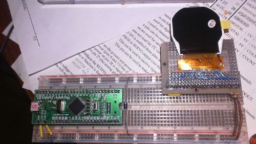

Posted: 06:56pm 15 Jan 2016
Good evening Gents..
Well, the AliExpress order for the round LCD displays came in today.. They seemed in fine condition.. I don't have an FPC connector for them, so I was considering soldering wire wrap wires onto the connector area to get the prototype interface going.. I was wondering if this was a good idea or not, so I thought to ask if anyone else has tried doing this before..? When laying out a PCB, is it OK to just directly solder the display to the PCB, or would using a FPC connector be the way to go..? All the display modules from china seem to directly solder the displays to the PCB's so I guess this can be done... I am currently trying to create a PCB part in Dex for the round LCD... I can't seem to make sense of the PCB pad information in the PDF file but now have the actual display units to check the sizing... If anyone knows the pitch between the pad centers, would be a big help... will be working on it this weekend..
Thanks for any feedback on this...!!
EDIT: I got the Display mounted up and ready for the interface wiring... It took some "Microscope" time to get all the wire wrap wires soldered onto the display..!
Edited by Zonker 2016-01-28

Evening Gents...
Just an update on the round LCD Display controller with 44 pinner...
This is the purposed schematic for the PCB... Pin 10 of the MM will be used as an analog input for a yet to be selected light sensor device... Feedback welcome..!!
2016-02-15_035347_Round_Gauge_MPU.pdf
Posts: 3003
Posted: 06:07pm 14 Feb 2016
Hi Zonker,
Just run my eyes over your schematic.
Pin 28 (Vdd) looks like it is not connected to Vdd. This maybe just a labelling issue - but just thought I'd mention it so you can check things.
Nice simple circuit - and would be interested in a photo of the round TFT displaying something.
WW
Zonker
Joined: 18/08/2012
Posts: 772
Posted: 02:57pm 15 Feb 2016
Thanks WW for the good catch on VDD missing..!
Will get it updated... I think I am going to skip the light sensor on this PCB (getting back pin 10), add it to the J1, bump the rest of the IO's around, and drop the PWM drive out, as it's needed to get pin 10 added to the IO's...
Thanks again for the feedback fine Sir..!
Posts: 3003
Posted: 06:15pm 15 Feb 2016
  Zonker said  ...I think I am going to skip the light sensor on this PCB.... and drop the PWM drive out...
Personally I would keep these two elements in as if I have understood the purpose of this 'module' correctly, it's primary function is as an LCD gauge.
With the number of circuits I have built involving a TFT, the best thing I ever created was the 'auto-adjust' for brightness. Ok, the design has been tweaked over time, but a simple (low cost) LDR & resistor, along with a couple of (low-cost) MOSFETs, is all that is needed to give this 'auto-brightness-adjust' feature.
Perhaps if your 'gauge' is never going to be viewed in a dark environment then you don't really need a PWM circuit and it can sure be dropped. BUT if you are going to view it in various light levels, I would definitely leave your circuit untouched.
The PWM backlight also has the bonus of being able to switch 'off' the display (yes there are other ways to do this too). Initially I used CLS (to black) but in a dark room the backlight 'glow' is still visible. But PWM STOP and the TFT is truly off/dim/dark.
I guess you are not short of PCB real-estate as the handful of components shouldn't take up much space at all. Perhaps at least create space on the PCB to optionally fit the components (assuming you can spare two I/O pins that is!).
The above is just my opinion. Perhaps you should first try a round TFT with CLS (i.e. nothing on the display) and then view it in the dark. If the observed 'brightness' of a blank screen is ok (and the current drain not too high), then free up pins 10 & 11.
WW
Zonker
Joined: 18/08/2012
Posts: 772
Posted: 06:02pm 16 Feb 2016
Thanks WW for the feedback..!
I am trying the keep the board tight, and the corners will contain the mounting holes... I will be keeping the PWM drive on the display, but don't see any "small" LDR's out there... I did find a light sensor IC (Avago APDS-9007) that should work with the analog input. The PDF file is to big to post... That got me to thinking if sensing the light level at the gauge is the best thing to do... Not sure yet... If you know of any light sensors of the small type, let me know
Zonker

Posted: 06:13pm 18 Feb 2016
Evening Gents...
Just a quick update... I haven't got the board dressed yet , or tried any copper pours, ect.. But at least finished the routing...
The red copper is the bottom of the PCB with header pins facing at you, using 1206...
Edited by Zonker 2016-02-20
Posts: 3003
Posted: 06:48pm 18 Feb 2016
Hi Zonker,
Looks good to me.
I notice a 'net' linking C2 to GND in your image, but can see what appears to be a track to ground so not sure why the 'net' is showing itself.
Glad you kept the PWM; and having Pin 10 on the header will allow for an 'external' LDR option to be positioned appropriately.
What are the dimensions of this fine looking PCB?
WW
