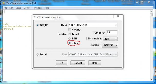

Posted: 11:40pm 25 May 2016
  MikeO said   Totally agree with Matherp. I have been using this program very successfully for some time, see my earlier post. One caveat, whereas MMEdit chat communicates fine I usually use Teraterm in conjunction with MMEdit and I could not get Teraterm to work reliably in this case (I have used Teraterm over TCP/IP previously ok).
Mike
Hi Mike,
I also had issues connecting to it with Teraterm.
It would connect, then drop me back to a prompt which was not the MMbasic prompt, but a prompt that talked to the ESP8266.
Got it working fine now & all I changed was service type in the Teraterm connection setup.
Don't know what it really means, someone else can maybe explain.
Cheers.

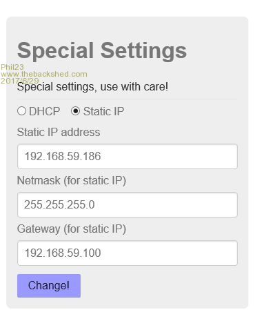

I've got 3 sitting about now, on different devices.
All working fine, with just the occasional hiccup.
I still do on odd occasions try to connect to one & find it at the ">" prompt I'd mentioned above.
Done a few searches, without any luck.
A reset always gets them going again, but not possible remotely.
Does anyone know of a command that can be issued from that ESP-Link prompt to get the device active again?

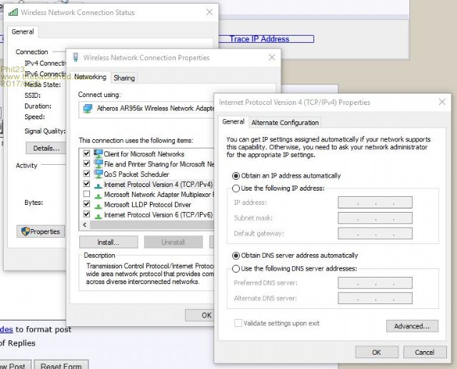

I'll try and explain it a bit, but not quite sure of your understanding of networks.
You flash an ESP & it reboots.
It is then acting as an access point, bit like a router, but it can't supply an internet connection.
You connect to it with Wifi, it's IP address is 192.168.4.1.
It will set your PC to something on the same subnet, with an IP address like 192.168.1.2, where the bold bit indicated the subnet.
You can then get it to find your real router, and connect to it.
At this point the router gives the ESP an new IP address on the same subnet as the router & all your other PC's.
In my case it gives the ESP (by my choice, & another topic), 192.168.59.181.
My laptop is 192.168.59.21 & my desktop 192.168.59.11.
So now all devices are on the same subnet, the bold bit, and they can all talk.
Not sure if I'm helping or confusing the matter, but understanding networks & IP addressing should help.
Phil.

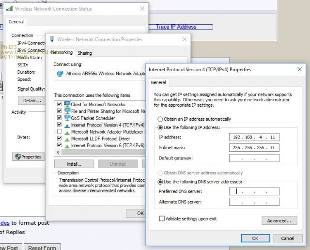

Dave,
Even if you have not internet access, you can still, as you wish, connect to the Micromite with the dongle & the ESP.
The catch is it's usually the router which assigns an IP address to both the PC & the ESP once it goes into it's station mode.
If you have no router, then by default once the ESP exists it's AP mode (where it's providing the PC an IP address), there will be no device present to supply IP addresses.
So you will need to set the IP addresses manually yourself.
Bit like this.
In your case I'd be setting the PC to say 192.168.4.11 and then giving the ESP an station address of 192.168.4.1. (So it has the same IP when it switches to station mode).
Neither the PC or the ESP will need a gateway address, as that is the address of the device that connects to the internet.
So once all that's done, you will be able to connect to it In MMedit with 192.168.4.1.
The thing to understand here is that the ESP has 2 modes.
AP mode; where it gives your PC an IP address, and you configure it..
And Station Mode, where it expects some other device to give it an IP address.
So by setting your IP's as static, you will be able to connect to it in both modes.
I've got 9 ESP's running here & they are all have Static IP addresses.
192.168.59.181-189.
They connect to Micromites 1-9.
So all I do is choose the appropriate IP to connect.
And with Teraterm, I can have multiple copies open, each monitoring a different device.
Phil
Phil23
Joined: 27/03/2016
Posts: 1667
Posted: 10:38am 29 Jun 2017
This is what you need to reconfigure on your PC,
The IP4 settings.
Phil.
davematt
Joined: 27/09/2011
Posts: 55
Posted: 02:28pm 29 Jun 2017
Success!
Many thanks Phil. Setup exactly as you suggested and now working just fine.
What a handy little widget!
Cheers, David
