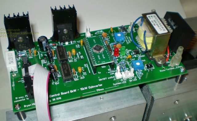

there is a led next to the 12mhz crystal on the control board
there will be a separate parts list if you build a fan controller
the 4410 TO-220 is a buy in bulk and check/grade them for the inverter.
I think you are still short some of the other items on the power board

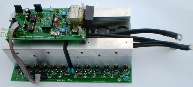

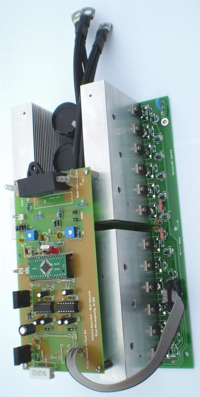

photo:Clockmanfr

Yahoo2, that is the Overtemp On/Off model.

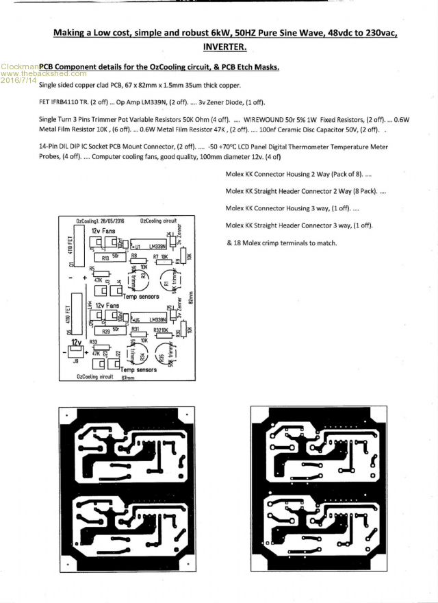

This is my latest Mid July 2016. Pin 6 on/off amendments. But those 2 off TIP35 now have Heat sinks.
I will re-print the PCB Supplement glossy photos to show the New.

OzCooling board and list.
Not sure if these images are coming out here?

thanks clockman. I see an extra led and the jumper pins have moved as well.
I was using the photo to mentally tick things off Phill's list.
I noticed Oz had put a heatsink across both TIP35 and I wondered if they had been shuffled around on the PCB so they line up.

Yes, both TIP35 on that new board, now line up.
I have put these heat sinks on, readily available and cheap.

The Listed 13V Zenner ( 1 x 13v (1.3W) Zener Diode, BZX85C5V6 ) Can it be given a link or explained as I can not find anywhere where it can be bought. Take the 13V out and its easy. Is the 13V a typo for 1.3 or can it be explained further
the part number looks wrong, that is for the 5.6v zener. I would change it to BZX85C13 and do a search.
yes it is right, we are getting 12 volts from the TiP35C transistor in the top left corner of the PCB, the 13Volt zener and the 10K resistor help make it happen and that 12 volts is routed to Vss (pin 13 and pin 9?) on both of the IR2110.
I think the IR2110's have the only 12 volt connections on the board. Everything else is 5 volt from the other TiP35C.Edited by yahoo2 2016-07-17
