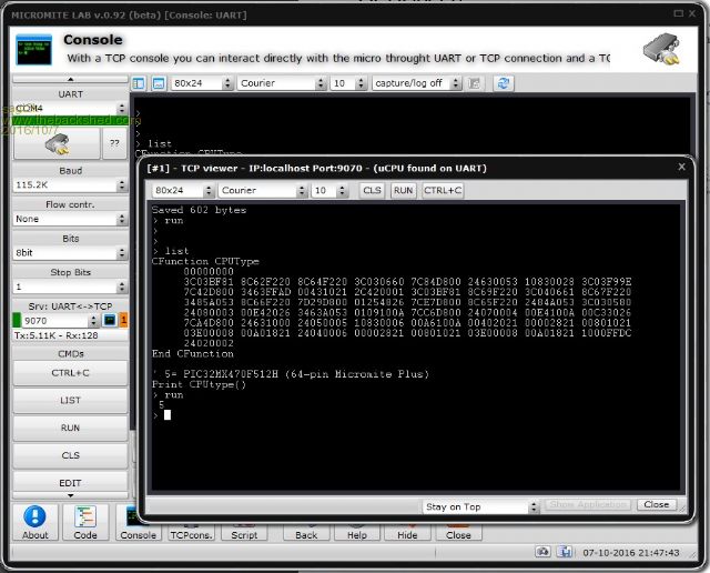

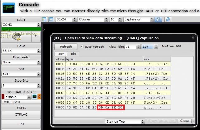

Matherp... anyway, In form console there is a combobox "capture/log off". If you choose "capture on" and after goto in BIN sheet and check "auto-refresh" we can see what happen.

  Quote   check "auto-refresh" we can see what happen
I can't find an auto-refresh checkbox - which page is it on?

I confirm that to send/receive the code, first send 0x03 and later 0x0D 0x0A, and wait after 0x0D 0x0A 0x3E 0x20 as in image ...

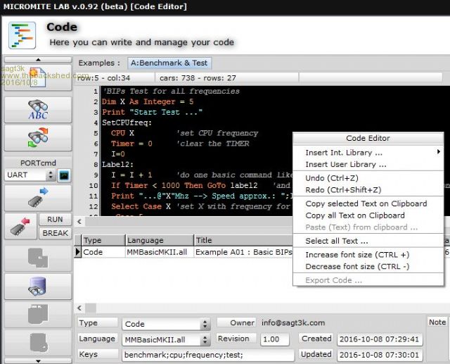

Posts: 12030
Posted: 08:52am 07 Oct 2016
Everything works in the console window: memory, list etc.
The problem is that nothing works in the code window - I just get the "not connected" error

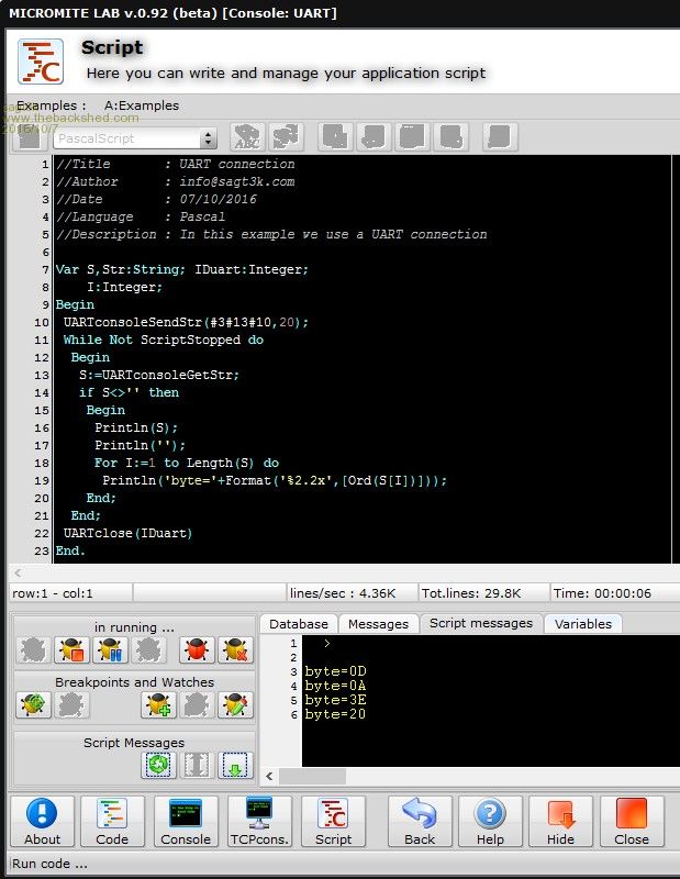

... or we can do this test. Just get connected CONSOLE (with green light) and try this script...
...Go on SCRIPT to create a new one
, choose PascalScript and
...write the code ...and start the code
after goto to the SHEET script messages ...
Here the code .. and the image of SCRIPT module ...
Var S,Str:String; IDuart:Integer;
I:Integer;
Begin
UARTconsoleSendStr(#3#13#10,20);
While Not ScriptStopped do
Begin
S:=UARTconsoleGetStr;
if S<>'' then
Begin
Println(S);
Println('');
For I:=1 to Length(S) do
Println('byte='+Format('%2.2x',[Ord(S)]));
End;
End;
UARTclose(IDuart)
End.

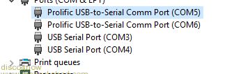

disco4now
Joined: 18/12/2014
Posts: 1157
Posted: 05:30pm 07 Oct 2016
I have narrowed it down to my Prolific USB to serial adapter.
These don't work with W10 unless you go back to and older Win7 driver. I have been using them OK with everything else but MicroMiteLab wont load code with them.
The FTDI USB adapter works OK with MicroMiteLab.

Posts: 6624
Posted: 06:44pm 07 Oct 2016
@Gerry,
Prolific did a few strange things in an attempt to combat fake chips. It has caused many issues, just like FTDI.
I have fired up my 100pinner with the CP2102 converter and it all works happily.

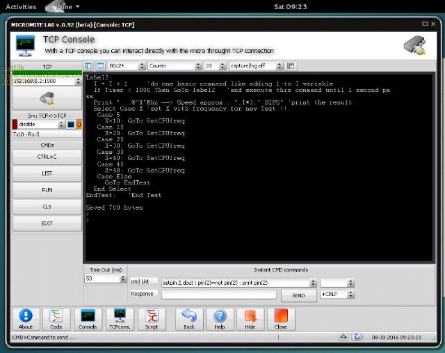

MicromiteLab is fully compatible with Linux/Debian through WINE.
For now in TCP / client, I just have to solve the problem of convert and read the regedit/wine and communicate properly with /dev/ttyUSBx in COMx.

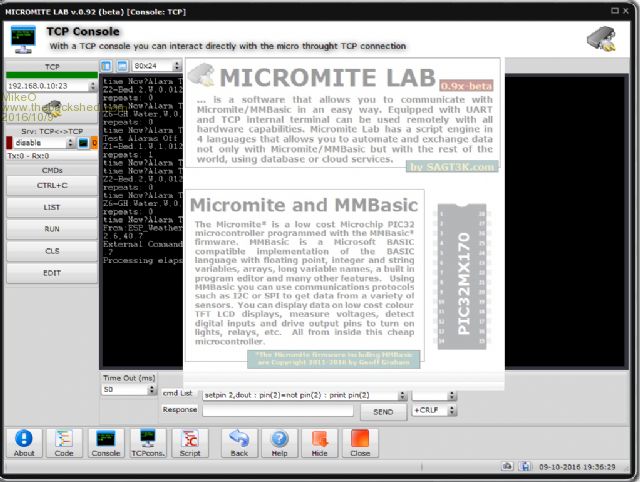

I had this "bad behavior" experience when starting up. This information page didn't close and remained as the top of the application, in fact on top of any application I opened even the browser and the backshed page I started to write this report. I could not close the Microlab application normally i had to use the task manager.
I am using Windows 10.

@Gerry and all Prolific users:
Did you tried this Family Software Driver?
This driver worked for my Win10 computer...
Frank
disco4now
Joined: 18/12/2014
Posts: 1157
Posted: 12:59pm 09 Oct 2016
Hi Frank,
I have this downgraded driver installed, it works for other things, but MicroMiteLab wont load code using it, but console is good, same situation as reported by Peter but not sure if he has ProLific drivers or not.
Thanks for the link, it is a bit simpler than the path I initially took to get the downloaded driver to stick.

sagt3k
Joined: 01/02/2015
Location: Italy
Posts: 313
Posted: 08:13pm 09 Oct 2016
In order to help me to understand, who have problems to up/download code, could You follow these actions? And let me know?
  sagt3k said   ... or we can do this test. Just get connected CONSOLE (with green light) and try this script...
I:Integer;
Begin
Begin
if S<>'' then
Begin
Println(S);
Println('');
End;
End;
UARTclose(IDuart)
End.

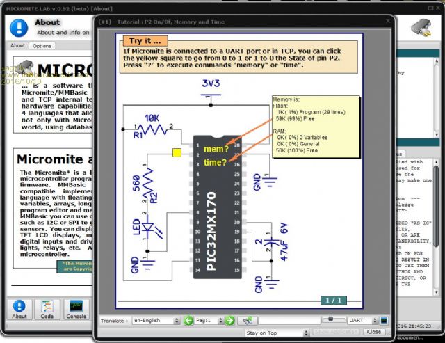

Posted: 10:12am 10 Oct 2016
Hi to everybody
To continue with the MicromiteLab's features you can follow interactive tutorial. Through the interface You can interact directly with the hardware.
Here you can download a little tutorial MicromiteLab Tutorial 0001
