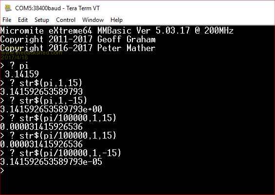

Posts: 11949
Posted: 01:29am 18 Apr 2017
Hopefully right this time
Minor changes but possible issues - please let me know if you find anything strange
New feature:
You can use a negative number in the str$ function to force conversion into exponential format as in the picture
Bug Fixes:
This release fixes the bug in outputting more than 10 significant digits after the decimal point in floating point numbers using the STR$ function
It also fixes a bug in the GPS(longitude) function
In order to fix the first issue it has been necessary to move to the latest version of the XC32 compiler (V1.43) and the latest version of Harmony (2.02b) so there may be bugs that have been introduced (by Microchip) even though the code hasn't changed.
Attached is the latest release 5.3.17 for the 100 and 144-pin parts
2017-04-18_111823_MMX5.3.17.zip
And for the 64-pin part with same bug fixes
2017-04-18_111901_MMX645.3.17.zip
cdeagle
Joined: 22/06/2014
Posts: 269
Posted: 02:18am 18 Apr 2017
The new DATA statements with Peter's new STR$ function (first line) and Jim's eformat function (second line). Note that several numbers using eformat$ do not include the exponential part.
Thanks Peter and Jim.

The READ statement for DATA works for data formatted as STR$(x, 0, -14) but not for data formatted as STR$(x, 0, -15) or STR$(x, 0, -16).
Computer programming is a lot like the monkey making love to the skunk. He hasn't had all he wants, but he's had all he can stand!
Posts: 11949
Posted: 06:23am 18 Apr 2017
  Quote  The READ statement for DATA works for data formatted as STR$(x, 0, -14) but not for data formatted as STR$(x, 0, -15) or STR$(x, 0, -16).
That one was deep in the guts of Geoff's code. There was a limit of 20 characters for a number literal that wasn't obvious. I've now upped that to 30 which should fix it

  cdeagle said   The new DATA statements with Peter's new STR$ function (first line) and Jim's eformat function (second line). Note that several numbers using eformat$ do not include the exponential part.
Now to confirm that the READ statement works with Peter's exponential format.
DATA -1.9509150490455762e+04 , -1.9101597562906206e+04 , -5.3792389600437023e+03
DATA -1.9509150490455764.e4 , -1.9101597562906204.e4 , -5.3792389600437024.e3
I deliberately left the exponent off for an exponent of zero.
I am more concerned with the second decimal point - the one at the end of the mantissa.
I will try with a few different versions of MMBasic and see which ones it occurs with.
