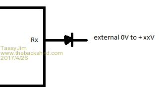

When I want to isolate the comms lines to prevent voltage on the Rx line backfeeding the 3.3V supply, I use a diode in the Rx line and allow the internal pullup to do it's job.
It would work for any positive voltage on the Rx line and still pull it down close enough to zero.

The diode I suggested above should resolve your problems.

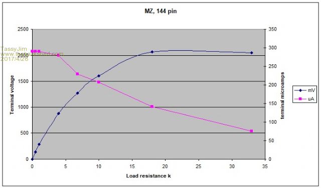

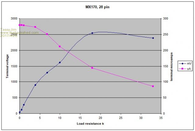

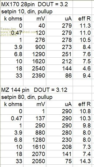

I found time to do a couple of tests.
I tested on a MMX 144 pin board from WW and a 28pin backpack board from BigMick (one of the original ones with the DIL chip).
I setup each mite with a resistor from the pin to ground and measured the pin terminal voltage after issuing
SETPIN 80, DIN, PULLUP on the MMX and
SETPIN 10, DIN, PULLUP on the MX170 28pin mite
In both cases, the chosen pin was one that also gets used as a COM Rx pin.
On the MX170 a SETPIN 10, DOUT gave a reading of 3.20V and the same on the MMX gave 3.12V due to the slightly different supply voltages
This table shows the results for various values of load resistor ranging from zero to 33k ohms
Columns are
load resistance in k ohms,
measured voltage pin to ground in milli-volts,
measured current out of the pin in micro-amps,
calculated effective internal resistance in k ohms
The two graphs don't show the effective resistance.
The battery on one of my meters went flat just as I finished the MX170 so no further tests were done.
My conclusion.
Both the MZ and MZ chips have very similar pullups.
They both current limit to about 290 micro-amps.
If you are relying on a resistor to pull the input to ground, 1k is the largest value that works reliably.
