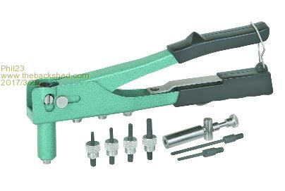

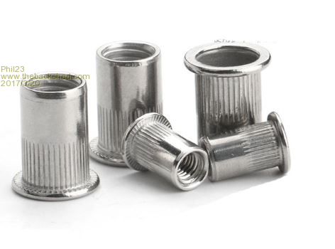

Slightly off topic, but I've been meaning to get one of these; instad of borrowing it occasionally.
A lot more things would get assembled better if I had a kit on hand to make treads for stand-offs etc in cases.
Rivet Nuts.
The guy that owns the one I've borrowed says it's a very well used tool in his workshop.
Phil.
Nut Pack.
Tool.
Bill7300
Joined: 05/08/2014
Posts: 161
Posted: 12:56pm 20 Mar 2017
I have one Phil, although a different brand and mine came in a kit with steel nuts rather than aluminium for which I really have far greater need. As a result, I have only used mine once in about 15 years. I really must re-equip with aluminium. I note though that the Nut Pack link you quote is somewhat confusing in describing the nut pack as Stainless steel M... aluminium?
Bill

Phil23
Joined: 27/03/2016
Posts: 1667
Posted: 04:14pm 20 Mar 2017
  Bill7300 said  I note though that the Nut Pack link you quote is somewhat confusing in describing the nut pack as Stainless steel M... aluminium?
Yeah,
Just grabbed the first link that listed appropriate sizes, didn't notice that bit of it. Haven't ordered anything, but will watch out for such errors.

Posts: 2209
Posted: 03:50am 21 Mar 2017
I have used those rivet nuts a lot in my days when i built camper vans. They work great and small versions could be used for pcb's and enclosures.

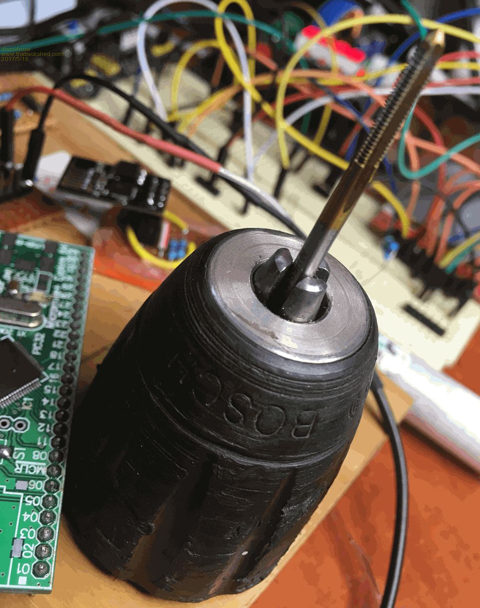

  Grogster said
  disco4now said   I ordered this one to see what they are like.
Could not help myself
Gerry
BUMP!
How did you get on with the one you ordered, Gerry?
Did it work?
Well it took me a while to find it. I tapped a couple or threads in 3mm aluminum and they seem ok. The tap is HSS so that OK, but when I look at the ebay listing what they have sent is not what is shown. They sent me a normal tap not the thread forming one they show. Should have had a closer look when I go it. Could be an honest mistake but not much I can do about it now, even if I noticed at the time with the return postage it would have not been worth trying to get the correct one.
So sadly I cant say how one would have worked. Found a use for and old drill chuck though
Gerry
