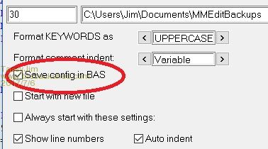

Curious Jim,
What do these first lines of your latest code do?
I can make an assumption.

  Phil23 said   Curious Jim,

In MMEdit, if you have the option set in preferences,
The syntax and port settings are saved in the BAS file.
I should have removed them before posting the code.
I find it useful when I am playing with various devices at the same time. Switching code automatically switches the port settings for me.
The config line doesn't do anything yet.

Phil23
Joined: 27/03/2016
Posts: 1667
Posted: 01:37pm 06 Jul 2017
Thanks Jim,
And yes, very useful.
Often miss changing the connection IP when I switch devices.
I just set that option, but not sure where to go from there.
Should MMedit write those 4 line into the beginning of the code,
or do I need to paste them from elsewhere..
Phil.
Posts: 6621
Posted: 02:43pm 06 Jul 2017
MMedit will attached the config lines each time the code file is saved.
That means that the port settings and syntax file will get updated if you open the file, change the settings then save again.
If you use the same basic code for multiple devices, you will have to keep changing the port.
For normal use, forget about the added lines. Opening the file in another editor will have them as comments and if you leave them alone, they will still be correct when you open the file in MMedit again.
If you open a file that doesn't have the config lines, MMedit will stay with the current settings.
