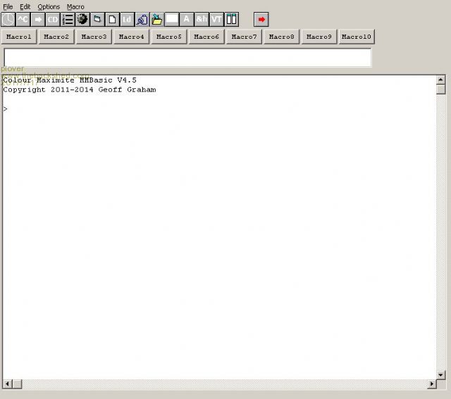

The situation is now 3 points to MMedit and -1 point to TeraTerm arrived at as follows.
I am getting better at controlling the wine com links and when connected to the Maximite using MME I have now reliably used 'MM Files' to look at files on the SD Card and some of those files sent to MME edit window on PC.
If I open 'MM Chat' I now get a Banner, see pic below, this I think indicating that MME is working pretty well with the Maximite, and I know I have got the correct version of Maximite basic syntax set up, banner tells me it is ver 4.5
I can reliable open TT, but the Banner seems to double up or partly, perhaps as it is doing a double connection beyound me at the moment. The basic prompt '>' will show but typing any character is more than hit and miss.
In the pick below there is traces of the banner, I changed speed from 4800 and up, connection is not lost only lots of information gets lost.
I am awarding -.5 points as I think I have tried to change almost anything in the TT that can be changed (exasperation taking over my logic). I also believe the VT terminal in MME does a better job than TT.
I think I am coming to the conclusion that for me running Linux the best connection method will be MME. In a much older thread of mine where I battled initially with setting up in linux (PCLinusOS) and made connection with other terminals I seem to come to the same conclusion.

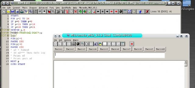

Now I have connected to the Mup-v2 with MME. If I use "MM Chat' I will get following picture.
In MME I have a program from BigMiks manual for the 19 LED test board piggy backed on the Mup-v2. The chat window when opened is empty and I expected a Banner? Am I wrong in my expectations?
The Mup-v2 actually has the program installed, using the 'list' command will print the listing.
I would like to know what version is actually flashed here. I think I have just about gone through all the syntax settings for the Micromite thinking that maybe only when the syntax matches will the banner show (I don't think I believe that either)

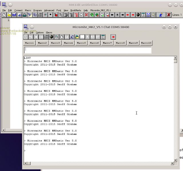

The banner only appears when the MM is first powered up.
PRINT MM.VER gives you 5 or 5.0 so you have version 5.0 installed.
If you can remove and reapply power to the MM without removing power from the USB-TTL converter, you will see the sign-on banner.
If the board has a reset button, you will see the sign-on banner.
If you unplug the USB while the Chat window is open, you will probably have problems.
The maximite behaves differently due to the inbuilt USB. It is also not a good idea to unplug or reboot while a program is talking to it.
JimEdited by TassyJim 2017-07-18

I am not thinking straight, it was first when I read your post that I pursued looking for 'Reset', I did remember that the board had ICSP connector. That should have emphasized in my mind there would be 'RST' or reset pin. Sure enough despite having a piggy back over over the DIP 28 covering pin 1, reset, this can be implemented on the ICSP which is right at the edge of the board.
I do have easy access to the pin 1 on ICSP, via simple mini EZ hook I can short to ground. See the blink on the MuP-TTL converter and Banner flips up. The mouse pointer shows on the snippet:
I have a mess on my desktop, a simple breakout USB board I used on the gas analyser to get access to the USB D+/D- lines, lying very close to the MuP-v2 board. Without me noticing the test lead on the reset pin flipped the bare end under the USB break out board and any little shake when moving the mouse actually produced a reset.
That is the cause of the repeated Banners. Need to tidy up the MuP-v2 either on a heavy base or a box.
I will also pay a bit more attention to unplugging the micro or USB connection while Chat is open, I overlooked this, could well count for a number of my failures to connect. Starting to feel comfortable with tracking down the problems. I still have an option to look at the registry work in your link some posts back. I am wondering what exactly this did, not clear to me.

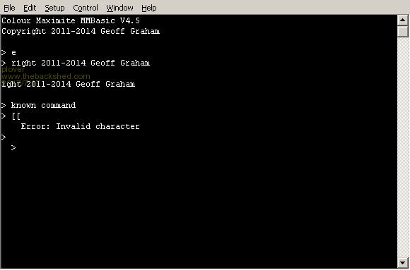

I had downloaded the TT 4.95 hoping it would make a difference. Got it running but same problem can only get COM1 and COM2 and I want to run on COM5 in this exercise. Starting to wonder if I really need to install on a Windows 7 machine to test, that is hurtful
Funny, I started up the TT 4.88 using the forced COM5 mode. Connected to the MuP-v2 I did a reset, got perfect Banner.
Sorry must try and trim the pictures.
First action, reset, gets me the Banner and prompt '>' then I typed 'list' and got the second response.

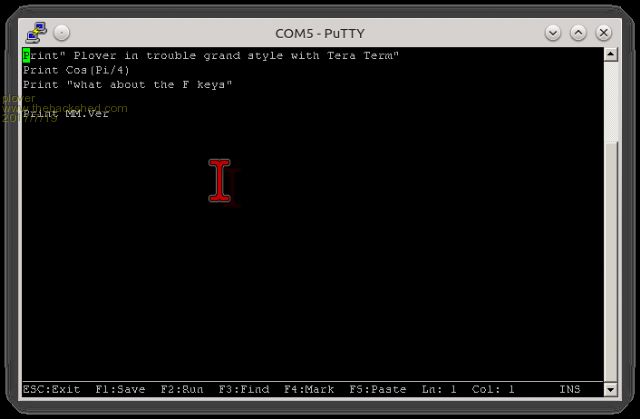

I have shown the Edit mode and the F keys work. Again I am working with my KDE 5 Plasma system and will go back and install Putty on the workhorse.
Now I should start thinking about running programs. The preferred procedure is: Use MME, a real dream, Putty as simple checking tool.Edited by plover 2017-07-20
