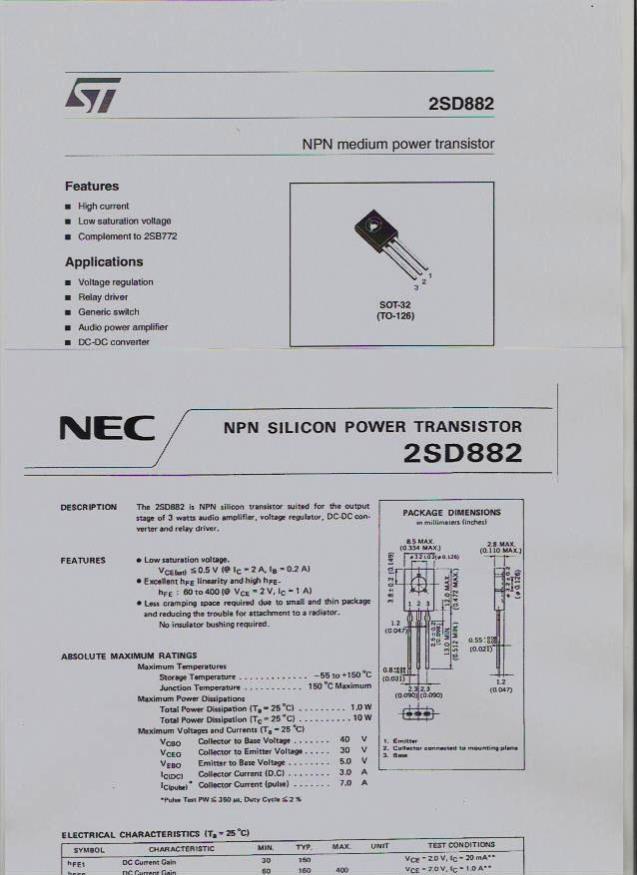

That ST data sheet is different from the NEC data sheet?
Cheers Aaron
Off The Grid
Posted: 08:56pm 14 Jan 2018
  Revlac said   That ST data sheet is different from the NEC data sheet?
Yes, other data sheets have the pins going the normal way with one on the left, and three on the right.
http://www.alldatasheet.com/datasheet-pdf/pdf/77279/NEC/2SD882.html

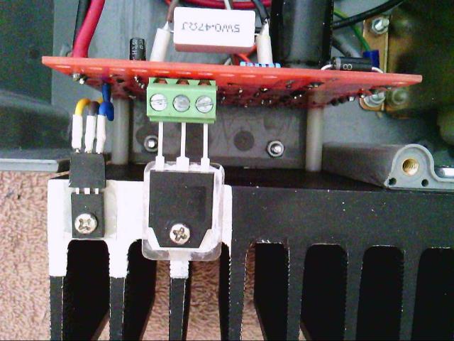

Yes definitely IC sockets, and screw terminal block for the big mosfet.
Hi Warpspeed,
I like your mounting idea for the mosfet.
The screw terminal you are using here looks like the pins through the board and where the wire (mosfet legs) connect in are in the same direction i.e both vertical , with the screws coming in at 90 degrees. I can't seem to find any like that, do you have a source for them.
Gerry
F4 H7FotSF4xGT
Posted: 12:26pm 06 Feb 2018
Gerry, Altronics sells them. You can get 45 degree entry as well. just make sure the terminal spacing suits the Mosfet leg spacing.

Posted: 01:00pm 06 Feb 2018
Klaus has nailed it.
Altronics P-2065A (ninety degree three way)
