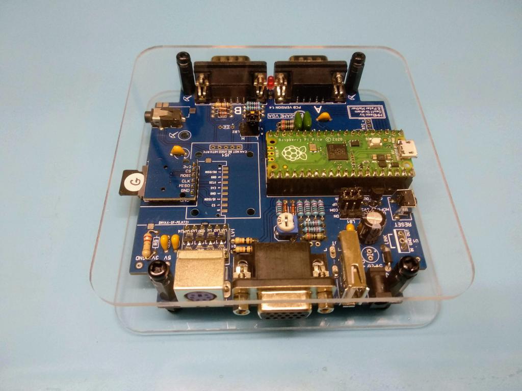

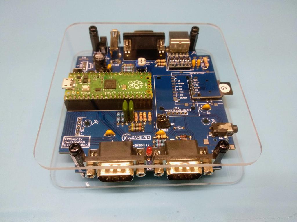

PicoGAME VGA 1.4 (by @Mixtel90) in acrylic enclosure (by @bigmik):
My thanks to both Mick's, I am very pleased.
Posts: 3888
Posted: 01:47pm 28 Aug 2022
I haven't looked into this PCB. What is the USB connection between the VGA connector and the power jack?
Posts: 4410
Posted: 01:54pm 28 Aug 2022
  lizby said  I haven't looked into this PCB. What is the USB connection between the VGA connector and the power jack?
5V out, specifically to provide power to a VGA => HDMI adapter ... or charge your mobile phone.
I believe on the 1.4 board it can be hacked to provide an alternate power in too (by convention the adjacent power jack is used), but I don't think that is so easy/possible on the 2.0 board (still unconstructed).

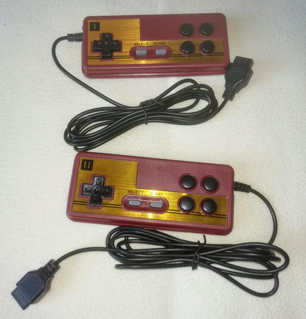

Due to other responsibilities I'm largely on a break from the Shed at the moment but I did have a chance to test another pair of "NES/Famiclone" gamepads that dropped through the door:
These seem usable if you can put up with the gold and maroon colour-scheme. They still exhibit the "Right = 129 if you don't send an extra clock-pulse" issue that seems common to all (?) the modern clones (which is easily worked around in software, just send the extra pulse) but most importantly they do not have wonky D-pads.
Internally they are the usual epoxy blob and nothing else, though for variety they have a white blob, at least the one I opened did.
The listing I ordered from was:
   https://www.aliexpress.com/item/32803427153.html
But caveat emptor.
