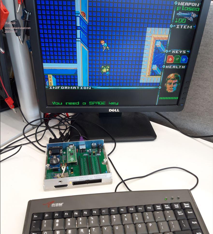

Oh no... Sorry Martin...
Could you please try to re-make your changes. I will stop any work from my side until I see your fixes, and use that as new baseline.
This is probably result of going back and forth with the pet24cMod.bas and pet24eMod.bas around Kevin's changes.
I sincerely appologize.

Posts: 6171
Posted: 10:40am 17 Nov 2023
@Martin,
I am going through your changes, and do not understand at all...?
1/ you removed OPTION DEFAULT INTEGER. Why...? Now the whole game is running in floating point..? This could have significant impact.
2/ you moved "DIM col(15) and fill" to the beginning, where it was part of init_map_support that is called right at the start (before that only some GPIO stuff happens for controllers). This should not have any impact.
3/ you replaced the call to "SUB config_NES" with the content of that function that is line for line compatible. This should not have any impact.
4/ You reverted the change in the startmenu that made the ticker tape (top banner) roll slower. You did not like that one ? I found it more readable when slower. OK, lets keep the faster ticker tape...
Please check if attached works equally well.. (and destroys pot plants).
pet24fnh.zip
Edited 2023-11-17 20:55 by Volhout

  Volhout said  @Martin,
again right at the Start
[281] Pulse a_latch, pulse_len!
Error : Pin 0/NULL is not an output"
so it calls the controller routine before its initialisation,
thats why i moved the initialisation, which just sets up the Variables and the PINs for the Controller, to the start of the Program.
somehow i forgets the settings when they are setup within the sub .
Edited 2023-11-17 22:03 by Martin H.

Posts: 6171
Posted: 12:53pm 17 Nov 2023
If found the culprit....
In lines 1773...1776 replace the keyword CONST with DIM
Apparently a CONST variable defined in a SUB is a local variable, not a global variable. So it cannot be used outside that SUB.
I am not sure if this is a feature....or a bug....
It is not in the PicomiteVGA user manual. I'll have to ask Peter...

Posts: 6171
Posted: 01:07pm 17 Nov 2023
Hi Tom,
For now I will make this change permanent (CONST->DIM). Then Peter has choice of fixing or not. And we can continue with the development.
I hope we now have a new baseline, that will satisfy everyone.
pet24g.zip
This should be identical to pet24fnh.bas with
- CONST changed to DIM in the SUB config_NES
- the slow ticker in teh startup screen
P.S. Martin, thank you for your patience. I really appreciate it.
