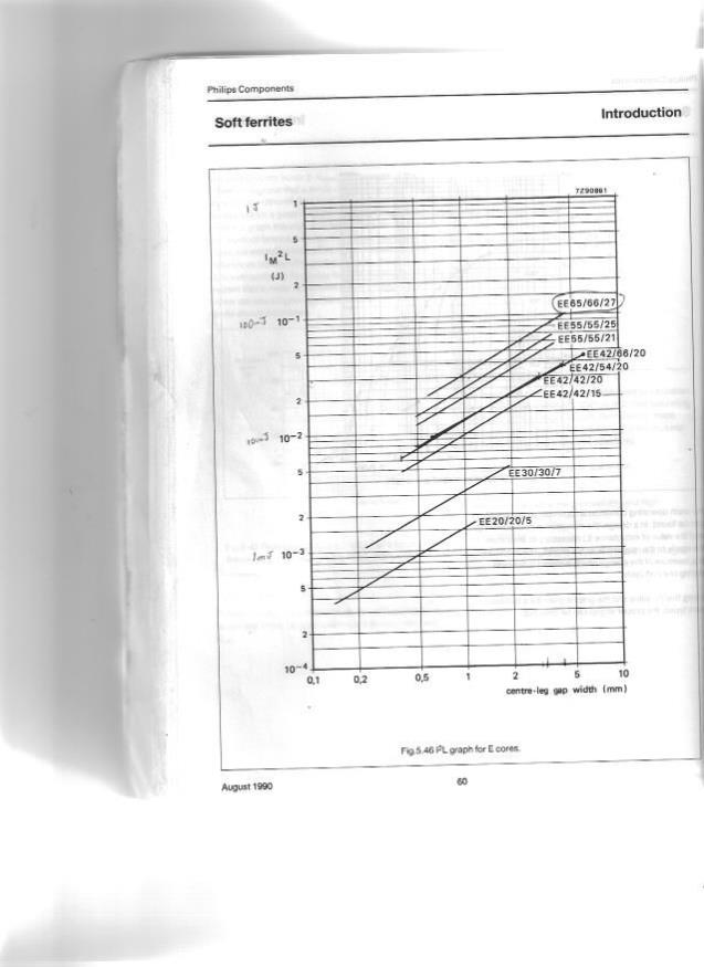

Posted: 11:16pm 17 Mar 2019
  ltopower said
The current single 50uH ferrite approach (E65, ground 0.5mm gap, AL 1214, 6.5 turns = 51.2uH) will saturate around 51 Amps. Ok for upto 2.5kW.
Are you sure about that ?
Agree that Al about 1214 with 0.5mm total gap.
Agree that 6.5 turns = 51uH at zero current, although half turns are not a good idea.
Problem is saturation.
You won't get 51uH at saturation.
At full theoretical saturation inductance is effectively zero, or at least very much less than at zero current.
If you want a choke that works, you need to stop when the inductance begins to fall off, not at full saturation.
The book of words (Philips soft ferrites 1991) says L x I squared 20mJ of energy storage for EE65/66/27 cores with 0.5mm gap. That is not a lot.
You are claiming 51uH x 51 amps x 51 amps = 132.6mJ which is slightly above 20mJ

Posted: 12:23am 18 Mar 2019
Thanks for the help, basically, no, I'm not sure.. still on the never ending learning curve. Very interesting page.... thanks, bit more clear now.
Ahhhhhhhhh moment.....
They provide I/A in the spec. 0.27.
So csa min of 529 = 529 x 0.27 = 142 Amps / 6 turns = 23 Amps per turn...
6 turns = 43.7uH @ 23 Amps = 23mJ... ????
Is that how it works ? Feel like I'm back at collage 30yr ago, hahaha..
https://www.mag-inc.com/Design/Design-Guides/Inductor-Design-with-Magnetics-Ferrite-Cores
The AL figures are from TDK data sheets.
E65/66/27 ? Have not seen that core yet.. I'm using TDK B66388 E65/32/27 data sheet.
The formula for the gap I am using is :
gap =((4 * PI() * 10^-7) x uH x Amps^2)/(Bmax x 2 x Ac)*1000000
Bmax = 320
Ac = 529 (Ac min for the E65/32/27)
This is not taking into account a cliff edge... the inductance falls of though, 2nd ahhhh moment, Bmax is frequency based... (or an ahhhh s** moment).
So I/A in the spec overrides the formula or the formula is worng/invalid..
Posted: 01:13am 18 Mar 2019
Energy stored in a capacitor increases at a rate of voltage squared.
Energy stored in an inductor rises at a rate of current squared.
So the energy storage curves are always given in units of inductance x current squared.
So 43.7uH x 23amps x 23 amps = 32.163 mJ
As you put on more turns, the inductance rises in proportion to turns squared.
Saturation rises with ampere turns so is proportional to the turns.
If you do nothing to the gap the stored energy remains the same.
