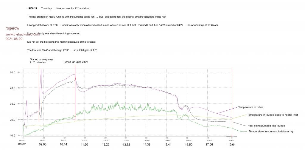

  Warpspeed said  There seems to be a pretty consistent and usable temperature gain every day.
How is the big system coming along?
Yes, still happy with the way it adds some heat most days.

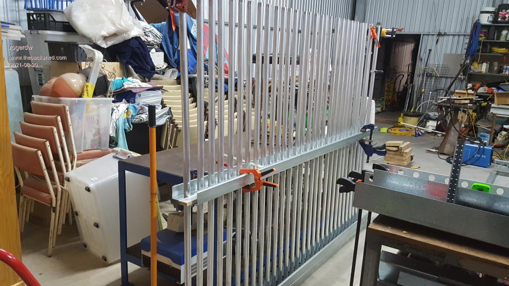

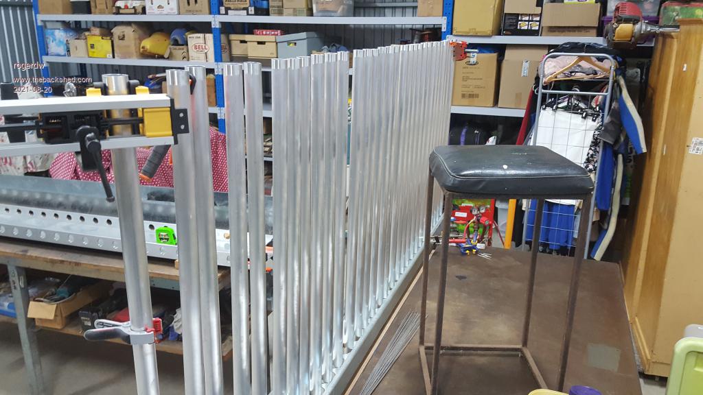

Progress is pretty slow with the big one. I have all the tubes cut to length and last night I drilled and tapped all the holes to screw the floor into the cold inlet duct
...  and my next job is to weld all the tubes into the angle.
I've set it up so I can sit up on a bench and do the welding horizontally.
A friend called last weekend and pointed out that the angle will bow when I put a lot of heat into it when welding. Suggested I use a length of solid steel and a spacer to bias the alum angle so that once it's welded and I take the clamps off it will still be straight. Mmmm  ...  hope I can pull that off.
Anyway, if I weld one in and then do the next one several feet away and jump all over the place it might not be so bad.

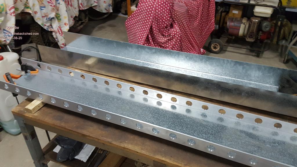

This is the cold duct set up with the floor inside and the cover behind it.
Figured it would be easier to set it up and drill and tap before it has all the tubes welded in  ...  which is fine for the floor  ...
...  but because there's a chance the angle will bow a little  ...  I'm still not game to drill the holes for the cover until it's been welded.
And my perch up on top of the bench where I'm gunna spend a few hours eventually  ...  long as I don't fall off.
I'm using the c-sections to help hold the tubes in place to keep the spacing correct  ...  but I've realised I need a better system.
I plan to get a couple lengths of timber  ...  drill holes through for the pipes  ...  rip the timbers down the centre  ...  then use them to clamp all the tubes together  ...
...  then leave that on each set of pipes until both assemblies are on the roof.
It should help hold them all in place and take a lot of strain off the welds when the assemblies are manhandled
Cheers,  Roger

Yesterday I took a video of my IR temp sensor as I walked from the front door right up to the fireplace.
Inside the front door the tiles were at 16.7 and by the end of the passage at the start of the kitchen, were 18.1.
Another 10 feet and up to 18.6  ...  then over the next 12 feet to the tile in front of the heater it steadily rose to 24 degrees.
The heater was still warm at the front being early morning and the remnants of the overnight fire inside  ...  but no question the tiles do start to feel warmer (less cold) as you come up the passage.
That still encourages me to use any excess heat to pump into/onto the floor during the day because it must have the same effect as the wood heater eventually. At the moment, the tiles are simply being heated by radiant heat from the fire at night  ...  for a few feet  ...  and the rest by the warmer room air.
I was on the computer inside all day today and by three oclock I was starting to feel really warm. Had to take off my cardigan  ...  and then a while later my socks.
I checked the temperature and it was up to 24 in the kitchen  ...  and at my measurement spot in the lounge it was 24.7. From the data logger, it remained flat at 24.7 for 40 minutes.
And that was after a slow start with very little output until after 11am due to cloud and grey skys  ...  though our overnight temps had been mild and we only went down to around 19 degrees.
