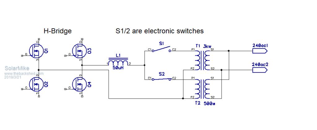

After Poida mentioned the inefficiency of running a big inverter all night I have been considering a couple of schemes for reducing Inverter idle power at night and possibly also during the day, mainly for saving energy capacity when there isnt much sun.
If the voltage could be turned down from say 240V to 220V when less than 500W is drawn for say 5? minutes does anyone have any feel for the idle power improvement? If a larger load is sensed we could just go back to full power for a while?
The second approach is a bit different, and a bit more complicated & involves a smaller say 1kW Inverter & Toroid. If the 2 inverters were coupled (summed) by solid state relays to the load but the 1kW output was set for 230V the larger for 240V then the smaller inverter would not commutate its output to the load.
The operation would be as follows, big inverter running, small inverter off. Big inverter sees less than 500W for time period and just before signing off, smaller inverter is enabled along with its solid state relay drive. Large inverter commanded to soft stop and small inverter automatically picks up load as larger inverter output falls, large inverter solid state relay turns off, now we're running on small inverter. Going back to full power is similar but in reverse
A nagging question is when a fridge starts or similar, does the big inverter need to start or could the smaller inverter handle the few cycles of a compressor start requirements? Any feeling for the battery capacity that might be saved with either of these schemes or is it all just a crazy idea ? Edited by wiseguy 2019-03-22
Cheers Mike

Posted: 04:20am 21 Mar 2019
I cannot see that working properly as drawn.
The 500w transformer is still driving the 3Kw transformer core (and its magnetising current). You would need to switch both primary and secondary of the larger transformer together.
Solar Mike
Joined: 08/02/2015
Posts: 1255
Posted: 04:38am 21 Mar 2019
  Warpspeed said   I cannot see that working properly as drawn.
Of course, scrub that idea then, with the unused transformer totally out of circuit there would have to be a soft start mechanism in any changeover or just prior to the changeover.
Mike

  Solar Mike said   Lowering standby current requires less mass of iron in the main transformer, perhaps achieved as per dia below, keep existing H-Bridge and parallel a low powered transformer, selected by a low resistance electronic mosfet switch. Because the output winding of both are always connected both transformers will be magnetized, so switching between them should be no problem ???
Mike
This is the scheme implemented by Victron in the 3000VA multiplus inverter
I had for 2 years (plus one month. Then it died.).
Instead of a large and small toroid, they used two 1/2 sized toroids of the same size.
When the load was sensed to require it, both toroids were switched in to service.
And when the load dropped enough, one was disabled.
Posted: 06:21am 21 Mar 2019
I still believe the best way to reduce no load current is by fabricating an inverter transformer yourself, that has a very low flux density, ideally at 1.0 Teslas or less.
I have a 4.5Kva inverter transformer that weighs 51Kg and has only 20 idling power watts.
The commercial inverters are just too cost sensitive to ever do that.
Anything else is fraught with problems and limitations.

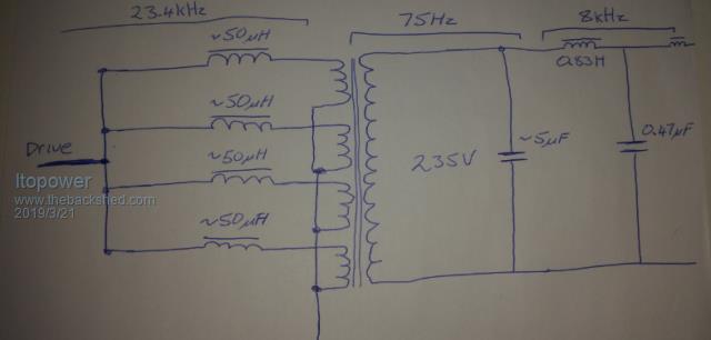

Thought I needed a picture to explain the inductor arrangement, does the transformer in this case not decouple the inductance from being parallel ?

Was your original design for a single choke 50uH ? If so the 4 chokes should be 200uH x 4 off ? I reckon they should share fine in that arrangement.
Cheers Mike
ltopower
Joined: 08/03/2019
Posts: 64
Posted: 12:33pm 21 Mar 2019
Original was for a single 50uH choke, but struggling to sort out something practical that could support well over 100A... closer to 200A... The stack of 5 x T400 are an option (one on the way to have a test, along with 6kg of 2mm copper...), would need 10 for 200A.
With 3mm gaps in the E70 chokes 47uH should get over 45A each.. but I'm not certain how much decoupling the transformer windings provide to the chokes. Still to test the actual turns for my transformer..
The E70 would need approx 24 turns (2 in hand 2mm, approx 45% window use, 30A) for 200uH and the per choke saturation dropps to around 22A, so only around 90A total.
I get the about the same amount of stuff, to a degree, as I was looking if decoupling or any isolation can happen. I would be better off putting all the E70 chokes in series with 6 turns or stacking them. (I'm learning Tony, honest !)
I have the E70's arriving Monday so they will be my starting point and should get me to the 5kVA level (5 pairs stacked) for 100A (95mJ each)... something does not seem right though. Will be performing quite a few tests next week if the other parts turn up.
With each chokes connecting to a separate isolated winding my thought was they would decouple.... at least to some degree ?
The use of a gapped steel core seems appealing (smaller), but I remember the earlier tests showing the resulting over and undershoot, unless a ferrite in series then filters the over under.. on that note, over, under, under, over and out... airplane for those left out on takeoff..

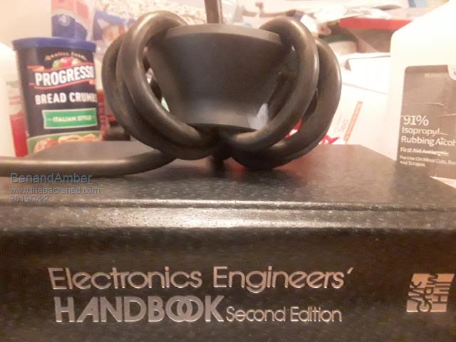

Posted: 07:25am 22 Mar 2019

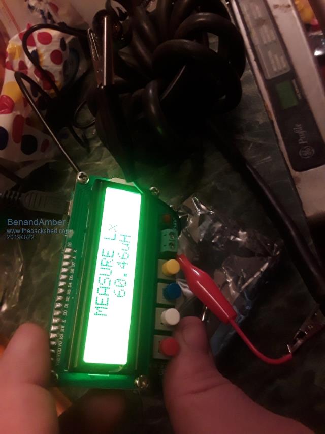

How about the ferrite material on the back of old television tubes it is quite big but a little bit odd shaped you could put two of these face to face and have a pretty big toroid shaped ferrite I am very poor so I have been trying everything
Edited by BenandAmber 2019-03-23

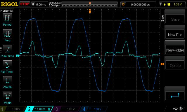

Part 29: Power factor
This will be looking at a few devices I connect to the output of the test inverter.
We will be looking at the AC current these devices draw, as well as the AC output voltage wave form.

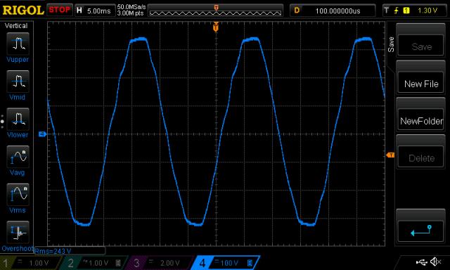

Lately, we have had some discussion about the poor waveform Mark is getting when he connects his large inverter type air con to the home power circuit supplied by
his home brew inverter.
here is the CRO display of his AC output voltage
He sees the perfect sine wave transform to some ugly 'orrible thing when the aircon runs at middle power levels.
I think I know what is going on.
A pure resistive AC load is a resistor, with no capacitance nor any inductance.
It is a constant resistance for the entire waveform.
The best pure resistive load is a hot water heater element.
It is a resistor. It has no inductance of significance, no capacitance of significance. It is a constant resistance.
Some loads we apply to the house AC supply are purely resistive, such as incandescent light bulbs, electric oven or cooktops (non inverter type!) and others.
When we examine the AC voltage waveform, we see a nice undistorted sine wave.
This as as we think it should be.
Always.
But we need to realise that a lot of loads are not purely resisitive.
Switch mode power supplies frequently are very uneven in their current draw, over a waveform. Same for inverter type microwaves (I guess) and the inverter powered AC brushless motor in my pool pump. I'm sure most household things like TV, computer, modem, printer, media centers, xbox etc. are to some degree uneven in the current draw over time.

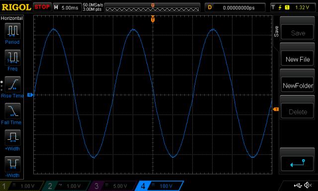

First let's see my unloaded AC output waveform of the test inverter.
This time, I am using the nanoverter drive board and Madness's power board.
DC supply is 56V
Dark Blue is AC voltage
Light Blue is AC current, measured at the output 240V wall socket on the bench.
Above is a nice clean sine wave. Unloaded too.

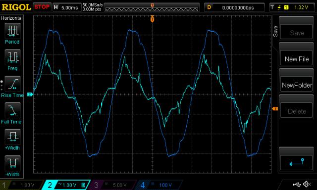

Next, we apply the load of my UPS that supplies power for the old iMac I use as a desktop computer. So this is the load of the UPS plus the iMac.
UPS is an APC Back-UPS RS 800, Imac is a 24" 2007 model.
Things to notice are:
The wave form of the current seems to lead a bit and has some sudden peaks here and there.
And the AC voltage is now distorted.
The deviations from sine wave seem to occur where there are large sudden peaks in AC current.
Hmmm...

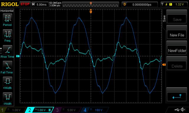

Now we see when I hook up the 60W macbook power supply to the inverter output, and have the macbook open and running.
Again we see peaks in current corresponding with deviations from pure sine wave shape. In this case, the current peaks occur at near max AC voltage, and this flattens the AC voltage to some extent.
Lastly, we see a old crappy Dell laptop and it's power supply.
Again, deviations from ideal AC waveform shape correspond to large changes in AC current.

Power factor is an electrical engineering area that attracts plenty of money and effort.
Mark has an issue with his inverter output AC voltage waveform when running the inverter type aircon of his. I think this is normal for this application and
can not be reduced much if at all, and I doubt there is any value in attempting to reduce the distortions anyway.
I suspect his aircon when operating such that it distorts the waveform is drawing large pulses of AC current, to power the high voltage DC bus of the inverter drive.
This pulse type characteristic is unavoidable and needs to be accommodated in our designs.
That is, ensure the home brew inverter can deliver these high current pulses indefinitely without self destruction.
I suggested to him to consider a large choke on the AC side, near the aircon supply takeoff point. It would need to be big, something like 100A at 240V AC RMS (325V Peak). This is a big choke. We both did not like that idea.
Maybe make a bigger, huge inverter, capable of massive current supply on the AC output? Yes, you will probably get a cleaner AC voltage waveform.
But why bother. Lots of expense and work too.
Anyway, I know the waveform of my home inverter is not real great and I accept that.
Lots of switch mode power supplies running 24/7.
Here is what it looks like right now:
It's been like this for years.
Edited by poida 2019-03-25

The load can not only change drastically at different parts of the ac cycle, it may bear no relationship to the voltage waveform.
We can have power (current) shuffling back and forth, one moment the inverter is trying to drive current into the load, at a different part of the ac cycle current is surging backwards into the inverter in the opposite direction. That can really murder our nice clean sine wave voltages shape.
Not only that, the voltage feedback may get terribly confused by the grossly distorted voltage waveforms.
Its a hugely complex problem, and there is no simple solution guaranteed to fix it in all circumstances. It really comes down to the inverter and load characteristics being incompatible.
Its also the one single issue that put me right off PWM inverters originally.
The stepped waveform approach has two very powerful advantages when driving really nasty loads.
The four inverters are completely bi-directional and with a continuous very low impedance back to the dc supply rail.
The four inverters output individual square wave voltages that either add or subtract to generate the final sine wave voltage. Power is shuffling back and forth continuously (by design) even with a simple purely resistive load.
If you hang a highly non linear or reactive load on the output, each individual inverter will go on quite happily generating clean square wave voltages, and sine wave currents, or chopped up sine wave currents flowing in either direction.
Its doing that anyway, and it will just do it all a bit differently to accommodate a really nasty load with minimal distortion of the voltage output waveform.
It does that because the transformers are switched at very low impedance direct onto the dc power supply, and provided the electrolytics on the dc side can hold a constant clean dc voltage with minimal ripple or spikes, the ac output waveform of the whole inverter will remain clean and with minimal voltage distortion.
A second advantage is that there is no voltage feedback to get confused by drastic waveform distortion. Not that there should be any drastic voltage waveform distortion anyway with a step inverter. But its one less problem to worry about.
Not saying its the absolute solution to all possible problems, but its a LOT more robust than PWM where the loads are really awful.
