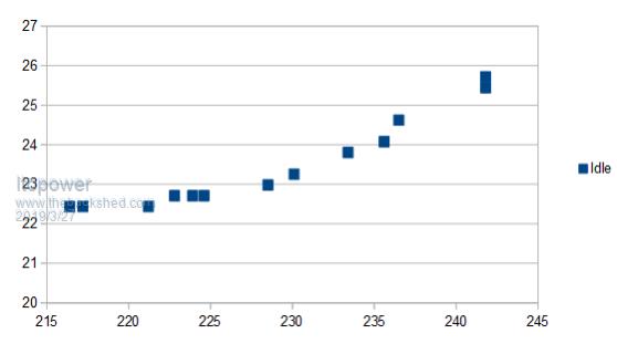

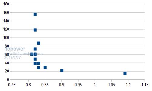

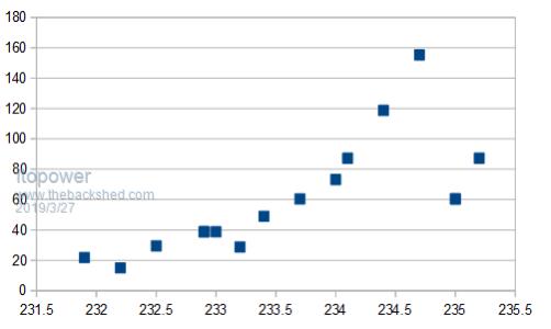

Another set of really interesting charts...
In the original W7 modification Andrew added a 820mH choke on the output with a smaller cap as an 8kHz filter to block any connected loads feeding back changes to the resonances within the inverter. This should also help smooth out some of the distortions.
High "Crest Factor" load is shown really nicely for the Mac Book power supply... UPS units define the crest factor capability in the specifications, typically they can handle around 3.
The UPS profile looks like a harmonic is causing the spikes with the spacing ? As I understand the smaller UPS units they are typically HF, which should not cause spikes like what you are seeing in the charts.
Would be really interesting to see the UPS connected up with an inline LC for 8kHz in place (820mH and 0.47uF)...

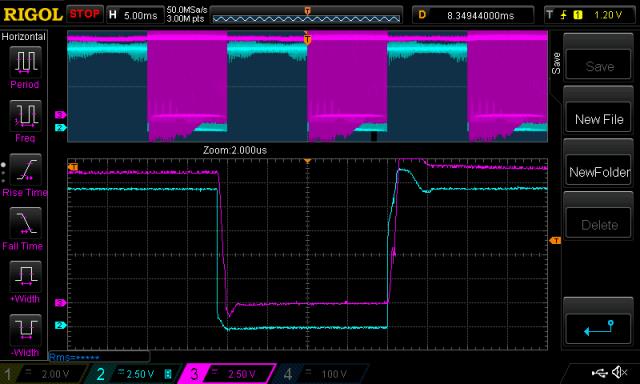

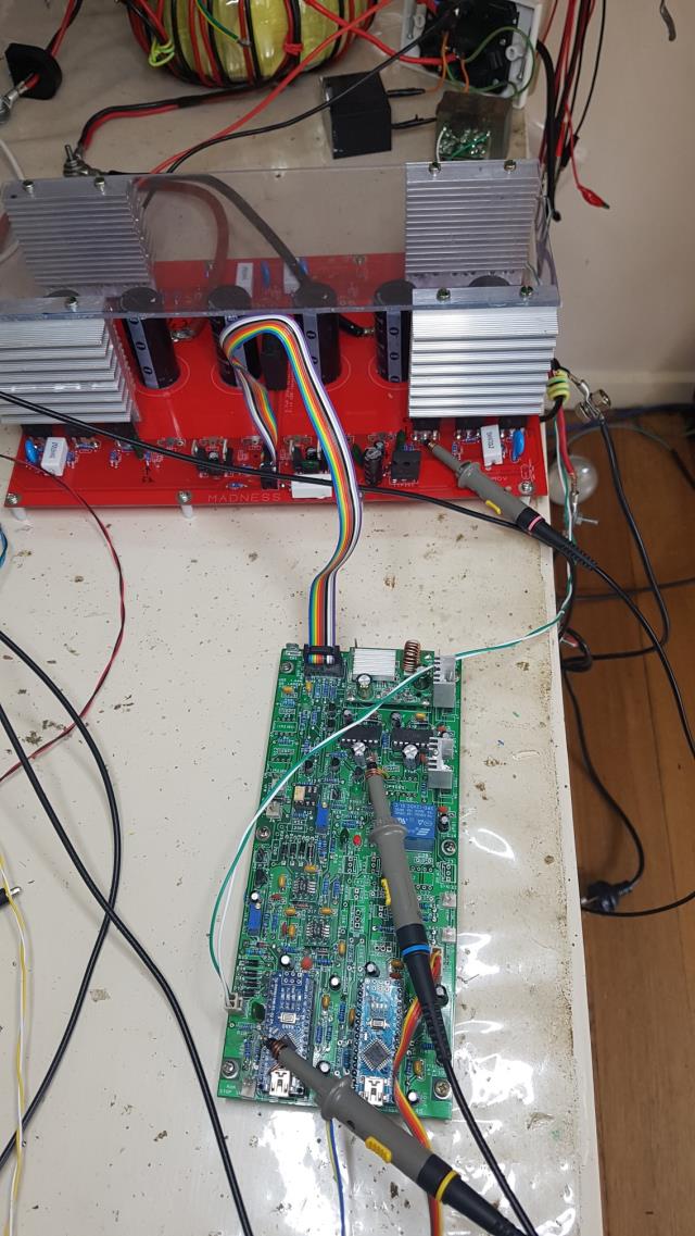

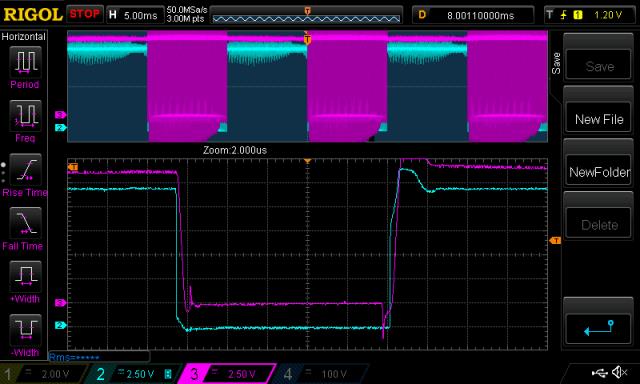

Part 30: MOSFET gate voltages with Madness's power board
Now the nanoverter is running well, I have found it useful for looking at
potential causes of failure with our inverters.
This time I am looking at the dv/dt induced voltage changes at MOSFET gate pins
and the voltages seen at the IR21844 gate drive IC outputs.
I have been very wary of negative voltages appearing on the drive IC outputs.
I suspect these -ve voltages have resulted in inverter failures.
I have no proof, mind, but IR specify Absolute maximum rating for Vlo
as from -0.3V to (Vcc+0.3V).
I have seen Vlo voltages much less than -0.3V in other inverters I tested on the bench.
This has lead me to use and recommend 15V TVS diodes across Vlo to ground and
Vho to Vs (high side gate drive and VS).
Now the Madness power board is built, let's see what voltages appear on the gate drive outputs, now they only need to drive the two transistor base pins, thanks to Madness choosing a on-board totem pole gate drive design.
(yet more DSO screens follow)
Light Blue is IR21844 gate drive output, sampled very close to the IC pins.
Pink is MOSFET gate voltage
Firstly, no load condition.
Close to the beginning of a 1/2 wave:
Notice the MOSFET gate exhibits large voltage spikes due to dv/dt (i.e. fast voltage changes at VS)
These spikes do not find their way back to the gate drive IC outputs.
Nice.
Now at the other end of the 1/2 wave:
Again, the negative pulse was not seen at the gate drive IC.
Something else to see, there is indication of oscillation when the low side MOSFETS switch ON, to pull VS to ground. This oscillation is also not present on the gate drive IC outputs.

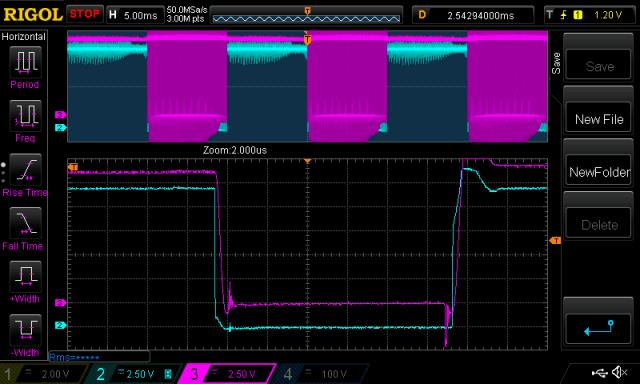

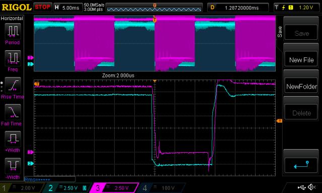

Now, with 150W load, we see near the start:
A lot more changes on the gate voltage at the MOSFET.
Look at the huge negative spike just before MOSFET switch ON.
That was completely insulated from the drive IC pin. None of it got through.
We can see more energetic oscillations now, with a bit of load on the bridge.
And near the end of the half wave, under load:
pretty much the same.
I have to conclude that totem-pole MOSFET drive has shown the best, least potentially destructive gate drive voltages on the IR21844 drive chips.
This seems to me to be the way to go in power board design.

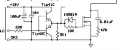

Totem-pole drive:
This is a small clip of Tinker's schematic.
The gate drive IC output is fed into the bases of the two transistors via the 22R resistor. If the current is high enough, one transistor will conduct. If the current is low enough, the other transistor will keep conducting. Both won't be conducting for very long. Voltages appearing on their emitters and collectors won't get back to their base pins, as we have seen in the above DSO traces.
this is how the testing was done:
Looking at the traces again, I see the gate drive IC outputs exceeding 15V, maybe getting to 16.5V. This is not good, I know the IC's have a supply of 15V.
The specs say no more than DC supply + 0.3V
I think we need the TVS or 15V zener diodes after all!
I will put them across the point where the two transistor bases join, and to ground or VS where appropriate. Edited by poida 2019-03-26

E70 ferrites arrived and have been trying out the odd one or two combinations... 24 actually..
Most interesting one is uH vs idle current. This is uH overall for 4 inductors, one per winding. The board was fed 50V and is coupled up to a 29V to 240V transformer, 6kVA, 25kg.
This is not the whole story though, because there is some ripple left over in the output waveform, which impacts the rms value...
So, for reducing idle power, there is a very clear knee point, however adding more inductance just decreases output ripple. The knee point is lower than I expected, around 25uH....
My setup is a bit convoluted as I am powering the inverter board via a 1000W boost converter via a 30V/10A power supply.... quite fortunate as I found out the hard way (without smoke, flashes and a replacement) that I can shut the unit down trying to measure the AC out by grounding one side with the scope lead...
Shutdown of the unit with the large toroidal unit is no problem (at least with the small power supply !) but they have added a separate jumper onto the board at the top side of C24 (opposite pins) rather than removing the opamp..
ltopower
Joined: 08/03/2019
Posts: 64
Posted: 10:14pm 26 Mar 2019
Forgot to remove the two outliers from the second chart, I had re-tested the turns and output again... so the result is a relatively smooth series.
ltopower
Joined: 08/03/2019
Posts: 64
Posted: 10:28pm 26 Mar 2019
Last chart, Idle wattage vs transformer output voltage...
Not much to gain going lower than 230V... 240V in the transformer is around 1.42T.

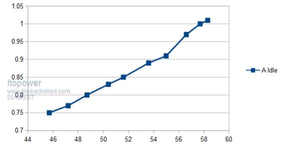

Another chart.... this one is input supply voltage vs Idle amps
ltopower
Joined: 08/03/2019
Posts: 64
Posted: 11:02pm 26 Mar 2019
The Idle amps is at 30V... and about 10%-15% loss needs to be factored in (subtracted) due to the boost converter. This is the amp measurement from the 30V bench power supply unit.
