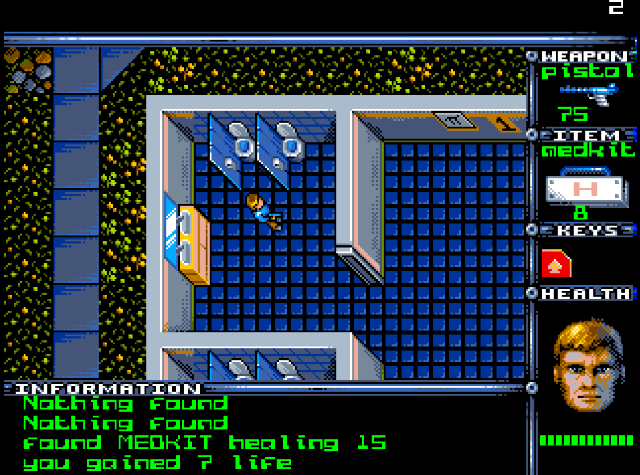

Bug in the game logic (which I'm leaving alone):
If you walk into the trash compactor then you get lots of "object crushed" (which I think should start with a capital letter) messages instead of a single "Player terminated!" message, which again I think should start with a capital letter, and in this case end with an exclamation mark.
Posts: 6187
Posted: 05:56pm 09 Dec 2023
Hi Tom,
Real good feedback. It is fixed in "robots_rc1.bas" see new thread.
The "Player terminated" was printed but invisible since there where multiple "object crushed" after it.
The "object crushed" was a bug.
Thanks,
