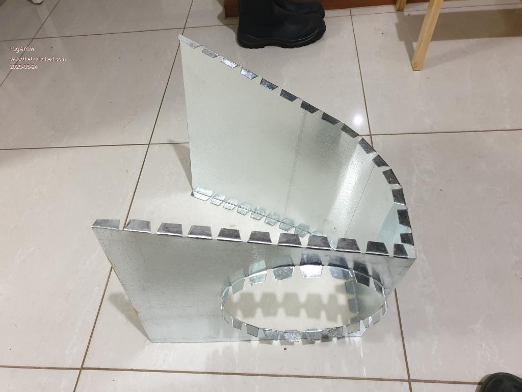

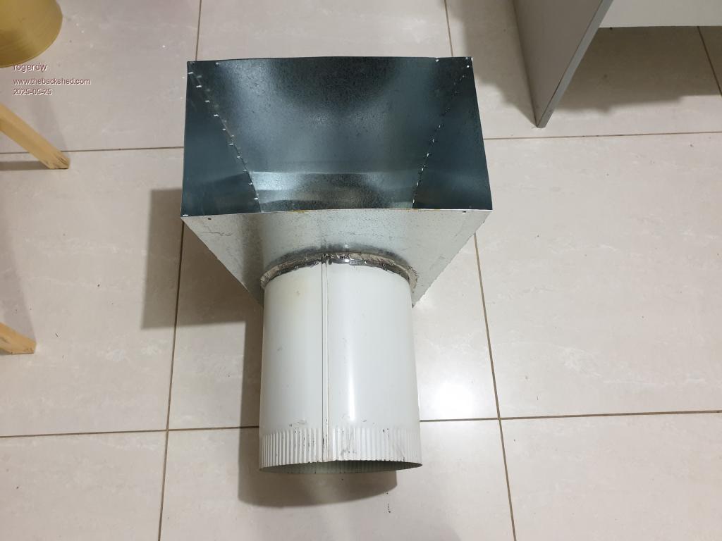

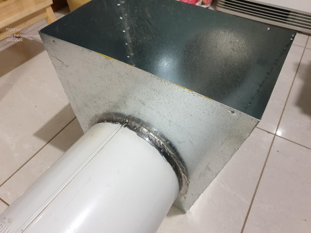

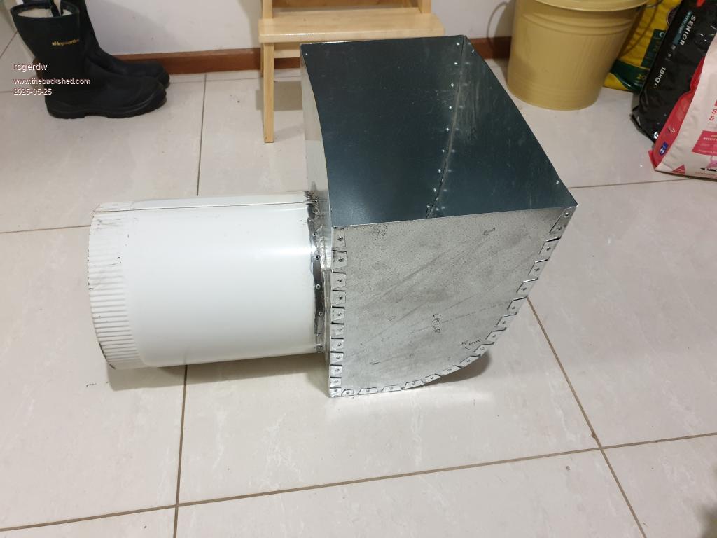

I cleared some space in the leanto shed and scored some free reject carpet to work on  ...  and dragged it over to work on it.
The c-section that the tubes plug into, needed some way to have an airtight seal. I decided to fill it with expanding foam, using plugs to create clearance for the tubes once it set  ...  but that didn't work.
Once I saw how easy it was to work with after it set, I just filled the complete c-section  ...  and after it set, used a holesaw to drill out each hole. That worked extremely well and the glass tubes have a nice tight interference fit over a couple inches. That also centralises the tube and keeps it away from the steel.
While you can see pictures of the complete unit in previous pages, it was only a dry run assembly and I had to pull it all apart so I could seal it up air tight and water tight.
I also spent some time on the roof checking exactly how it would fit  ...  and discovered that if it was 200mm longer, I could just reach another two rafters. That would give me 8 mounting points at the top and 8 at the bottom, rather than just 6 top and bottom. So I welded an extension on each corner. I had been adding up individual weights and saw it would be close to 300kg when it is finished  ...  so the more supports the better.
I will get a roofing expert to check things out to see what roofing timbers might need extra struts.
I've drilled and tapped the steelwork to fit the outer manifold  ...  and mounted the tubes for one side. The next step is fitting the tubes for the remaining side.
You can see I have some foilboard insulation on the base and have also added that to the inside of the outer manifold to keep as much of the heat as I can. There are two layers, one 20mm and one 25mm thick  ...  which keeps the inner manifold at the right height and makes the tubes exit in the centre of their holes.
It is manufactured from a fire retardant foam (FR-EPS) with aluminum foil directly laminated to both sides.
The 45mm thick foam inside the outer cover sides, rests on the top of the c-section, so the weight also helps seal the manifold and keep the heat in.

Posted: 09:33am 24 May 2025
I've never done sheet metal work before so this is probably all wrong  ...  but it looks like it's going to work.
This is the hot air outlet and will sit inside another larger shroud with the gap filled with fire proof expanding foam, to retain as much heat as possible.
Then need to make the cold inlet manifold. Same size duct inlet (250mm) but smaller rectangular outlet.
Cheers,  Roger

Posted: 12:27pm 25 May 2025
I made some more progress today. Even used some of the reclaimed solder I posted about in the other thread.
I've riveted everything and just soldered the duct joint. The rest I'm gonna cheat and use roof and gutter silicone.
Cheers,  Roger
